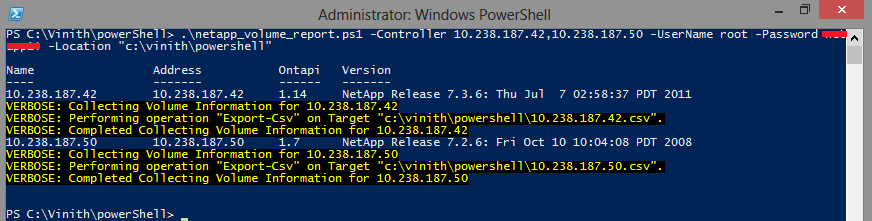

Example :-
.\netapp_volume_report.ps1 -Controller 10.238.187.42,10.238.187.50 -UserName root -Password auskit! -Location "c:\vinith\powershell"
Attached you can the sample csv files generated and also the script.
