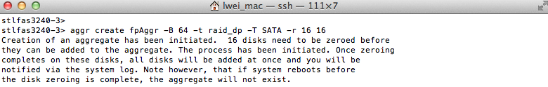

     1. Create a 64-bit aggregate using either SATA or SAS hard drives as usual (see Figure 1)
          Figure 1. Create a 64-bit aggregate with SATA drives.

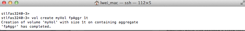

It is pretty straight forward. To use a Flash Pool, you create FlexVol volumes and LUNs within it, just as you would do with a normal Data ONTAP aggregate. Figure 4 below shows the example of how to create a FlexVol volume using the Flash Pool fpAggr.
     Figure 4. Create a FlexVol volume using the Flash Pool fpAggr.
