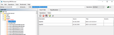

Sending UM OID ocumAlertTest from a RHEL server with net-snmp-utils installed:
[root@dawnr-um ~]# snmptrap -c public -v2c 10.216.25.47 trapoid .1.3.6.1.4.1.789.5.1.0.11111
Received:
For the OVA and Linux deployments, you can try using 'nc' with the UDP switch.
