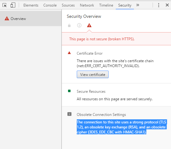

I think is related to wfa broken https communication, I can see with Chrome in Security Overview when connected though https interface
Obsolete Connection Settings
The connection to this site uses a strong protocol (TLS 1.2), an obsolete key exchange (RSA), and an obsolete cipher (3DES_EDE_CBC with HMAC-SHA1).
Is there a way to change the cipher and key exchange on WFA server side.

I do my connection via TLS1_2
Broken https  is not relayed to SSLv3, but weak tls cipher, find  the supported ciphers  (all are obsolete)

there are actually obsolete regarding Chrome security tab
