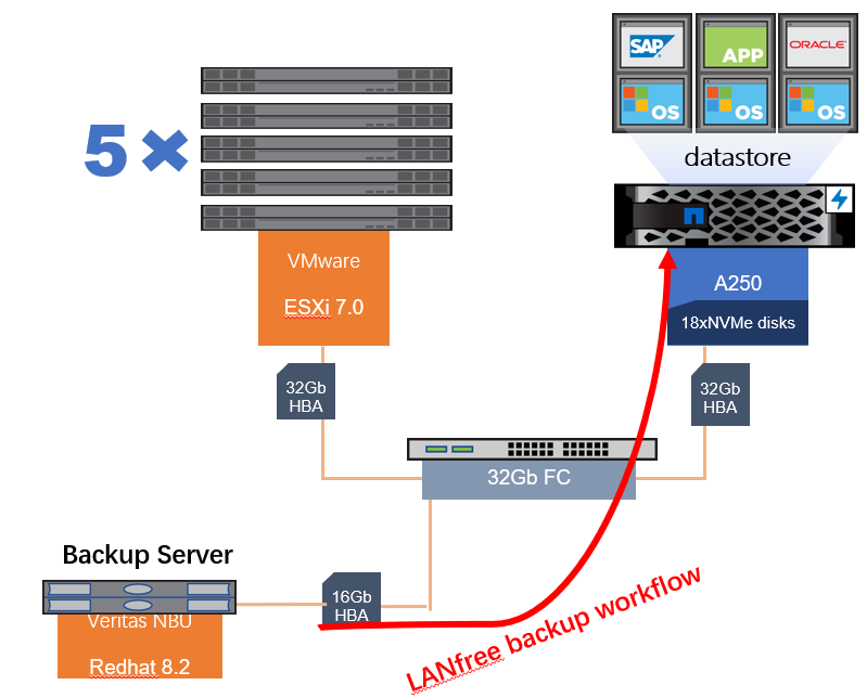

Here is one issue from my customer who using the NVMe/ FC with LANfree backup requirement:
Environment info:
Storage system : NetApp A250
ONTAP version: 9.10.1
Storage  Protocol: NVMe over FC
Five VMware ESxi host: vSphere 7.0
One Redhat Linux version  8.2 (4.18.0-193.el8.x86_64 ) with Veritas NBU Backup Server with Emulex LPe31002 HBA, driver: 12.8.x.x
Topology:
Issue:
All of the ESXi host can  read/write the nvme datastore except the Linux backup server .
Does ONTAP support mapping single nvme namespace to different OS platform (VMware and Redhat) ?
or
How to achieve  LANfree backup on NVMe/FC protocol with  VMware ESXi cluster  and Linux Backup Server ?

Yes Namespace can be shared across 2 different Host OS but the host nqn must be part of the same subsystem. say ,  Subsystem-1 can have nqn-1 of host os 1 and nqn-2 of host os-2 , NameSpace-1 mapped to Subsystem-1. And Namespace-1 can be seen on both the host os.
Now can constituent of the subsystem can be nqn of 2 different host os flavour ?
There isn't any explicit mention in the spec that subsystem must always constitute nqn from the same host operating system.
And when it comes to NetApp , when a subsystem is created , host os of the constituent host nqn (part of subsystem) must be specified
example,
vserver nvme subsystem create -vserver netapp_vserver -subsystem ss -ostype  [ linux vmware windows ]
