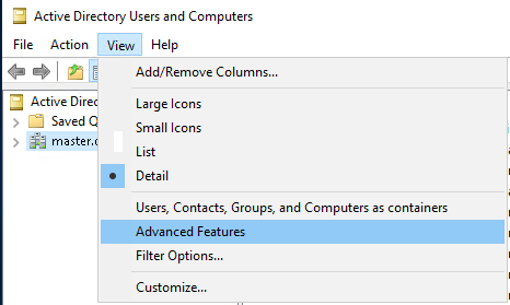

To ensure the use of consistent user and group IDs, attributes of Windows AD users and groups must be set. These attributes can only be set if "Advanced Features" are enabled. Enable "Advanced Features" as shown in the screenshot below.
Activate “Advanced Features” by clicking on “View” --> “Advanced Features”Activate “Advanced Features” by clicking on “View” --> “Advanced Features”

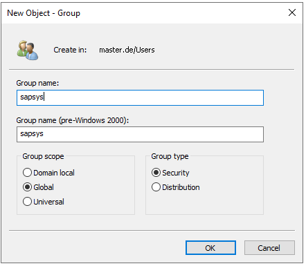

Add AD Group “sapsys”
Now we are creating the group "sapsys" in Active Directory.
Create group “sapsys”Create group “sapsys”

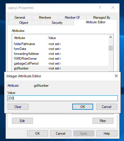

Next, we select the group “sapsys”, then right-click on "Properties" and then on "Attribute Editor" within the "Properties".
In the "Attribute Editor", we assign the group ID to the "gidNumber" attribute, which the "sapsys" group should receive on all Linux servers and the ONTAP SVMs. In our example, the group receives the group ID “233”.
Add/Edit the attribute “gidNumber”Add/Edit the attribute “gidNumber”

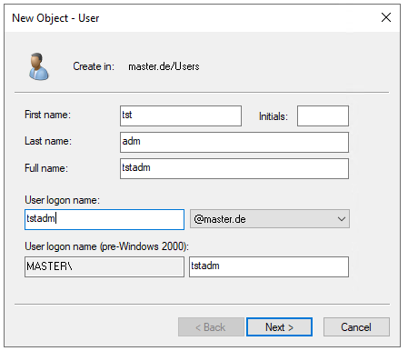

For illustration purposes, we will create a sample user with the username "tstadm" in our example Windows Domain having the Domain Name “MASTER”.
Creation of user “tstadm”Creation of user “tstadm”

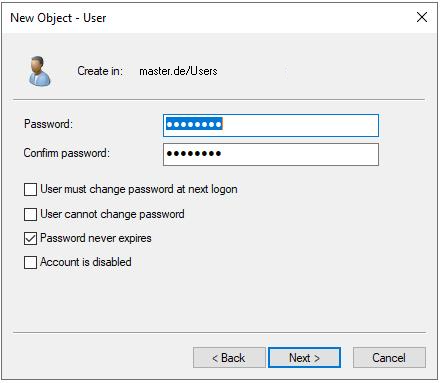

Enter a password according to your password guidelines.
Password of user “tstadm”Password of user “tstadm”

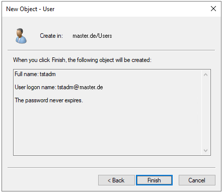

Press “Finish” to create user “tstadm”
Summary of user “tstadm”Summary of user “tstadm”

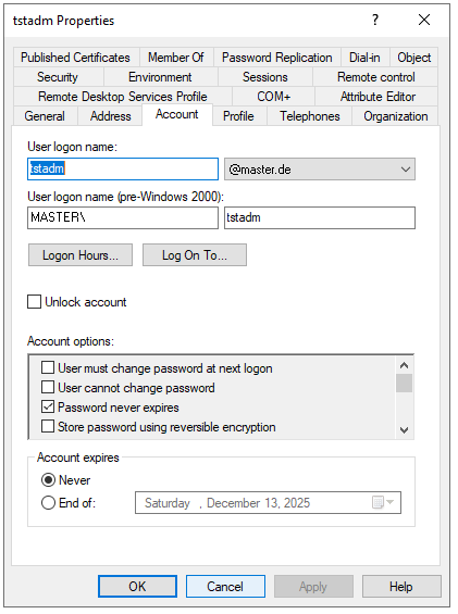

Next, we select the user “tstadm”, then right-click on "Properties”
Details of user “tstadm”Details of user “tstadm”

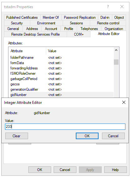

First, we assign the same group ID to the user "tstadm" that we assigned to the group "sapsys", since "sapsys" is the primary group of SAP system administration users. Therefore go to the attribute “gidNumber” and assign it the value “233”.
Assignment of group ID “233” to user “tstadm”Assignment of group ID “233” to user “tstadm”

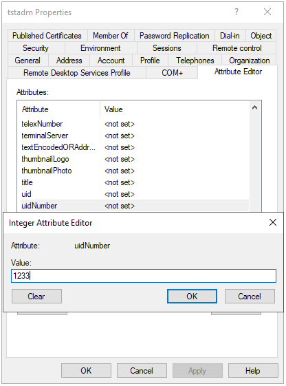

Then we assign a unique user ID to the user "tstadm". In our example the user “tstadm” gets the user ID “1233” to the attribute file “uidNumber”. Make sure that you do not have duplicated user IDs across your landscape.
Assignment of user ID “1233” to user “tstadm”Assignment of user ID “1233” to user “tstadm”

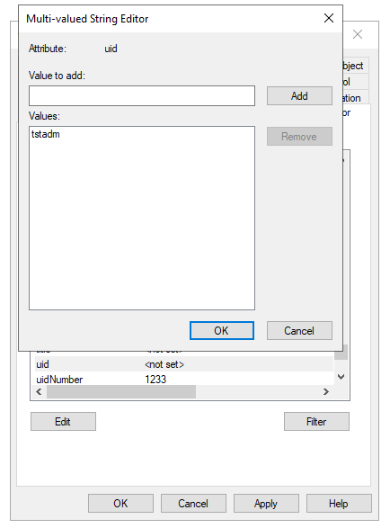

Next, we configure the "uid" attribute by assigning the user's username to it. In our example, the username is "tstadm".
Setting the "uid" field to "tstadm"Setting the "uid" field to "tstadm"

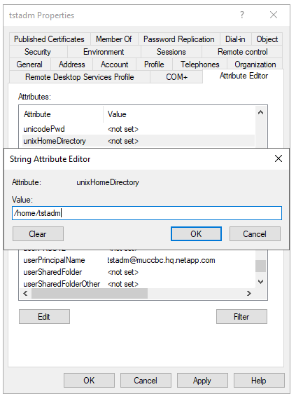

We need to configure the user's home directory. If the home directory does not exist on the Linux server, it will be created the first time the user logs in (this also includes a “switch user” (su)). The user "tstadm" is assigned the default home directory "/home/tstadm".
Assign “/home/tstadm” as Linux home directory to “tstadm”Assign “/home/tstadm” as Linux home directory to “tstadm”

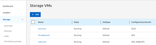

The following picture shows the already existing SVMs.
Existing SVMs in our ONTAP ClusterExisting SVMs in our ONTAP Cluster

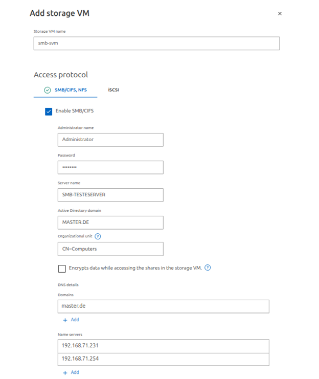

By clicking the "+ Add" button, we create a new SVM that supports both the CIFS and NFS protocols. The SVM is named "smb-svm". Next, the Microsoft Active Directory settings are configured so that the SVM can be added to Microsoft Active Directory directly upon creation.
The following fields must be completed:
  • Administrator Name
    A user with the necessary permissions to add a computer to Microsoft Active Directory
  • Password
    The user's password
  • Server Name
    The name under which the SVM will be created in Active Directory. This name must be resolvable in DNS with the SVM's IP address.
  • Active Directory domain
  • Organizational Unit
    The folder/group in Microsoft Active Directory in which the SVM will be created
  • Domains
    DNS Search Domain
  • Name Servers
    DNS Server
SVM CIFS configurationSVM CIFS configuration

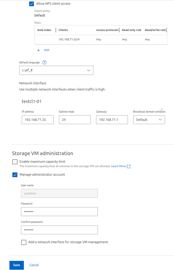

Next, access is enabled via the NFS protocol. To access the SVM via NFS protocol, we configure an export policy which specifies an IP address or range of IP addresses which are allowed to mount existing volumes from the SVM. Then we set the default language and the IP address for accessing the SVM is configured. We also enabled administrative access to the SVM using the user "vsadmin" using a password we are specifying. Enabling administrative access has nothing to do with the configured Microsoft Active Directory users and groups. Administrative access is i.e. needed when changing settings inside the SVM, adding the SVM to an existing SnapCenter backup environment or doing some other SVM configuration or tasks.
SVM network, NFS and administrative settingsSVM network, NFS and administrative settings
The following picture shows the SVM details
SVM detailsSVM details

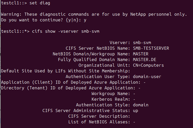

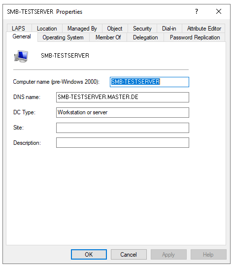

Now we are checking whether the SVM has been added into the Microsoft Active Directory. Let us first check it on SVM level.
Verification of added SVM into Microsoft Active DirectoryVerification of added SVM into Microsoft Active Directory

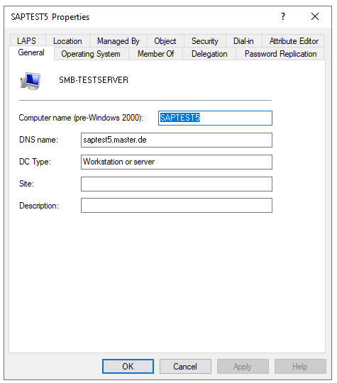

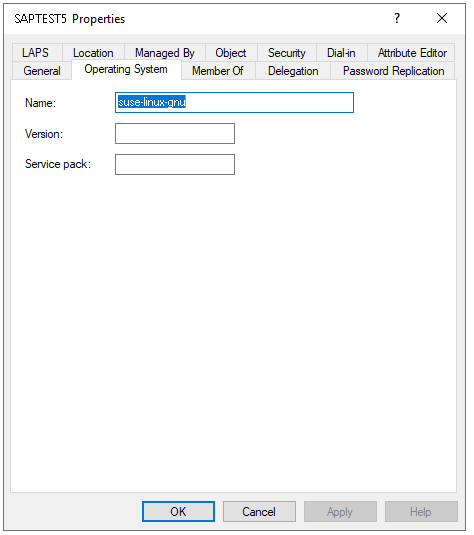

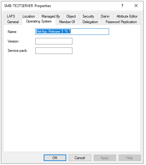

Afterwards check the added “Computer” inside Microsoft Active Directory
SMB-TESTERVER properties inside Microsoft Active DirectorySMB-TESTERVER properties inside Microsoft Active Directory
Microsoft Active Directory also displays the NetApp ONTAP Release details of the release the SVM has been added into Microsoft Active Directory.
NetApp ONTAP release 9.16.1NetApp ONTAP release 9.16.1

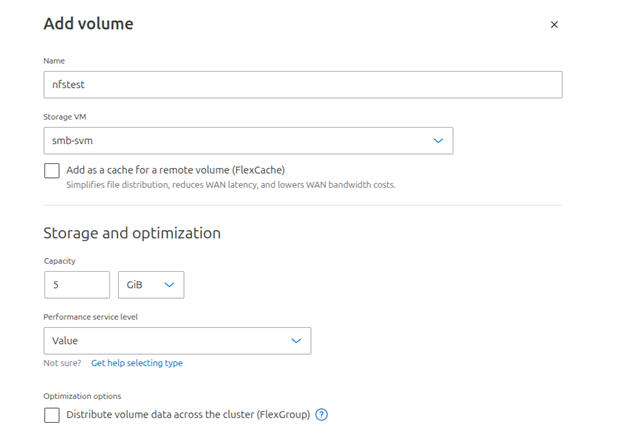

Create Volume
After creating the SVM, we need to create a volume that can be mounted on a Linux server using the NFSv4.1 protocol. We also do this in the graphical interface. The volume is named "nfstest" within the SVM "smb.svm" and has a size of 5 GB (which is sufficient for testing purposes).
Create new volume, which can be mounted using the NFSv4.1 protocolCreate new volume, which can be mounted using the NFSv4.1 protocol

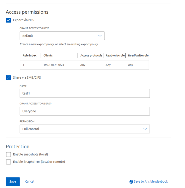

We configure NFSv4.1 access to the volume with the "default" export policy, which allows all computers on the 192.168.71.0/24 subnet to mount the volume. To also mount the volume on Windows machines, we share it via the CIFS protocol – this can be useful, for example, for exchanging files between Linux and Windows systems. Clicking "Save" creates the volume.
Create Volume and share it via NFS and CIFS protocol.Create Volume and share it via NFS and CIFS protocol.

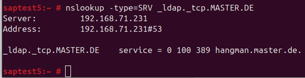

First, we check the DNS settings and whether the LDAP service "MASTER.DE" can be resolved correctly in the DNS.
DNS test for LDAP service “MASTER.DE”DNS test for LDAP service “MASTER.DE”

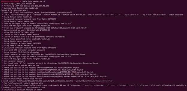

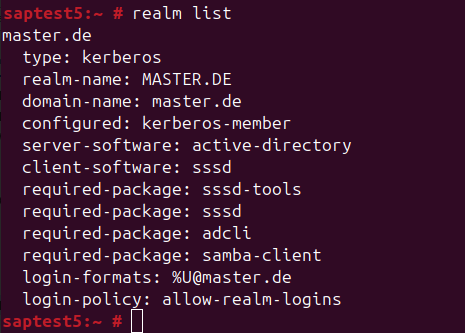

Now, the Linux server is added to the Microsoft Active Directory using the command "realm join master.de -v" (-v = verbose for more detailed output), as shown in the following image.
Add Linux server into Microsoft Active DirectoryAdd Linux server into Microsoft Active Directory
We check whether adding the server into Microsoft Active Directory was successful, as shown in the following image, by calling "realm list".
Server has been added into Microsoft Active DirectoryServer has been added into Microsoft Active Directory

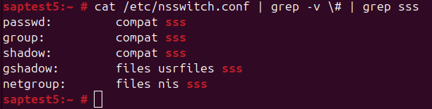

Then we check the file /etc/nsswitch.conf to see if users and groups should be resolved via SSSD in Microsoft Active Directory.
Correct configuration of file /etc/nsswitch.confCorrect configuration of file /etc/nsswitch.conf
This is how the Linux server appears in Microsoft Active Directory
Appearance of the Linux server inside Microsoft Active DirectoryAppearance of the Linux server inside Microsoft Active Directory
The operating system displayed is “suse-linux-gnu”.
More details of the Linux server inside Microsoft Active DirectoryMore details of the Linux server inside Microsoft Active Directory

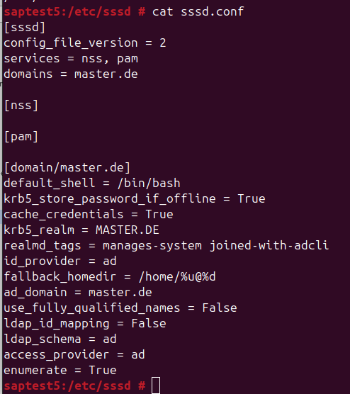

Now the file etc/sssd/sssd.conf needs to be adjusted. Domain-specific settings are highlighted in red.
[sssd]
config_file_version = 2
services = nss, pam
domains = master.de
[nss]
[pam]
[domain/master.de]
default_shell = /bin/bash
krb5_store_password_if_offline = True
cache_credentials = True
krb5_realm = MASTER.DE
realmd_tags = manages-system joined-with-adcli
id_provider = ad
fallback_homedir = /home/%u@%d
ad_domain = master.de
use_fully_qualified_names = False
ldap_id_mapping = False
ldap_schema = ad
access_provider = ad
enumerate = True
File /etc/sssd.confFile /etc/sssd.conf
Important:
  • use_fully_qualified_names = False
  • ldap_id_mapping = False
  • cache_credentials = True
  • enumerate = True

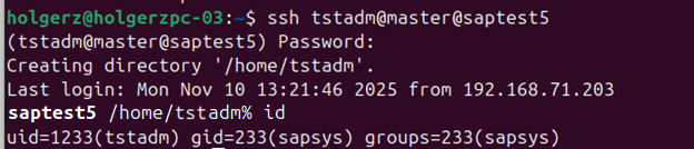

Log into the Linux Server as user “tstadm”
The following image shows the login of the user "tstadm" to the server "saptest5" and how the home directory is created during the initial login. We verify the user and group IDs configured in Microsoft Active Directory by calling the command "id".
UID and GID settings of user “tstadm”UID and GID settings of user “tstadm”

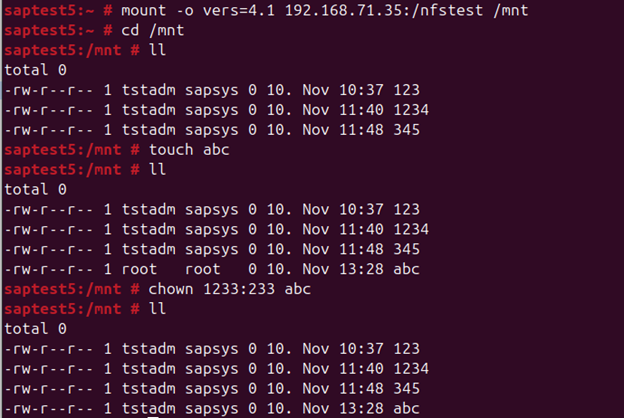

Mount NFS volume from SVM using NFSv4.1

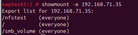

Now we'll display the available NFS volumes of the SVM "smb-svm" using the command "showmount -e". We also see the volume "nfstest" that we created. Instead of the SVM's IP address, its name "SMB-TESTSERVER" can of course also be used.
Available NFS Volumes on SVM “smb-svm”Available NFS Volumes on SVM “smb-svm”
Next, we mount the volume "nfstest" via NFSv4.1 into the directory /mnt using the command "mount -o vers=4.1 192.168.71.35/nfstest /mnt"
We check if the existing files belong to the user "tstadm" and the group "sapsys". Then, as the user "root", we create another file named "abc", change the ownership to "tstadm:sapsys" using the numerical UID and GID, and finally check the result.
Successful results of final testsSuccessful results of final tests
Everything is working as expected. Central user management for the Linux server and the SVM is set up, and the volume is prepared for a potential SAP installation.
