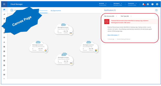

Canvas Page
Notifications have been included on the Canvas Page which notifies that a potential ransomware attack has been identified on a backup copy of a specific volume related to a specific Working Environment.
Notifications have been included on the Canvas Page which notifies that a potential ransomware attack has been identified on a backup copy during the restore of a specific volume related to a specific Working Environment. It will also highlight that Cloud Backup reverted to the last good known version of the backup copy.

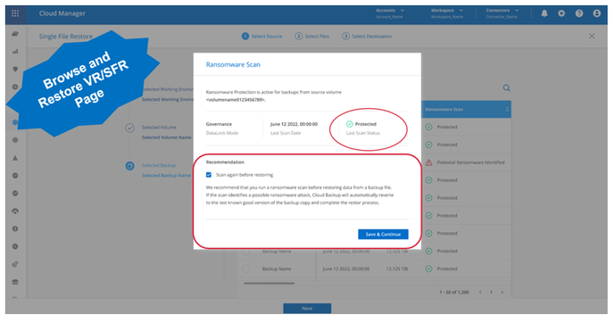

Browse and Restore Pages
A new “Ransomware Scan ” column has been introduced on the Selected Backup Details Page. It displays the different status of the Ransomware scans on the backup level like potential ransomware identified, tool-tip showing the last scan time, ransomware scan failure with scan time, and successful ransomware scan with the scan time.
Browse and Restore Pages – Restore Message
A “Ransomware Scan” UI will be shown upon selecting a snapshot to restore the backup. This restore confirmation message shows the details of the DataLock mode, and last run scan time information and also includes a recommendation to run a ransomware scan before proceeding with the scan. This is an optional scan, the user can uncheck to skip the ransomware scan.

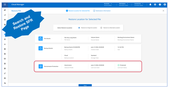

Search and Restore Page
More details about the ransomware scan have been provided on the “Backup Details” right navigation pane UI. It displays the different status of the ransomware scans on the backup level like potential ransomware identified, tool-tip showing the last scan time, ransomware scan failure with scan time, and successful ransomware scan with the scan time
Search and Restore Page- Restore UI
The “Restore Location for Selected File” UI under the Search and Restore feature, also now display the information of the backup DataLock Mode and the status of the ransomware scan run.
Clicking the “Next” button will bring up a “Ransomware Scan” UI, which displays the “DataLock” mode, the previous scan time, and the result of the ransomware scan. It also shows a recommendation to run a ransomware scan before proceeding with the restore process. This is an optional scan, the user can uncheck to skip the ransomware scan.
