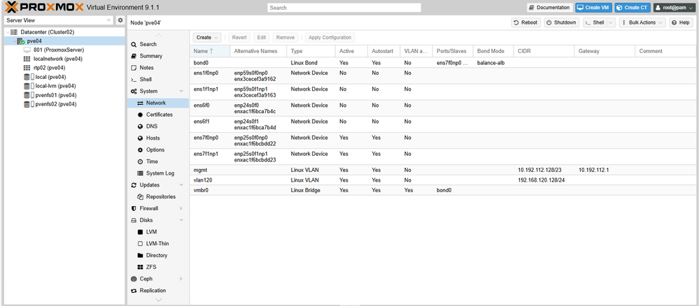

If management IP is accessible, using https UI at port 8006, under System -> Network, the configuration can be defined and it updates /etc/network/interface which can also be manually edited if UI is not accessible. So, typically you define the Bond interface, bridge, VLAN ports with IP address. VMs can connect to the bridge or define VLAN ID on the bridge.

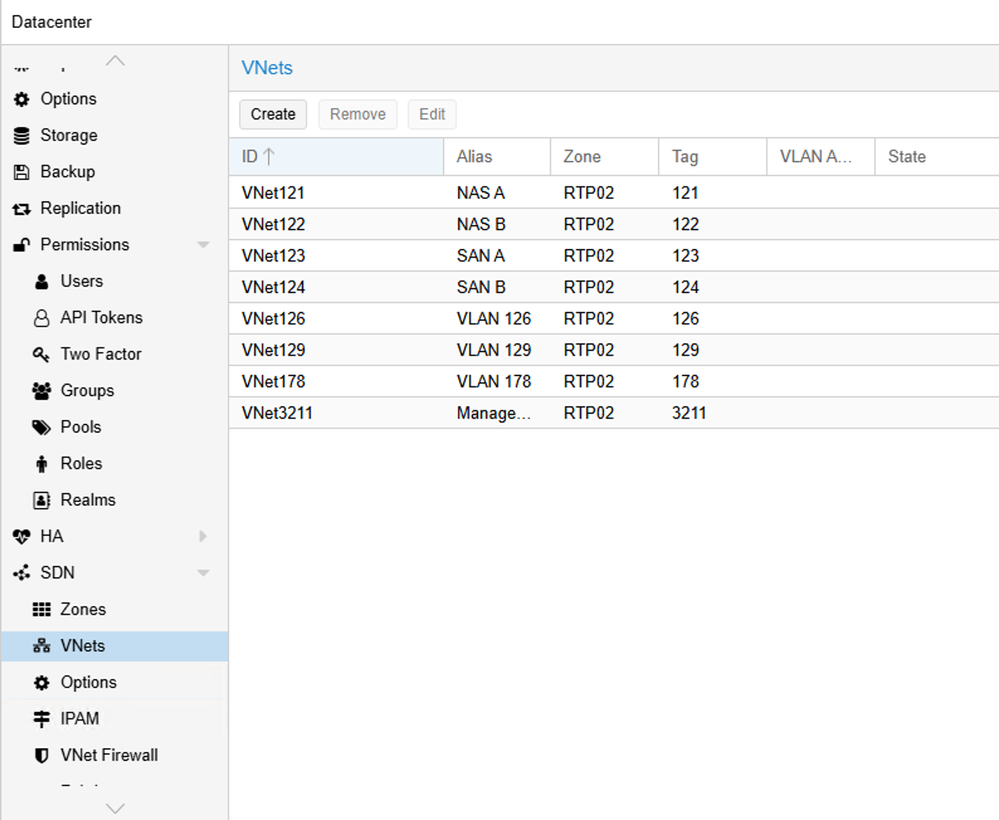

VM networks (VNet) can be defined using SDN at Cluster level. Zone defines the target hosts that participate in SDN and type of the SDN network. The Zone types are Simple ( Source NAT to Host network), VLAN (802.1Q which depends on external switch support), QinQ (802.1ad - Private/Stacked VLANs), VXLAN (Layer 2 over Layer 3 - VM Internal Networks) and EVPN (Layer 3 Multi-Cluster network). VNets defined with SDN are stored at /etc/pve/sdn/vnets.cfg and /etc/network/interfaces.d/.
In Linux, the VLAN interface can be defined as <interface>.<vlan id> or using the keyword vlan-id for the interface.

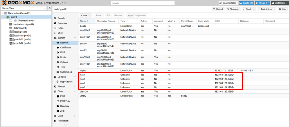

Issue is, it display the type as Unknown on UI.

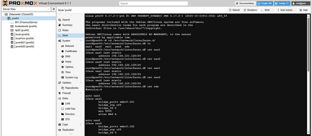

Second option tried was defining host specific IP address under /etc/network/interfaces.d on each host.
In this case, the host interface info doesn't show up on UI.
It works perfectly but because of above concerns, switched to OpenvSwitch.

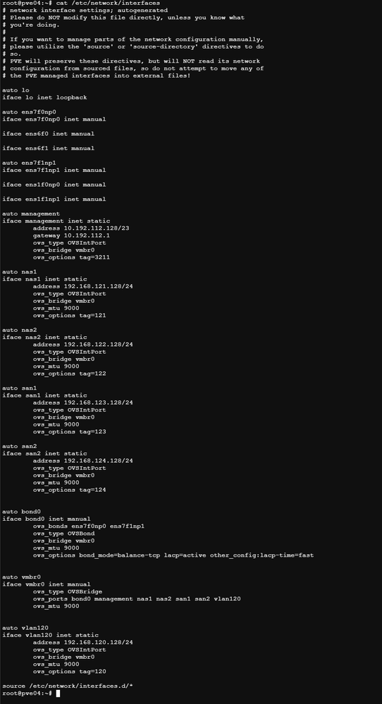

Installed OpenvSwitch package (apt install openvswitch-switch) on all hosts. I was able to use the UI and complete the configuration. Note: OpenvSwitch uses "_" compared to "-" in Linux Bridge configuration.
