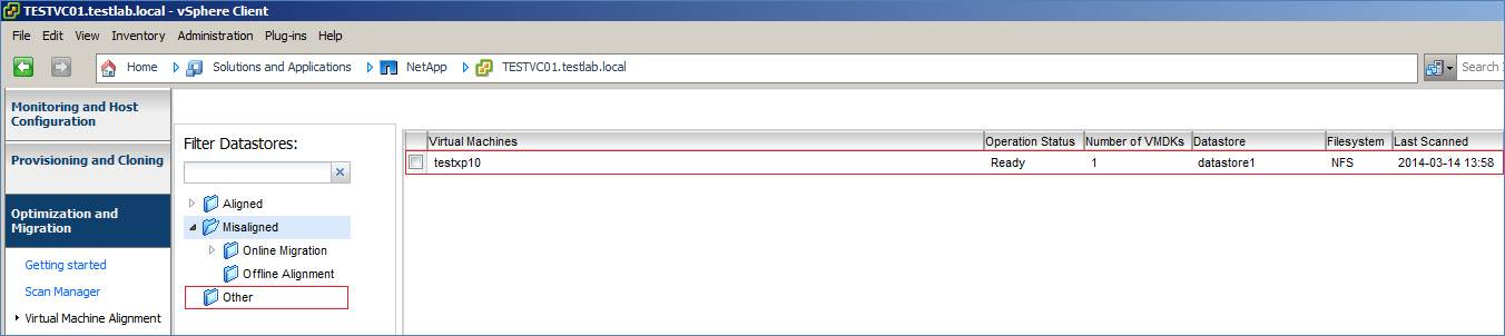

GUI View:

Hi Daniele,
Can you try the following code (modifying varabile names to match your environment) and display the "requestSpec" values to ensure the credentials are correct?
Run the following code from a powershell prompt:
$vscHostName = "testvc01"
$portNumber  = 8143
$username    = "testlab\administrator"
$password    = Read-Host "Please enter the password for user ""$username""" -AsSecureString
$credentials = New-Object System.Management.Automation.PSCredential -ArgumentList $username, $password
[System.Net.ServicePointManager]::ServerCertificateValidationCallback = {$True}
$uri         = "https://$VscHostName`:$PortNumber/caster/public/api?wsdl"
$connection  = New-WebServiceProxy -uri $uri -Credential $Credentials
$namespace   = $connection.GetType().Namespace
$vscDomain   = $Credentials.GetNetworkCredential().domain
$vscUser     = $Credentials.GetNetworkCredential().username
$vscPassword = $Credentials.GetNetworkCredential().password
$vscUsername = "$vscDomain\$vscUser"
$requestSpecType        = ($namespace + '.requestSpec')
$requestSpec            = New-Object ($requestSpecType)
$requestSpec.serviceUrl = "https://" + $vscHostName + "/sdk"
$requestSpec.vcUser     = $vscUsername
$requestSpec.vcPassword = $vscPassword
$results                = $connection.getAlignmentReport($requestSpec)
$requestSpec | fl
$results
Example Output:
serviceUrl : https://testvc01/sdk
vcPassword : p@ssw0rd
vcSession  :
vcUser     : testlab\administrator
alignmentStatus          : ONLINE_MIGRATION
alignmentStatusSpecified : True
datastoreName            : datastore1
instanceUuid             : 5021e732-9bcc-f68d-8a64-1c99a4b50867
moref                    : VirtualMachine:vm-411
offset                   : 7
offsetSpecified          : True
Please let me know if that works. Thanks
