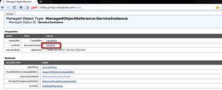

  • Before VSC 1.0 was uninstalled, it needed to be unregistered with vCenter.  This a manual step with the 1.0 version of VSC.   You do not need to re-install 1.0
  • in order to un-registered it. However, it will require you to manually unregister it with VMware Managed Object browser with a few simple steps.
  • Locate and click on the ExtensionManager:
  • In the bottom window, Click on the method "UnregisterExtension".  A new window will open and ask for the plugin key.  Enter "com.netapp.exoforce" and click on the "Invoke Method" button to unregister the VSC 1.0 plugin.
