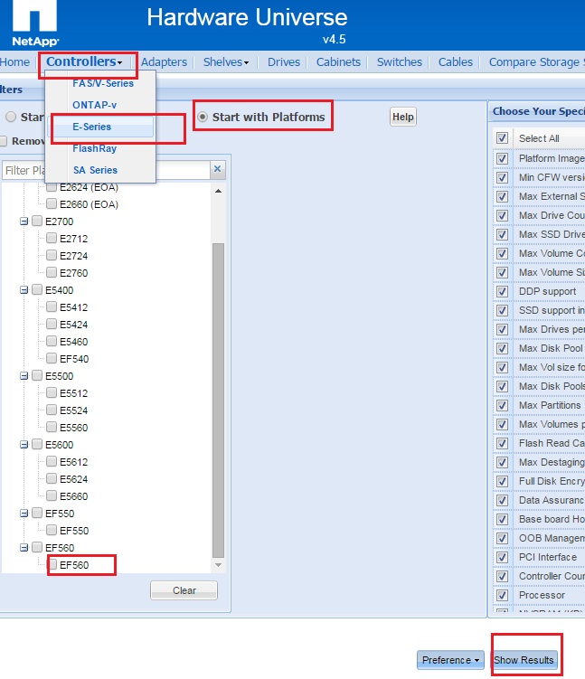

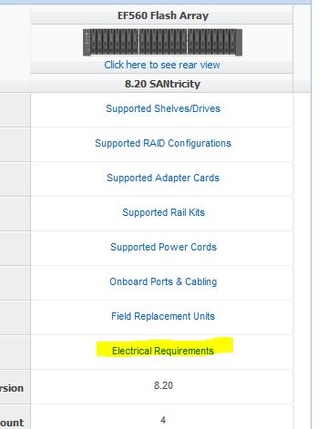

georgevj
5,449 Views
If anybody has such a question, I suggest checking the hardware universe as the first step.
HWU is available here. http://hwu.netapp.com
Here is an example how you can get to the EF560 controller.
