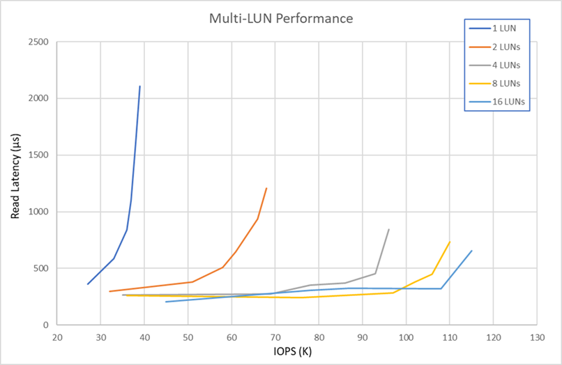

The question was - “How many LUNs do I need?” These tests used *one* volume. Multiple LUNs, but one volume. Let’s say you have a database. How many LUNs did you need in that LVM or Oracle ASM volume group to support your workload? What is the expected performance? Here’s the answer to that question when using a single AFF8080 controller prior to ONTAP 9.9.1.
There are three important takeaways from that test:
- A single LUN hit the wall at about 35K IOPS.
- A single volume hit the wall at about 115K IOPS
- The sweet spot for LUN count in a single volume was about 8, but there was some benefit going all the way to 16.
To rephrase that:
- If you had a single workload that didn’t need more than 35K IOPS, just drop it on a single LUN.
- If you had a single workload that didn’t need more than 115K IOPS, just drop it on a single volume, but distribute it across 8 LUNs.
- If you had more than 115K IOPS, you would have needed more than one volume.

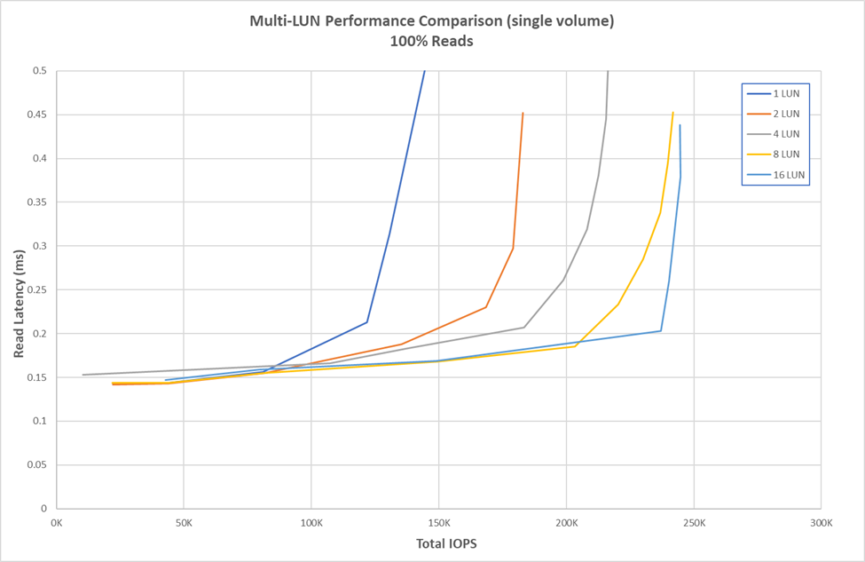

To illustrate, let’s start with the same set of tests I showed for <9.9.1, with a single volume and varying numbers of LUN in the diskgroup:
I see four important takeaways here:
- A single LUN yields about 4X more IOPS than before.
- A single LUN not only delivers 4X more IOPS, but the latency is also about 40% lower.
- A single volume (with 8 LUNs) yields about 2X more IOPS
- A single volume (with 8 LUNs) delivers 2X more IOPS and with 40% lower latency.
That might seem simple, but there are a lot of implications to those four points. Here are some of the things you need to understand.

Previously, I maxed out SAN IOPS in a single volume at about 110K IOPS. The limit roughly doubled to 240K IOPS in 9.9.1. That’s a big increase. IO-intensive workloads that previously required multiple volumes can be consolidated to a single volume. That means simpler management. You can create a single snapshot, clone a single volume, set a single QoS policy, or configure a single SnapMirror replication relationship.
Even if you don’t need the extra IOPS, you still get better performance
The latency dropped, too. Even a smaller database that only required 25K IOPS and was happily running on a single volume prior to 9.9.1 should see noticeably improved performance, because the response times of those individual 25K IOPS got better. Application response times get better, queries complete faster, and end users get happier.

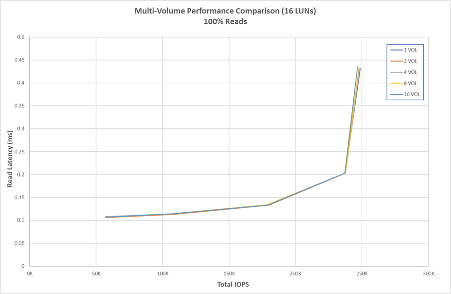

Want proof that multiple volumes don’t help? Check this out.
It’s the same line! In this example, I created a 16-LUN volume group and compared performance between configurations where those 16 LUNs were in a single volume, 2 volumes, 4, 8, and 16. There’s literally no difference, nor should there be. As mentioned above, ONTAP SAN processing as of 9.9.1 does not care if the underlying LUNs were located in different volumes. The FC IO was processed as a common pool of FC IO operations.

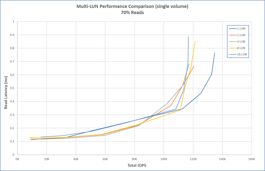

First, let’s look at a repeat of my first 9.9.1 test, but this time I’m doing 70% reads and 30% writes. What happens?
The maximum measured IOPS dropped. Why? The reason is that writes are more expensive to complete than reads for a storage array. Obviously, platform maximums will be reduced as write IO becomes a larger and larger percentage of the IO, but this is just one volume. I’m nowhere near controller maximums. Performance remains awesome. I’m at about 150us latency for most of the curve, and even at 100K IOPS, I’m only at 300us of latency. That’s great, but it is slower than the 100% read IOPS test.
What you’re seeing is the result of read IOPS getting held back by the write IOPS. There were more IOPS available to my database from this volume, but they weren’t consumed, because my database was waiting on write IO to complete. The result is that the total IOPS dropped quite a bit.

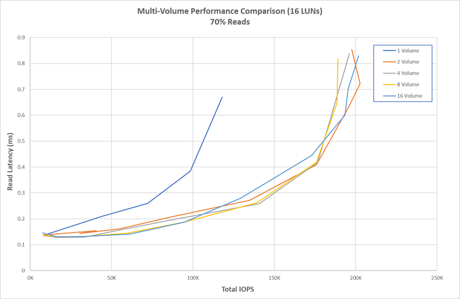

Multi-Volume write IOPS
Here’s what happens when I spread these LUNs across two volumes.
Looks weird, doesn’t it? Why would 2 volumes be 2X as fast as a single volume, and why would 2, 4, 8, and 16 volumes perform about the same?
The reason is that ONTAP is establishing queues for writes. If I want to maximize write IOPS, I’m going to need more queues, which will require more volumes. The exact behavior can change between configurations and platforms, so there’s no true best practice here. I’m just calling out the potential need to spread your database across more than one volume.

- If I have 16 LUNs, there is literally no benefit to splitting them amongst multiple volumes with a 100% read workload. Look at that earlier graph. The datasets all graphed as a single line.
- Two volumes with a 70% read workload showed a big improvement going from 1 volume to 2, but then nothing further. That’s because, in my configuration, there are two queues for write processing within ONTAP. Two volumes are no different than 3 or 4 or 5 in terms of keeping those queues busy.
I also want to repeat – the graphs are the worst-case scenario. A real database workload shouldn’t be affected nearly as much, because reads and writes should be largely decoupled from one another. In my test, there are about two reads for each write with limited parallelization, and those reads do not happen until the write completes. That does happen with real-world database workloads, but very rarely. For the most part, real database read operations do not have to wait for writes to complete.
