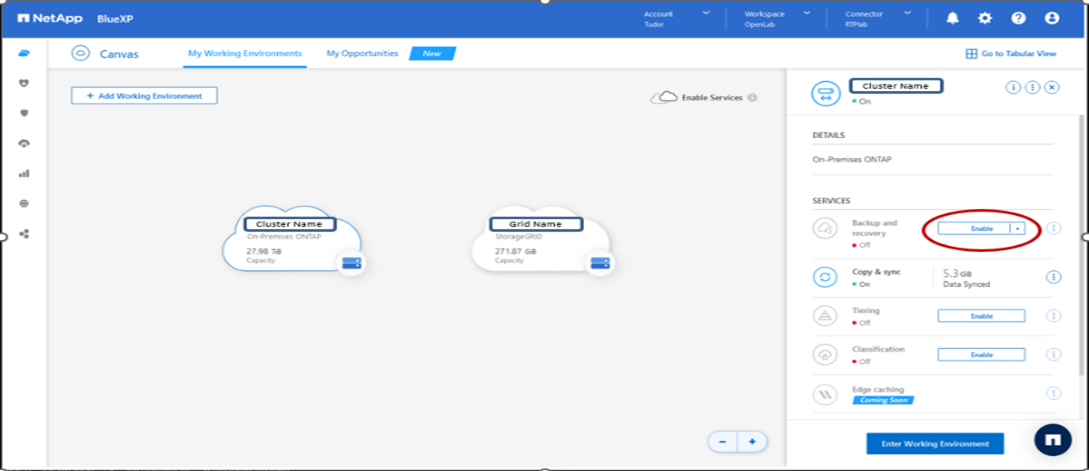

- From the BlueXP canvas, select the ONTAP system and click Enable to launch the wizard that enables you to add StorageGRID as the backup target.

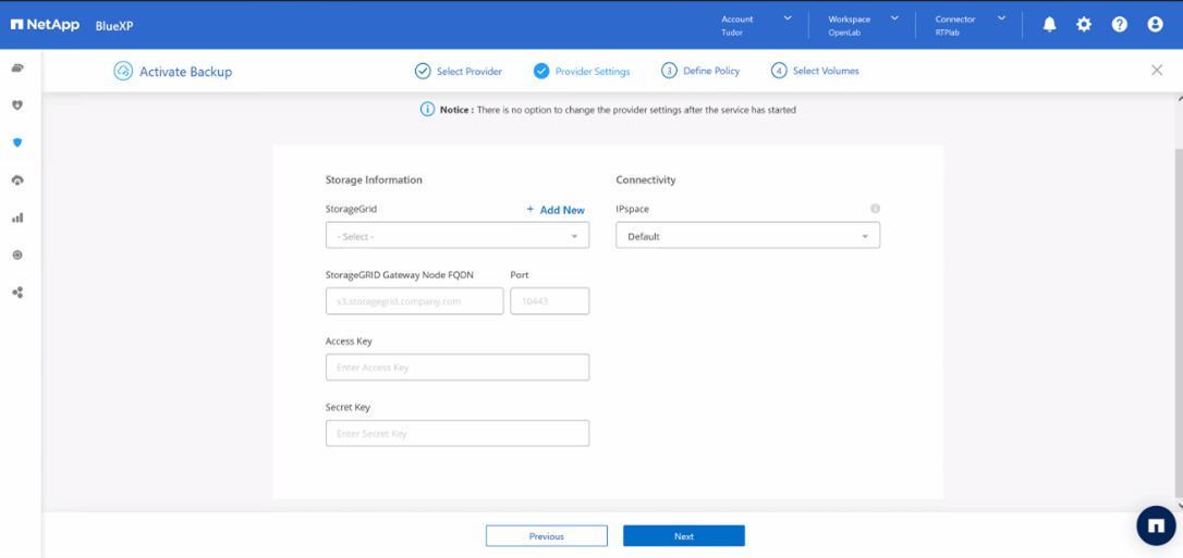

2. Provide the StorageGRID fully qualified domain name (do not use the IP address), the port, and the access and secret keys that allow you to connect to StorageGRID as an S3 client. Note that the FQDN information required does not refer to the StorageGRID management IP address. The FQDN refers to a StorageGRID end point that serves S3 APIs. Then click Next.

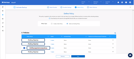

3. On the next window, make sure that you select the policy that you created previously. In my case, it was EHRsnapmirrorpolicy. Click Next.

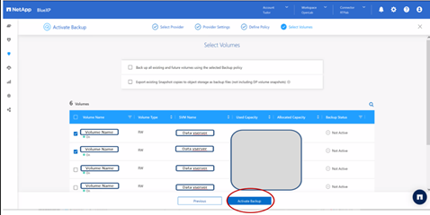

4. In Backup Settings, you are presented with a view like the following. Select the appropriate volumes/LUNs and click Activate Backup.
That concludes your preparation steps—which you should have to do only once.
