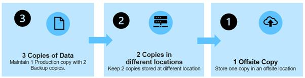

What is the 3-2-1 Backup Strategy?
The 3-2-1 backup strategy emphasizes having multiple copies of data in different locations, ensuring redundancy, and mitigating the risk of data loss. The 3-2-1 backup strategy entails keeping at least three copies of data: two copies on separate storage devices, and one copy stored offsite.
Here's how it works:
1. 3 Copies of Data: Create three copies of your data. This means you should have the original data plus two additional copies. The goal is to have multiple versions of your data available in case one copy becomes corrupted or unavailable.
2. 2 Different Storage Media: Store your data on at least two different types of storage media. For example, you could have one copy on your computer's hard drive and another on an external hard drive, network-attached storage (NAS), or cloud storage. This helps guard against failures or issues that could affect a specific type of storage.
3. 1 Off-Site Backup: Keep at least one copy of your data off-site, preferably in a separate physical location from your primary storage. This protects against events like theft, fire, floods, or other disasters that could affect your primary storage location. Cloud storage is a common choice for off-site backups because it provides remote storage accessible from anywhere.

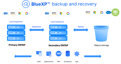

How Does BlueXP Backup and Recovery 3-2-1 Backup Work?
BlueXP Backup & Recovery service implements 3-2-1 backup by allowing users to set up replication between ONTAP clusters and backup to the cloud or StorageGrid object store in different topologies. It oversees the entire backup procedure comprehensively, from a single centralized location. This involves handling various aspects such as managing local backups, facilitating primary to secondary backup replication, and conducting backups to Object storage. By emphasizing end-to-end management, the service aims to streamline and simplify the backup process, ensuring the seamless transfer and protection of data.
Local Snapshot features:
BlueXP Backup and Recovery 3-2-1 full backup spectrum feature enables users to
1. Modify Snapshot policies on production source volumes to configure the appropriate Snapshot creation schedule, snapshot retention count, and snapmirror-label to identify which snapshots need to be replicated by the SnapMirror engine.
Replication features:
1. Replicate data between ONTAP storage systems to support backup and disaster recovery.
2. Ensure the reliability of your DR environment with high availability.
3. Native ONTAP in-flight encryption is set up via Pre-Shared Key (PSK) between the two systems.
4. Copied data is immutable until you make it writable and ready to use.
5. Replication is self-healing in the event of a transfer failure.
6. When compared to the BlueXP replication service, the replication in BlueXP backup and recovery includes the following features:
a) Replicate multiple FlexVol volumes at a time to a secondary system.
b) Restore a replicated volume to the source system or to a different system using the UI.

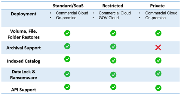

Supported Features and Deployments in BlueXP Backup and Recovery 3-2-1 Backup
BlueXP Backup and Recovery Panoramic Protection offer versatile deployment options, efficient restores at different data levels, archival support, an indexed catalog for easy backup management, robust data protection against ransomware, and API support for seamless integration and automation. These features combine to provide a comprehensive and reliable backup and recovery solution.

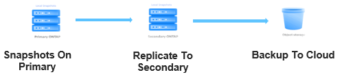

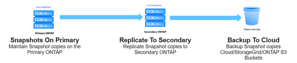

Choosing the Topology:
There 4 different ways in which you configure your backup:-

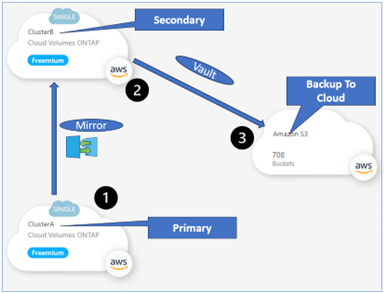

• Cascading Topology:- In this topology, the Snapshot copies of the volumes in the primary ONTAP cluster are taken and replicated to a secondary cluster. The replicated backups from the secondary ONTAP cluster will be then moved to an offsite location to Cloud or StorageGRID object store.

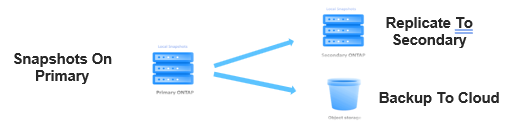

• Fan-Out Topology:- In the Fan-Out topology, the Snapshot copies of the volumes in the primary ONTAP cluster are taken and replicated to a secondary cluster and will also be moved to an offsite location to Cloud or StorageGRID object-store.
• Replication:- Replicate the Snapshot copies of the volumes in the primary ONTAP to a secondary cluster.
• Backup to Object store:- Backup the Snapshot copies of the volumes in the primary ONTAP to a Cloud or StorageGRID object-store.

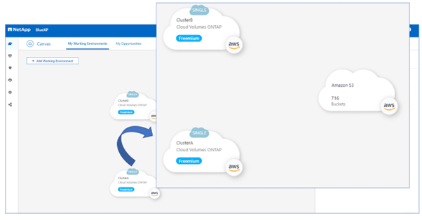

For Cascading Topology:- Make sure to create the Snapshot policies in Primary (ClusterA) and both the Replication policies and Backup To Cloud policies should be created in Secondary (ClusterB).
For Fan-Out Topology:- Make sure to create the Snapshot policies, and the Backup To Cloud policies on Primary (ClusterA), and the Replication policies should be created in Secondary (ClusterB)
Activating the 3-2-1 Backup
3) Now from the 3-2-1 User Interface, let's go ahead and activate the 3-2-1 Backup

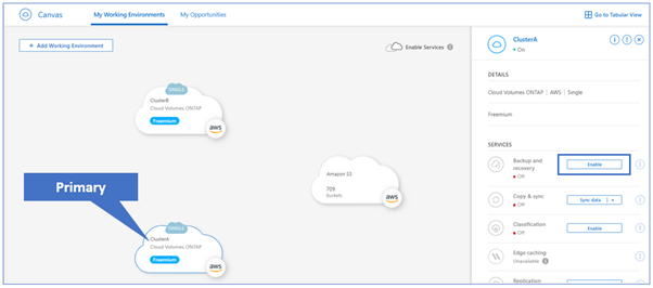

• Click on the Primary Cluster/ClusterA
• On the right Navigation panel, click on the “Enable Backup”

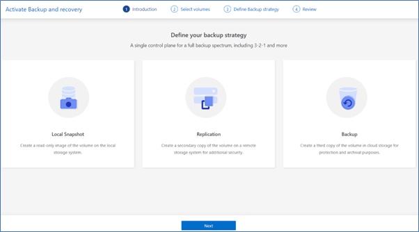

4) Now you will be welcomed by the 3-2-1 backup introduction screen "Define your backup strategy", encouraging users to define the backup strategy that they would like to deploy. Click on “Next”.

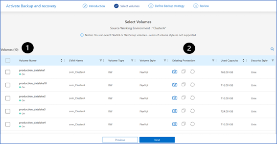

Volume Page
5) Clicking Next will take you to the “Volume” page. The volume page lists the volume in the Primary ONTAP ClusterA that you would like to protect.
Choose the Volumes that you would like to protect. Select the volumes by clicking on the checkbox. Now a warning message will pop - up indicating that the volumes that have been selected have existing snapshot and replication policies, and if we define new ones they are going to be overwritten.
The “Existing Protection” column will show users if any protection is enabled on the specific volume. This helps users to make an informed decision and plan effectively the protection topology that they would need to use.
-Shows all the snapshot policies enabled on the volume
-Shows all the replication relationships enabled on the volume
-Shows all the Backup to Cloud relationships enabled on the volume

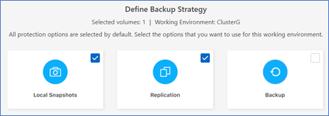

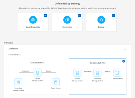

Define Backup Strategy
6) In the “Define Backup Window”, choose the protection option that you would like to use for the working environment. In this example we will be setting up Cascading backup topology, hence choose “Local Snapshots”, “Replication” and “Backup”.
Now we have to choose the topology. We have the option to choose “Cascading” or “Fan-Out”.
Please note that the backup activation screen for Fan-Out topology will be similar to that of Cascading. The only difference is that for Fan-Out topology, the snapshot policies and backup to object store policies will be displayed on the “Define Backup Strategy” screen will be from the Primary Cluster and the replication policies shown will be from the Secondary Cluster.
Whereas for Cascading topology, the replication policies and backup to object store policies will be displayed on the “Define Backup Strategy” screen will be from the Secondary Cluster and the snapshot policies shown will be from the Primary Cluster.

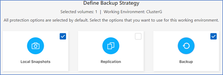

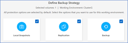

• If you are choosing, Fan-Out Backup Topology, make sure to choose “Local Snapshots”, “Replication” and “Backup”.
• If you are choosing, Cascading Backup Topology, make sure to choose “Local Snapshots”, “Replication” and “Backup”.
• If you would like to do a replication relationship, choose “Local Snapshots” and “Replication”.
• If you would like to do a backup to the object-store relationship, choose “Local Snapshots” and “Backup ”.
• Depending on the options that you have chosen, the respective widgets to configure the backup activation will be available. If they are not selected, the respective widgets will not be available.

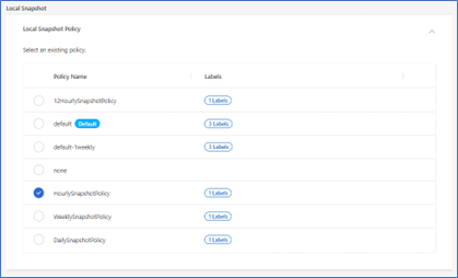

7) For the Local snapshot, let's go ahead and choose a policy.

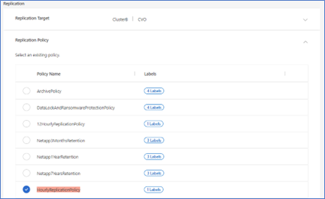

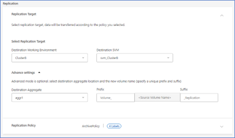

😎 Now for Replication,
• Let’s configure the “Replication Target”.
Select the replication target accordingly so that the data will be transferred according to the policy you will be selecting. Now select the Replication Target. Choose the appropriate “Destination Working Environment” and Select “Destination SVM”. Click on “Advanced Setting” to select the destination Aggregate and customize the name for the data protection volume that will be created.
• Now we will go ahead and enable the replication policy. Expand the Replication Policy accordion. Choose the appropriate replication policy.

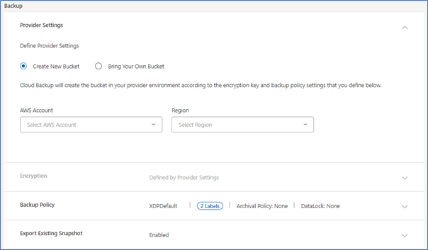

9) Now configure Backup to Cloud
• First, let's go ahead and configure the “Provider Settings”. You can define the provider settings to configure the object store for modes.
1. “Create a New Bucket”
2. ”Bring Your Own Bucket”.
• Choosing “Create a New Bucket”, requires you to give the ”Account” and “Region” detail. Choose the appropriate Account and region from the drop-down. This action will create a bucket in the mentioned account and region.
• Choosing “Bring Your Own Bucket ”, requires you to choose the appropriate ”Account” from the drop-down list and all the buckets under the particular account will be listed. Make sure that you choose the appropriate bucket from the drop-down list to backup the data.
Refer to the documentation attached on how to create and prepare your custom buckets

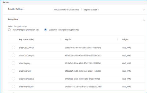

10) Configuring the encryption. Choose the required mode of the Encryption key. You can choose “AWS Managed Encryption Keys” or “Customer Managed Encryption Keys”. Before you choose “Customer Managed Encryption Keys” make sure to create the appropriate keys in the KeyVault.

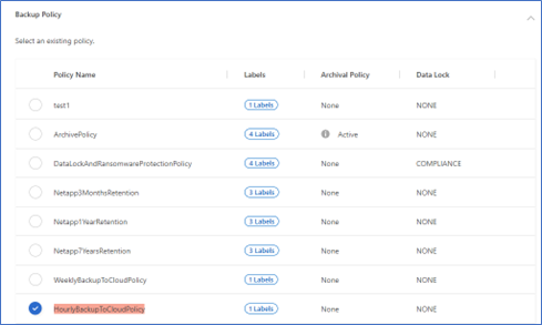

11) Choose the Backup to Cloud Policy. All the Backup To Cloud policies (which are mainly vault policies) pertaining to ClusterB will be listed in the “Backup Policy” section of the Backup widget. Choose the appropriate Backup to Cloud policy. . Click on “Next”

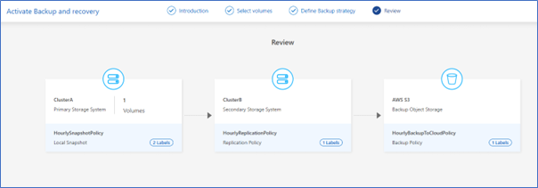

Review Page
12) Next you will be taken to the “Review” page, which shows the 3-2-1 Backup Topology that has been selected by the user. It will show the details of the Primary Cluster, Secondary cluster, and the backup object store chosen by the user. It will also show you the details of the Snapshot policy associated with the primary source volumes, the replication policies for the SnapMirror relationship, and Backup To Cloud policies and the respective labels.
Activate Backup
13)Click on “Activate Backup”, which will initiate the backup activation process in the desired topology.
