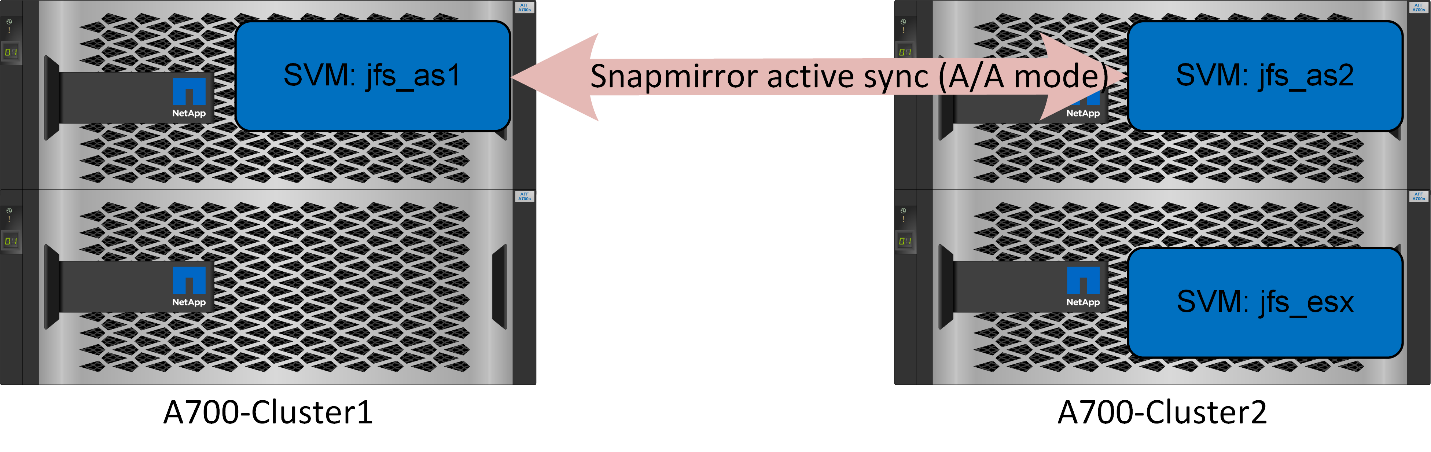

The feature I wanted to test was SnapMirror active sync (SM-AS) running in symmetric active-active mode. We enhanced SM-AS last year to offer symmetric active-active replication. Here’s a basic diagram of what I was working with:
It’s a couple of A700 clusters with SM-AS enabled. I set up my Oracle RAC configuration, including databases and quorum drives, on the jfs_as1 and jfs_as2 SVMs. Oracle RAC is not yet supported with SM-AS in active/active mode, but I couldn’t think of a reason it shouldn’t work, and I wanted to give this a spin. The idea here is creating a single cross-site, ultra-available Oracle RAC cluster. I'll post on this later.
