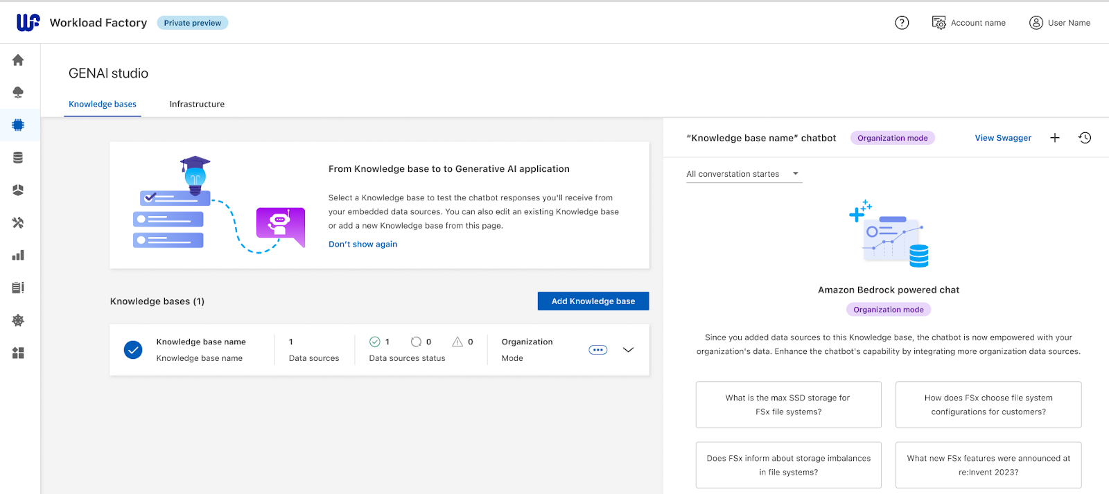

Workload factory empowers FSx for ONTAP users to deploy, optimize, automate, and operate AWS workloads through intuitive wizards, comprehensive dashboards, and ready-to-deploy infrastructure as code (IaC). For GenAI, creating a GenAI application powered by Amazon Bedrock is simple using workload factory.
From the workload factory GenAI page, you can create and manage your knowledge bases to set up RAG-based GenAI applications powered by Amazon Bedrock.
Workload factory GenAI goes beyond by enabling you to unlock the power of your FSx for ONTAP data sources for any GenAI solution design, with any open-source or proprietary tooling of your choice.
You can use workload factory GenAI to access and utilize your internal data on FSx for ONTAP for intelligent and context-aware AI chatbot interactions with a RAG-based solution developed with LangChain and LanceDB. Let’s see how it’s done.

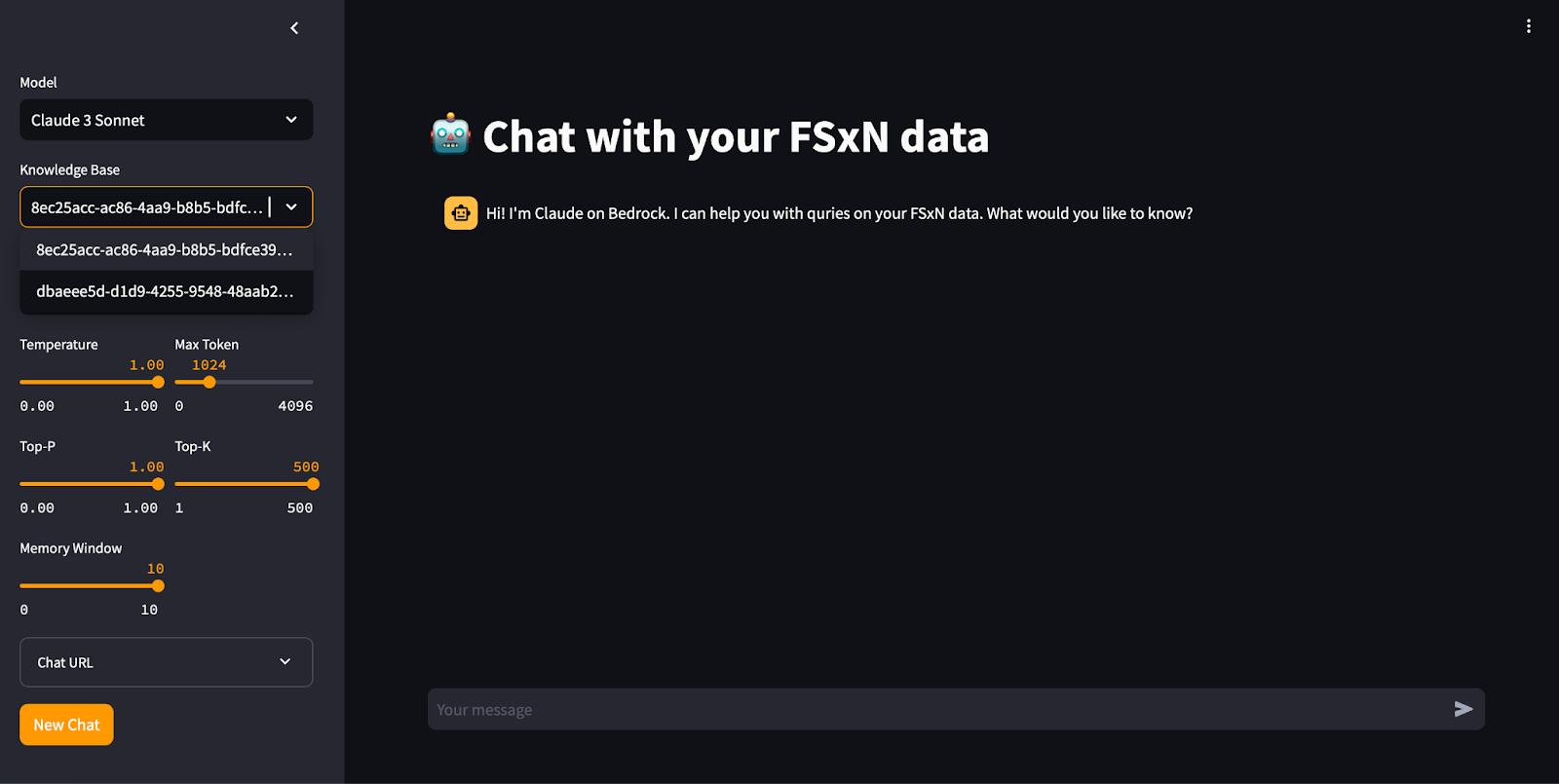

- Connecting to your LanceDB database.
LanceDB is a powerful vector search database that stores and indexes your data for efficient retrieval. To make the vector embeddings accessible to the application, you set up an authenticated connection to the LanceDB instance associated with your workload factory environment, and access the table associated with your chosen knowledge base via the knowledge base id.
The data in the knowledge base is permissions-aware, meaning that users who query the data will not get access to data they don’t have permissions to access. This is explained in more detail below.

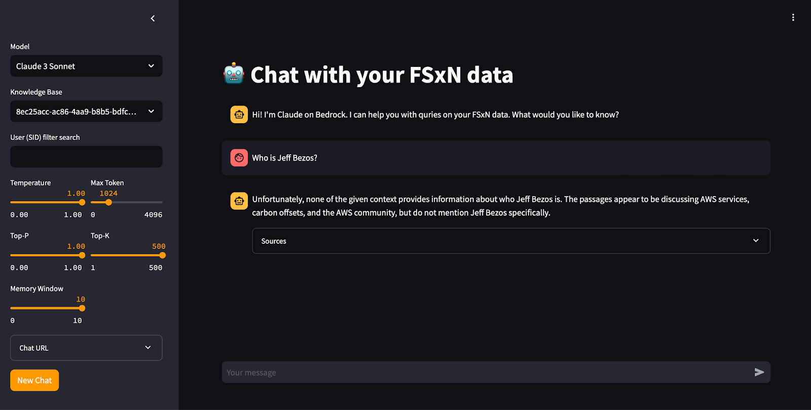

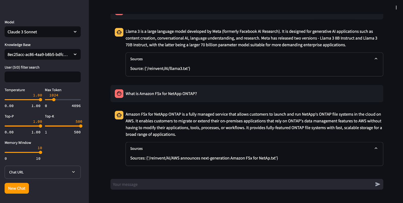

- Building your AI Chatbot.
RAG combines retrieval and generation models to provide accurate answers with context relevance. You can use LangChain to set up dialogue management, integrate with the RAG framework, and configure interactions to deliver context-aware responses based on the enriched knowledge base.
Permission to use each data item is strictly based on the chat user’s permissions level.

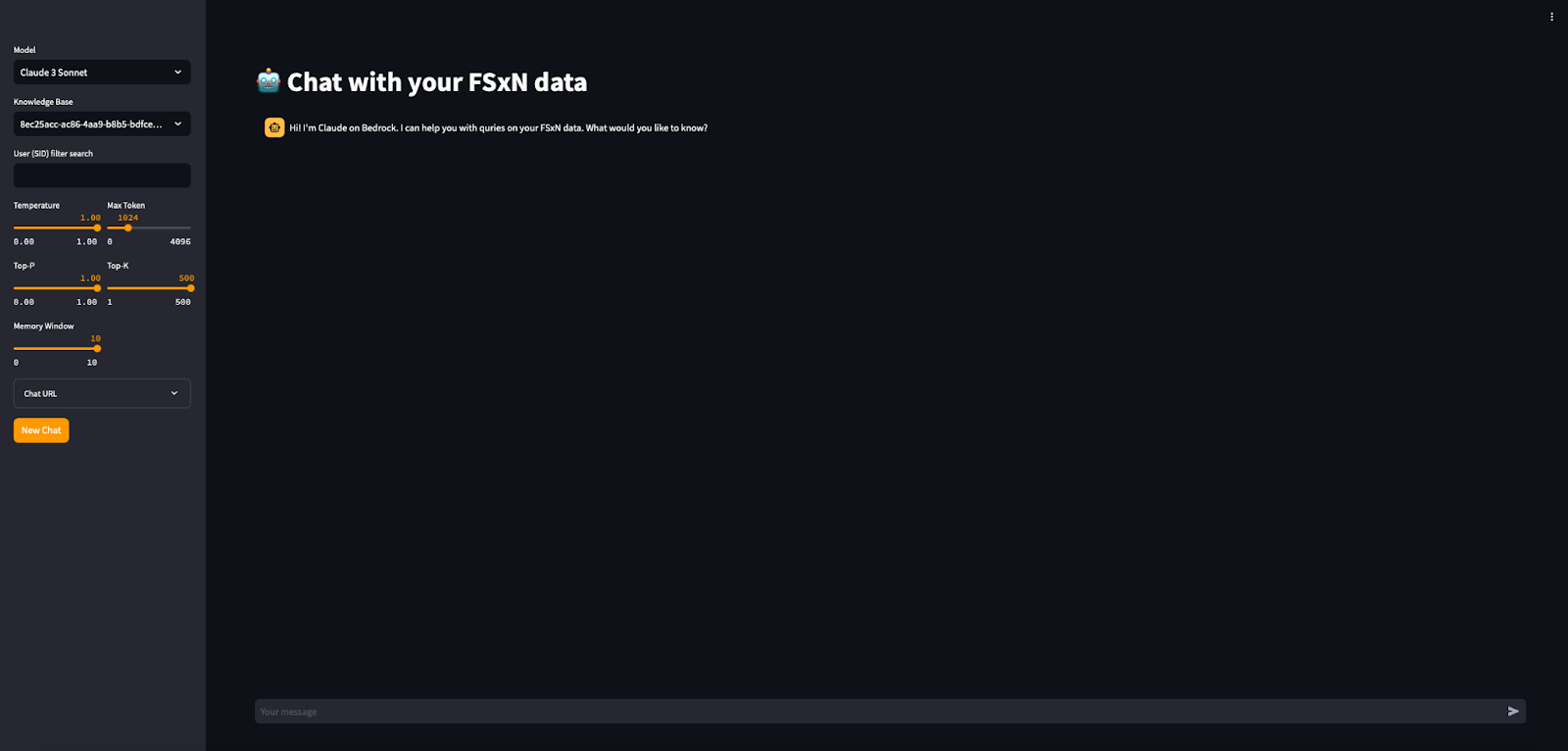

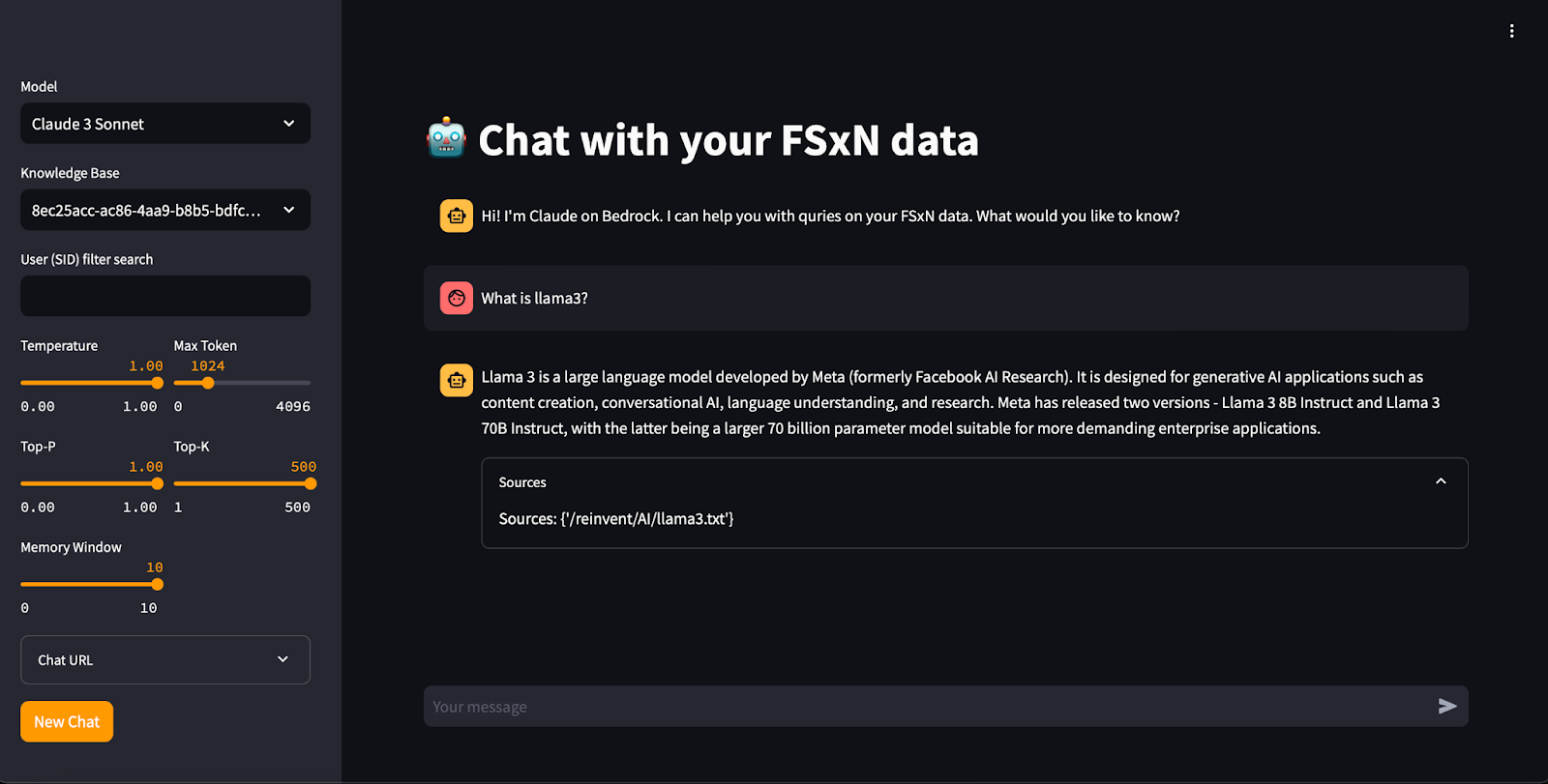

Then, you can use streamlit to create the AI chatbot interfaceーyou can find an end-to-end example for the demo chatbot application in our git examples repo.
Here is an example of how the chatbot interface looks like, using information from the selected knowledge base:

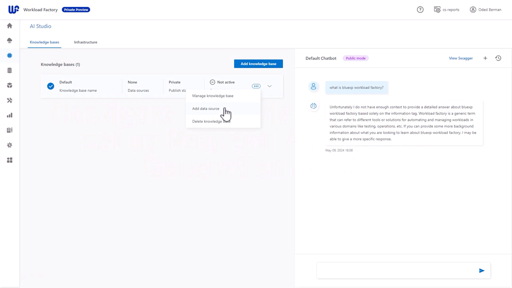

A knowledge base in workload factory is defined by a name, description, embedding model, chat model, and optional conversation starters. When you create a knowledge base—such as the Default knowledge base in the screenshot below—you can customize all these values to match your AI application requirements.
On its own, a knowledge base is just a container. You can click on the “Add data source” button to open the wizard that guides in loading your proprietary data in the knowledge base.
FSx for ONTAP organizes your data in a hierarchical structure: file system, volume, and folder. You can select one or more of your existing FSx for ONTAP file systems, volumes, and folders to create as your data source.
Follow the step-by-step guide on how to carry out this process in our post How to deploy and manage RAG knowledge base on FSx for ONTAP with BlueXP workload factory GenAI.
Take note of the knowledge base id, which you can find from in the “Manage Knowledge Base” screen in the BlueXP workload factory, as you’ll need it in the next steps.

Building your AI chatbot
What happens when a user sends a message to the chatbot interface?
This section walks you through how to build your AI chatbot so that it returns an optimal context-aware response for the user request.

By following these steps, you've effectively configured your AI chatbot to handle user queries with enhanced context awareness from your FSx for ONTAP data. Leveraging Amazon Bedrock models and integrating advanced data retrieval and response generation mechanisms ensures your chatbot delivers accurate and relevant answers. This setup not only enhances user interaction but also provides a seamless experience in navigating and retrieving information from your knowledge base.
Query your AI chatbot
Below you will see a few examples showing how to query the Amazon Bedrock chatbot using information in the knowledge base.
Here in the left panel, you can see a knowledge base has been selected in the UI through the ID provided by workload factory:
Asking a question that can be answered with information in the knowledge base on FSx for ONTAP data will also provide the source of the answer:
Asking questions about data that is not included in the knowledge base on FSx for ONTAP data will produce a reply from the chatbot that it doesn’t have the information to answer:
