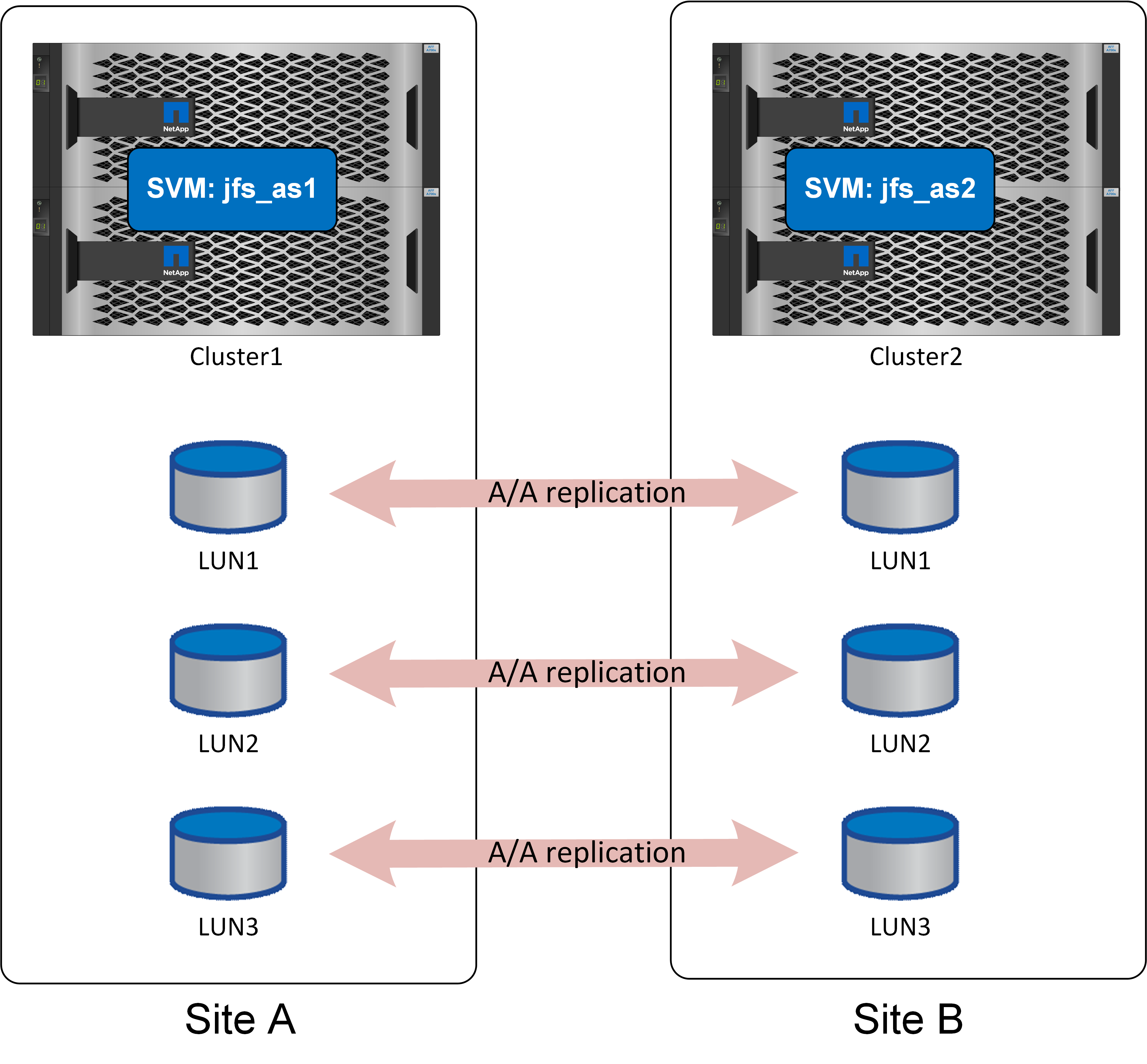

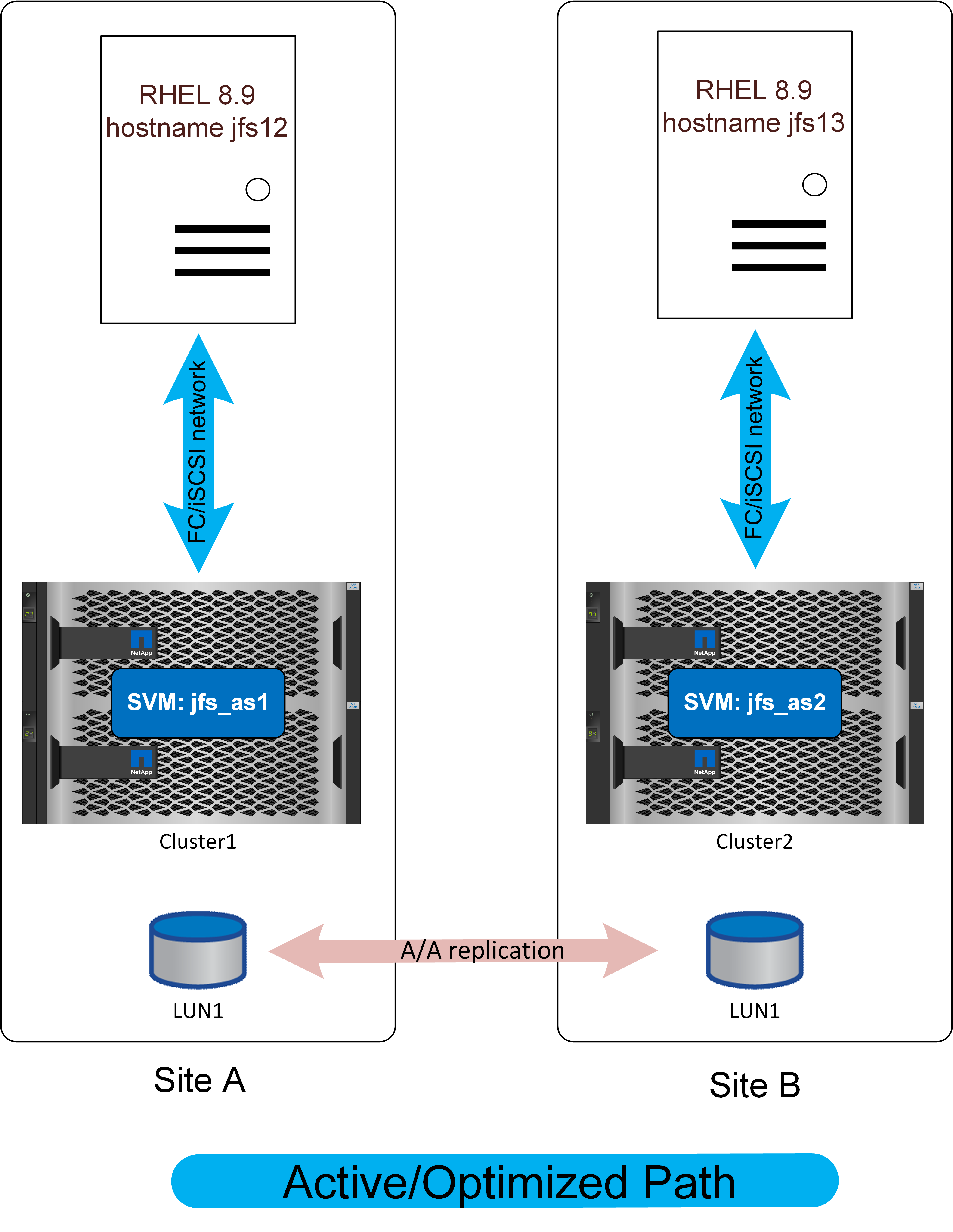

Let’s start with the basics of how SM-as replication works.
Here’s what this shows:
- These are two different storage clusters. One of them is Cluster1, and the other is Cluster2. (I'll explain the jfs_as1 and jfs_as2 labels a little later…)
- It might look like there are six LUNs but it’s logically only three.
- The reason is there are six different LUN images, but the LUN1 on each jfs_as1 is functionally the same as LUN1 on jfs_as2, the LUN2's are the same, and the LUN3's are the same.
- From a host point of view, this looks like ordinary SAN multipathing. LUN1 and its data is available and accessible on either cluster.
- IO behavior and IO performance are symmetric.
- If you perform a read of LUN1 from the cluster on site A, the read will be serviced by the local copy of the data on site A
- If you perform a read of LUN1 from the cluster on site B, the read will be serviced by the local copy of the data on site B
- Performing a write of LUN1 will require replication of the write to the opposite site before the write is acknowledged.

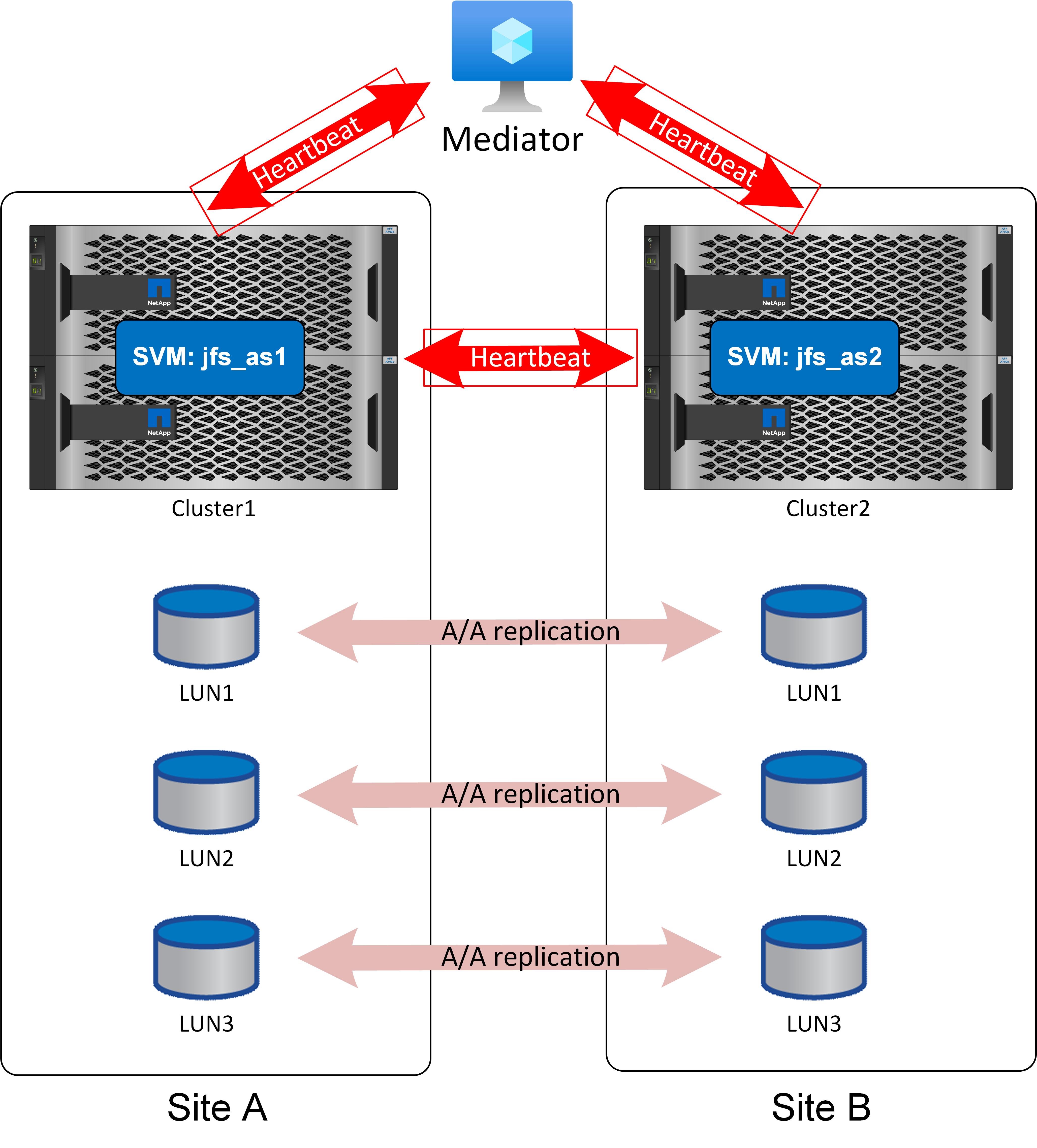

Now let's look at failover. There’s another component involved – the mediator.
The mediator is required for safely automating failover. Ideally, it would be placed on an independent 3rd site, but it can still function for most needs if it’s placed on site A or site B. The mediator is not really a tiebreaker, although that’s effectively the function it provides. It's not taking any actions; it’s providing an alternate communication channel to the storage systems.
The #1 challenge with automated failover is the split-brain problem, and that problem arises if your two sites lose connectivity with each other. What should happen? You don’t want to have two different sites activate themselves as the surviving copy of the data, but how can a single site tell the difference between actual loss of the opposite site and an inability to communicate with the opposite site?
This is where the mediator enters the picture. If placed on a 3rd site, and each site has a separate network connection to that site, then you have an additional path for each site to validate the health of the other. Look at the picture above again and consider the following scenarios.
- What happens if the mediator fails or is unreachable from one or both sites?
- The two clusters can still communicate with each other over the same link used for replication services.
- Data is still served with RPO=0 protection
- What happens if Site A fails?
- Site B will see both of the communication channels to the partner storage system go down.
- Site B will take over data services, but without RPO=0 mirroring
- What happens if Site B fails?
- Site A will see both of the communication channels to the partner storage system go down.
- Site A will take over data services, but without RPO=0 mirroring
There is one other scenario to consider: Loss of the data replication link. If the replication link between sites is lost, RPO=0 mirroring will obviously be impossible. What should happen then?
This is controlled by the preferred site status. In an SM-as relationship, one of the sites is secondary to the other. This makes no difference in normal operations, and all data access is symmetric, but if replication is interrupted then the tie will have to be broken to resume operations. The results is that the preferred site will continue operations without mirroring and the secondary will halt IO processing until replication is reestablished. More on this topic below…

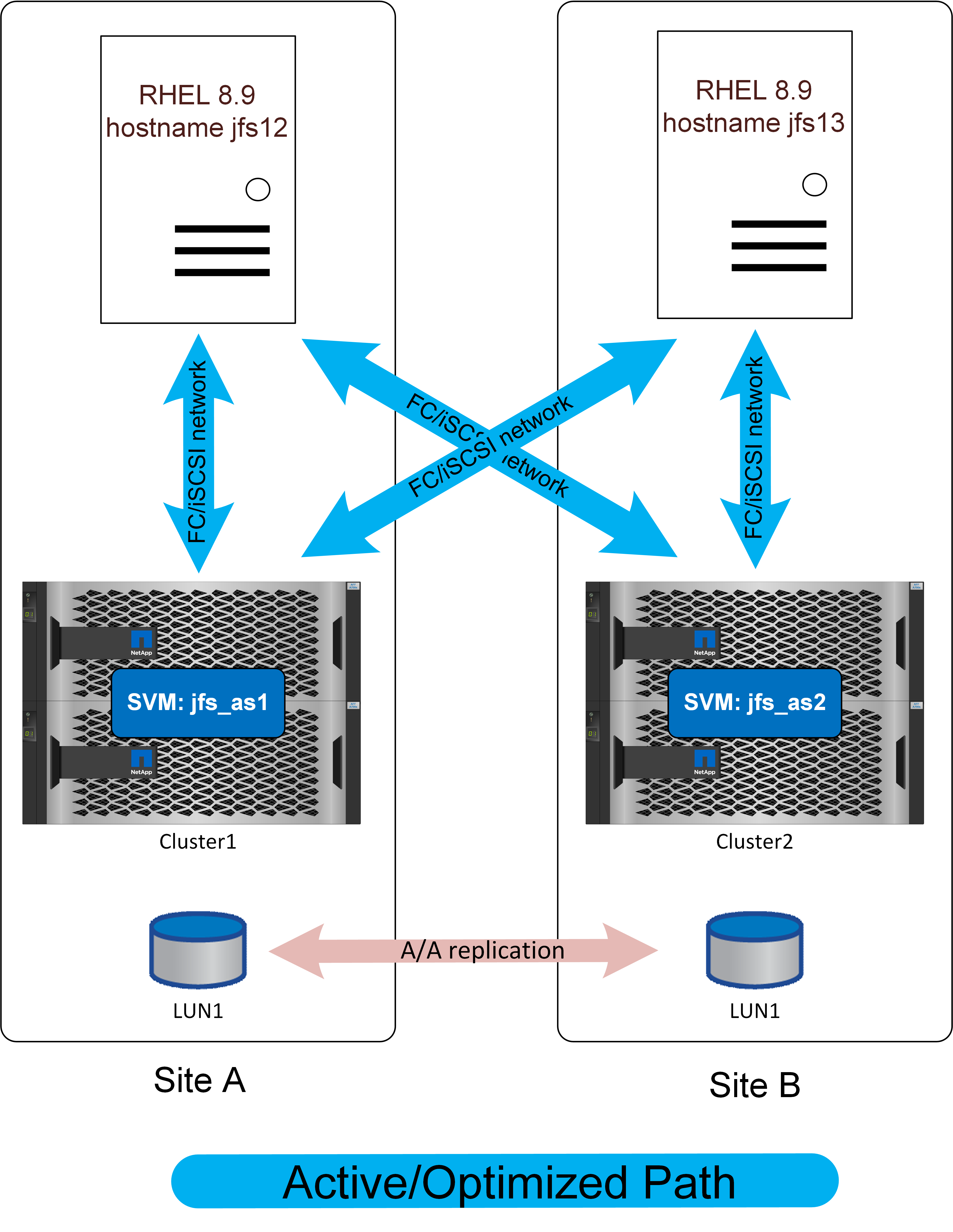

As explained above, SM-as functionally provides the same LUNs on two different clusters. That doesn’t mean you necessarily want your hosts to access their LUNs across all available paths. You might, or you might not. There are two basic options called uniform and non-uniform access.
Uniform access

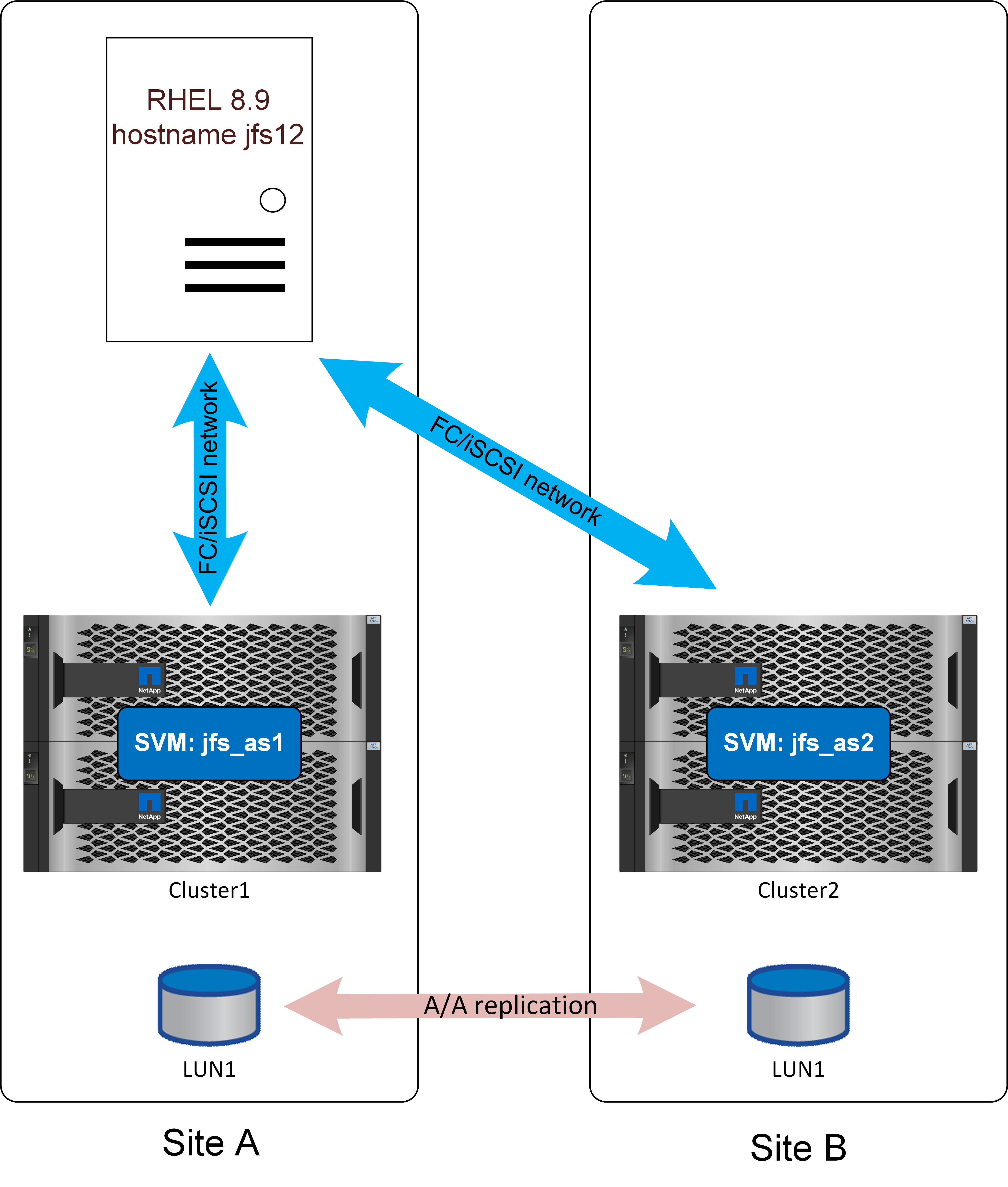

Let’s say you had a single host, and you wanted RPO=0, RTO=0 data protection. You’d probably want to configure SM-as with uniform access, which means the LUNs would be visible to your host from both clusters.
Obviously, this will mean that complete loss of site A would also result in the loss of your host and its applications, but you would have extremely high availability storage services for your data. This is probably a less common use case for SM-as, but it does happen. Not all applications can be clustered. Sometimes all you can do is provide ultra-available storage and accept that you’ll need to find alternate servers on a remote site in the event of disaster.

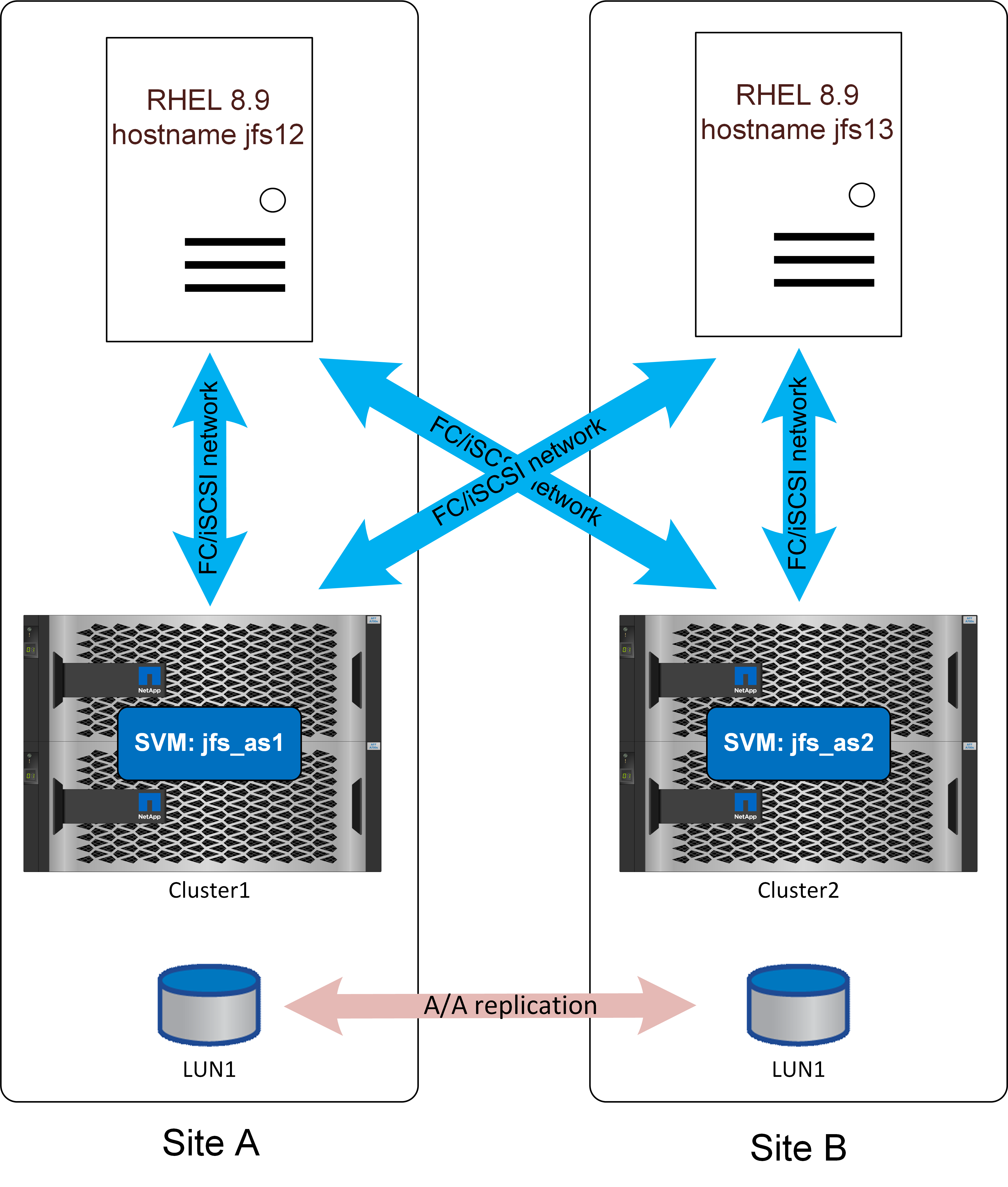

Another option with uniform access is in a full mesh networked cluster.
If you use SM-as with uniform access in a cluster as shown above, any host should always have access to a usable copy of the data. Even if one of the storage systems failed or storage replication connectivity was lost, the hosts would continue working. From a host multipath point of view, it all looks like a single storage system. A failure of any one component would result in some of the SAN paths disappearing off the network, but otherwise everything would continue working as usual.

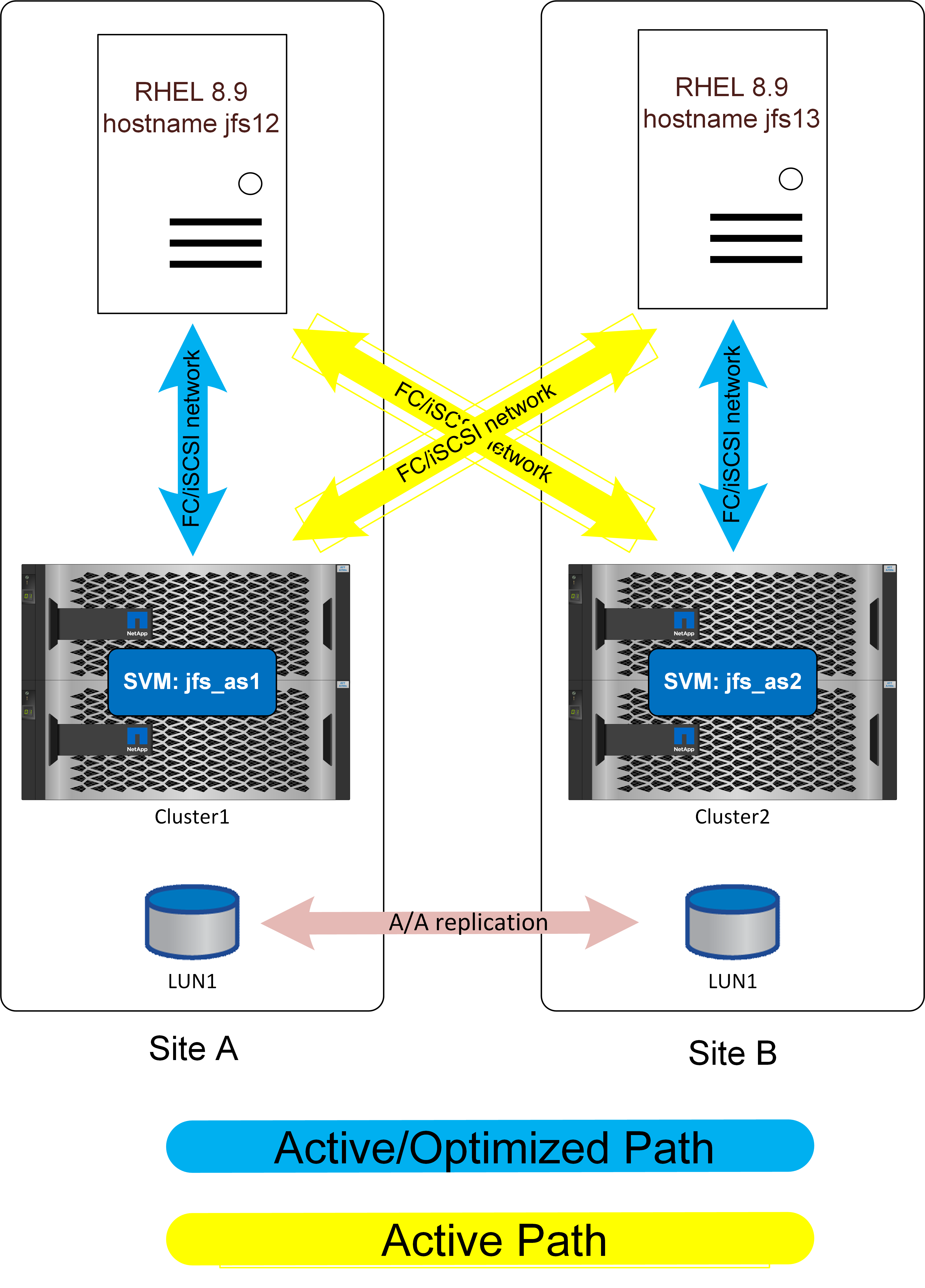

Uniform access with local proximity
Another feature of SM-as is the option to configure the storage systems know where the hosts are located. When you map the LUNs to a given host, you can indicate whether or not they are local to the storage system.
In normal operation, all IO is local IO. Reads and writes are serviced from the local storage array. Write IO will, of course, need to be replicated by the local controller to the remote system before being acknowledged, but all read IO will be serviced locally and will not incur extra latency by traversing the SAN.
The only time the nonoptimized paths will be used is when all active/optimized paths are lost. For example, if the entire array on site A lost power, the hosts at site A would still be operational, although they would be experiencing higher read latency.
Note: There are redundant paths through the local cluster that are not shown on these diagrams for the sake of simplicity. ONTAP storage systems are HA themselves, so a controller failure should not result in site failure. It should merely result in a change in which local paths are used by an affected host.

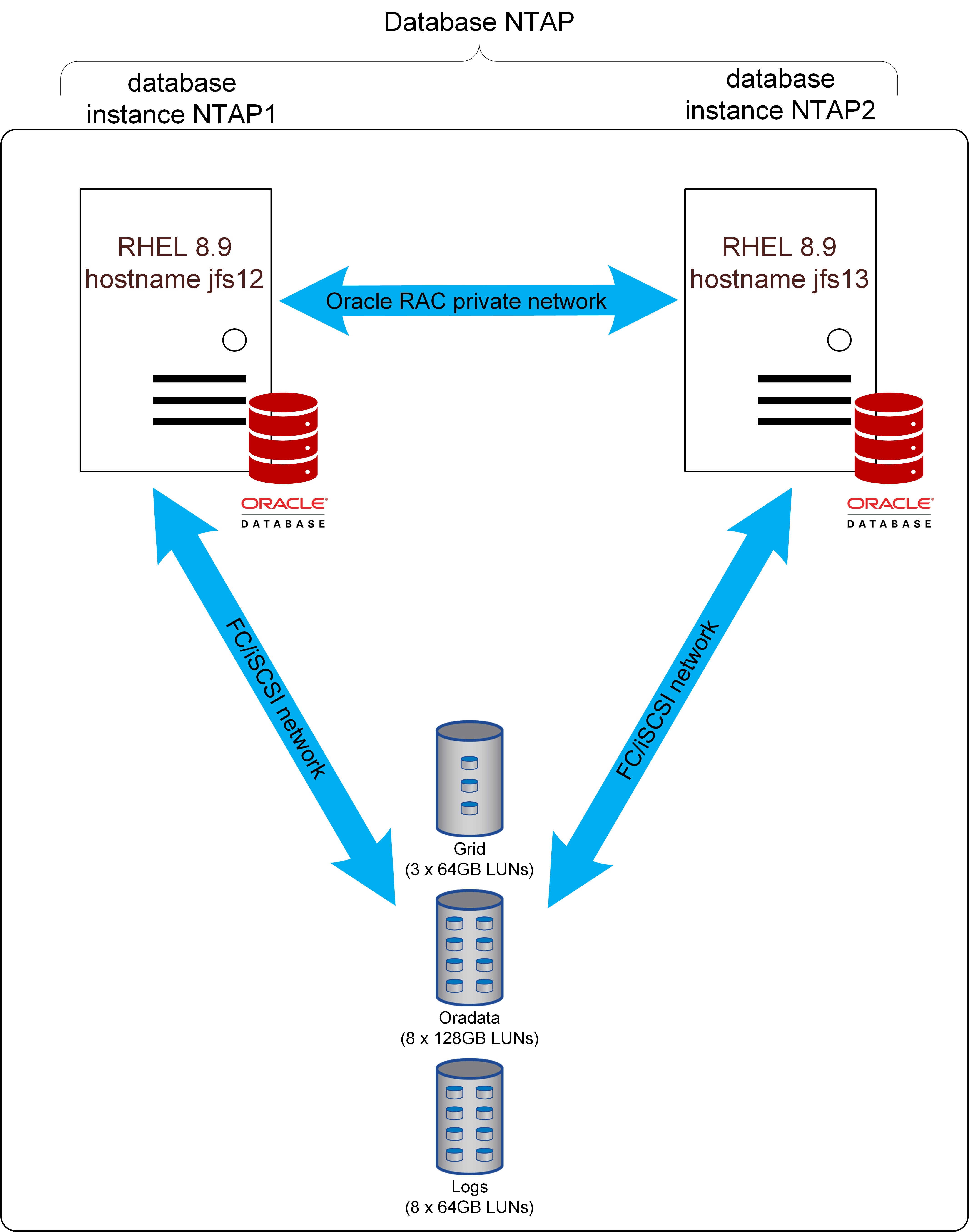

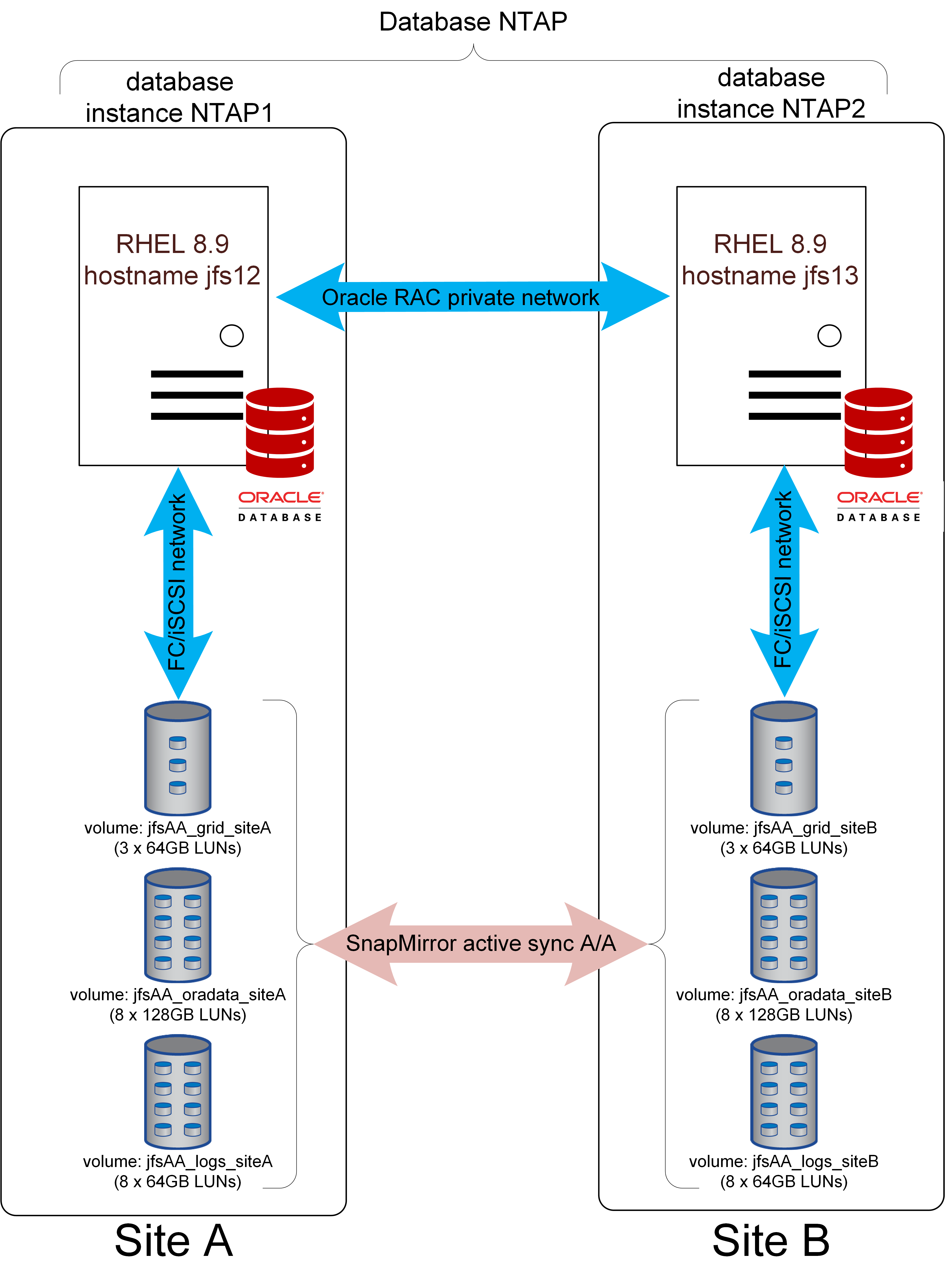

Although the following sections focus on an Oracle RAC configuration, the concepts are applicable to most any SnapMirror active sync deployment. Using Oracle RAC as an example is especially helpful because Oracle RAC is inherently complicated. If you understand how to configure and manage Oracle RAC on SM-as, including all the nuances, requirements, and especially the benefits ONTAP delivers for such a configuration, you’ll be able to use SM-as for any workload.

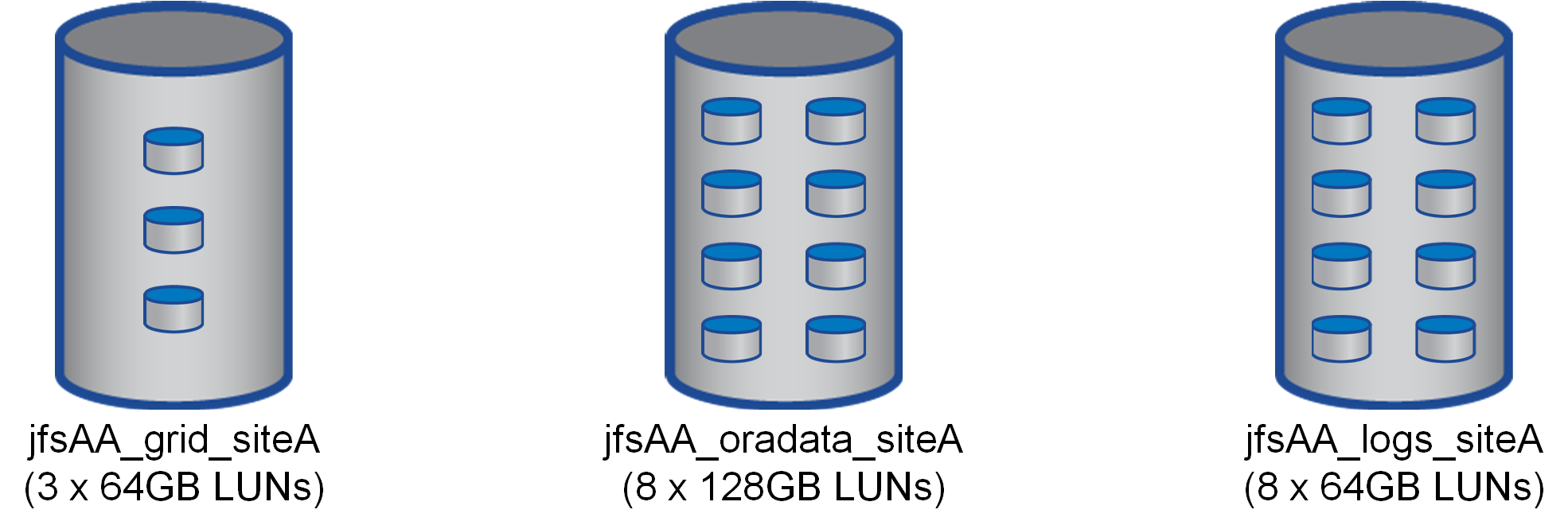

Confused? Here’s a diagram of my basic volume and LUN layout.
There is no true best practice for any database layout. The best option depends on what you want to do with the data. In this case, there are three volumes:
- One volume for the Oracle Grid management and quorum LUNs.
- One volume for the Oracle datafiles.
- One volume for the Oracle logs, and this includes redo logs, archive logs, and the controlfiles.
- LUN count for datafile IO of 8 LUNs. This isn't an ONTAP limitation, it's about the host OS. You need multiple LUNs to maximum SAN performance through the host IO stack. 4-8 LUNs is usuall required. The LUN count for logs and other sequentially accessed files is less important.
This design is all about manageability. For example, if you need to restore a database, the quickest way to do it would be to revert the state of the datafiles and then replay logs to the desired restore point. If you store the datafiles in a single volume, you can revert the state of that one volume to an earlier snapshot, but you need to ensure the log files are separated from datafiles. Otherwise, reverting the state of the datafiles would result in loss of archive log data that is critical for RPO=0 data recovery.
Likewise, this design allows you to manage performance more easily. You simply place a QoS limit on the datafile volume, rather than individual LUNs. As an aside, never place a QoS limit on a database transaction log because of the bursty nature of log IO. The average IO for transaction logs is usually fairly low, but the IO occurs in short bursts. If QoS engages during those bursts, the result will be significant performance damage. QoS is for datafiles only.

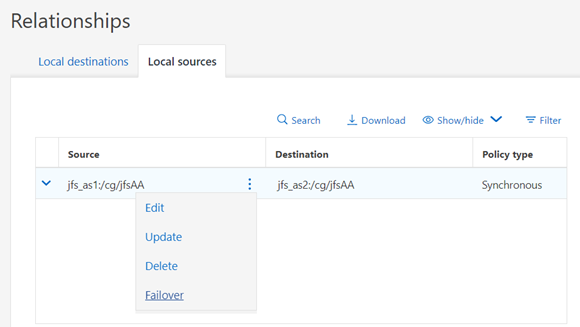

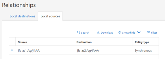

The following command creates an SnapMirror active sync relationship in active-active mode. This command is run on the uninitialized controller. SnapMirror is designed as a pull technology. For example, asynchronous SnapMirror updates pull new data from the source. It is not pushed from the source to a destination.
Cluster2::> snapmirror create -source-path jfs_as1:/cg/jfsAA -destination-path jfs_as2:/cg/jfsAA -cg-item-mappings jfsAA_grid_siteA:@jfsAA_grid_siteB,jfsAA_oradata_siteA:@jfsAA_oradata_siteB,jfsAA_logs_siteA:@jfsAA_logs_siteB -policy AutomatedFailOverDuplex
Operation succeeded: SnapMirror create for the relationship with destination "jfs_as2:/cg/jfsAA".
This operation makes a lot more sense if you see it in the GUI, but I can break down the command. Here’s what it does:
snapmirror create
That's self-evident. It's creating a snapmirror relationship.
Use a source of the SVM called jfs_as1 and the consistency group called jfsAA. You'll see this syntax elsewhere in the ONTAP CLI. A consistency group is denoted as [svm name]:/cg/[cg name].
Replicate that source CG called jfsAA to the SVM called jfs_as2 and use the same CG name of jfsAA
-cg-item-mappings \
jfsAA_grid_siteA:@jfsAA_grid_siteB, \
jfsAA_oradata_siteA:@jfsAA_oradata_siteB,\
jfsAA_logs_siteA:@jfsAA_log_siteB
This section controls the mapping of volumes to volumes. The syntax is [source volume]:@[destination volume]. I've mapped the source grid volume to the destination grid volume, oradata to oradata, and logs to logs. The only difference in the name is the suffix. I used a siteA and siteB suffix for the volumes to avoid user errors. If someone is performing management activities on the UI, using either SystemManager or the CLI, they should be readily able to tell whether they're working on the site A or site B system based on the suffix of the volume names.
The final argument specifies a snapmirror relationship of type AutomatedFailoverDuplex, which means bidirectional synchronous replication with automated failure detection. The relationship now exists, but it's not yet initialized. This requires the following command on the second cluster.

Failure scenarios
The following diagram shows the Oracle database and storage configuration as it exists at the hardware level (mediator not shown), and it is using a non-uniform network configuration. There is no SAN connectivity across sites.
I wrote above that I didn't need to configure host proximity. The reason is I'm using a nonuniform configuration. I have not stretched the SAN across sites. The only paths available to hosts are local paths. There's no reason to add host proximity settings because hosts will never be able to see storages paths to an opposite site. I included the instructions for configuring host proximity for readers who may be using uniform configurations and need to know how proximity settings are controlled.
Several of the scenarios described below that resulted in loss of database services would not have happened with a uniform network configuration. There is no cross-site SAN connectivity, so anything that results in the loss of active paths on a given site will mean there were no paths remaining at all. In a uniform network configuration, each site would be able to use alternate paths on the opposite site. The reason a non-uniform configuration was chosen for these tests was to illustrate that it is possible to have active-active RPO=0 replication without extending the SAN. It's a more demanding use case, and while it does have some limitations it also has benefits, such as a simpler SAN architecture.
There's another way to look at the storage architecture. The existence of replication is essentially invisible to the Oracle database and the RAC cluster. Various failure scenarios might result in disruption to certain database servers or the loss of certain paths, but as far as the database is concerned, there's just one set of LUNs. Logically, it looks like this:

SnapMirror active sync preferred site
At any given moment, SnapMirror active sync will consider one site the "source" and the other the "destination". This implies a one-way replication relationship, but that's not what's happening. This is how the preferred site is determined. If the replication link is lost, the LUN paths on the source will continue to serve data while the LUN paths on the destination will become unavailable until replication is reestablished and enters a synchronous state. The paths will then resume serving data.
My current configuration has site A as the preferred site for both Oracle and ONTAP. This can be viewed via SystemManager:
or at the CLI:
Cluster2::> snapmirror show -destination-path jfs_as2:/cg/jfsAA
Source Path: jfs_as1:/cg/jfsAA
Destination Path: jfs_as2:/cg/jfsAA
Relationship Type: XDP
Relationship Group Type: consistencygroup
SnapMirror Schedule: -
SnapMirror Policy Type: automated-failover-duplex
SnapMirror Policy: AutomatedFailOverDuplex
Mirror State: Snapmirrored
Relationship Status: InSync
The key is that the source is the SVM on cluster1. As mentioned above, the terms "source" and "destination" don't describe the flow of replicated data. Both sites can process a write and replicate it to the opposite site. In effect, both clusters are sources and destinations. The effect of designating one cluster as a source simply controls which cluster survives as a read-write storage system if the replication link is lost.
Loss of SnapMirror replication connectivity
If I cut the SM-as replication link, write IO cannot be completed because it would be impossible for a cluster to replicate changes to the opposite site. Here's what will happen with an Oracle RAC environment.
Site A
The result on site A of a replication link failure will be an approximately 15 second pause in write IO processing as ONTAP attempts to replicate writes before it determines that the replication link is genuinely inoperable. After the 15 seconds elapses, the ONTAP cluster on site A resumes read and write IO processing. The SAN paths will not change, and the LUNs will remain online.
Site B
Since site B is not the SnapMirror active sync preferred site, its LUN paths will become unavailable after about 15 seconds.

Cut the power to the mediator
The mediator service does not directly control storage operations. It functions as an alternate control path between clusters. It exists primarily to automate failover without the risk of a split-brain scenario. In normal operation, each cluster is replicating changes to its partner, and each cluster therefore can verify that the partner cluster is online and serving data. If the replication link failed, replication would cease.
The reason a mediator is required for safe automated operations is because it would otherwise be impossible for a storage clusters to be able to determine whether loss of bidirectional communication was the result of a network outage or actual storage failure.
The mediator provides an alternate path for each cluster to verify the health of its partner. The scenarios are as follows:
- If a cluster can contact its partner directly, replication services are operational. No action required.
- If a preferred site cannot contact its partner directly or via the mediator, it will assume the partner is either actually unavailable or was isolated and has taken its LUN paths offline. The preferred site will then proceed to release the RPO=0 state and continue processing both read and write IO.
- If a non-preferred site cannot contact its partner directly, but can contact it via the mediator, it will take its paths offline and await the return of the replication connection.
- If a non-preferred site cannot contact its partner directly or via an operational mediator, it will assume the partner is either actually unavailable or was isolated and has taken its LUN paths offline. The non-preferred site will then proceed to release the RPO=0 state and continue processing both read and write IO. It will assume the role of the replication source and will become the new preferred site.
If the mediator is wholly unavailable:
- Failure of replication services for any reason will result in the preferred site releasing the RPO=0 state and resuming read and write IO processing. The non-preferred site will take its paths offline.
- Failure of the preferred site will result in an outage because the non-preferred site will be unable to verify that the opposite site is truly offline and therefore it would not be safe for the nonpreferred site to resume services.

SnapMirror active sync failover
Changing the preferred site requires a simple operation. IO will pause for a second or two as authority over replication behavior switches between clusters, but IO is otherwise unaffected.
GUI example:
Example of changing it back via the CLI:

The new destination path can be verified as follows:
Cluster1::> snapmirror show -destination-path jfs_as1:/cg/jfsAA
Source Path: jfs_as2:/cg/jfsAA
Destination Path: jfs_as1:/cg/jfsAA
