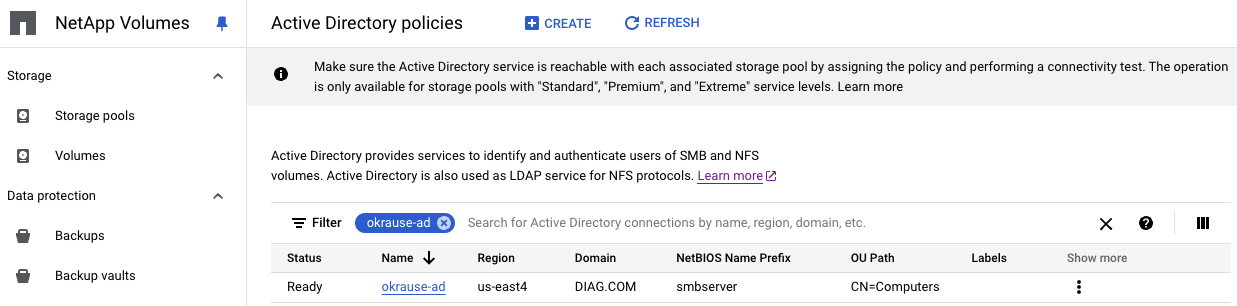

It all starts with creating an Active Directory policy. After we create the policy, a screen displays all our Active Directory policies.

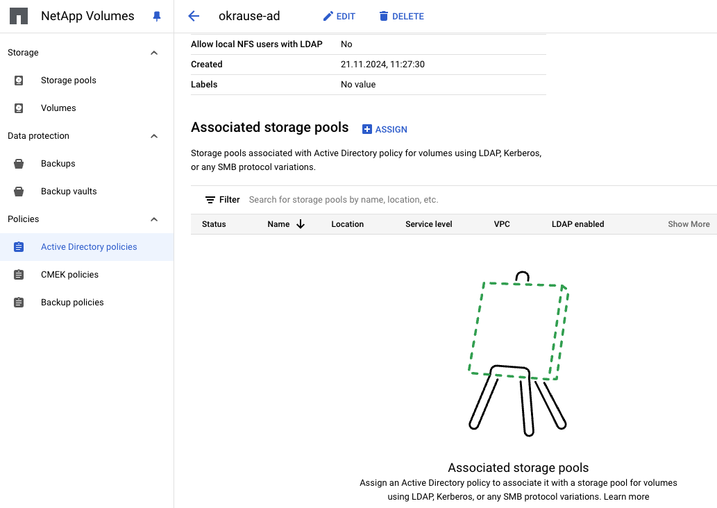

Clicking our policy opens the details screen, which adds the Associated Storage Pools heading:

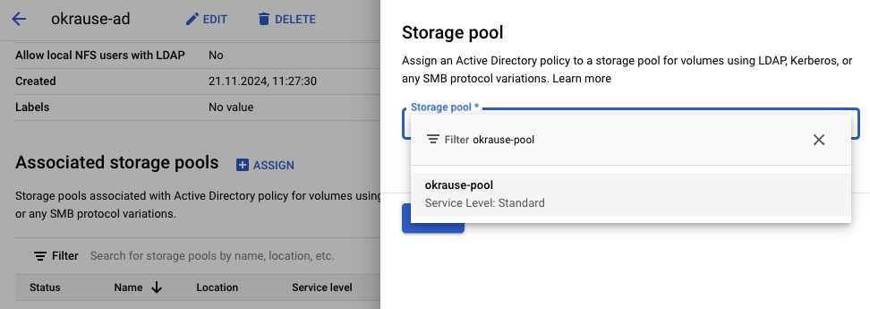

The screen shows that this policy isn’t currently being used by any storage pool, so let’s assign it to an existing storage pool. We can do this conveniently from the policy detail screen, or the classic way of editing the storage pool.

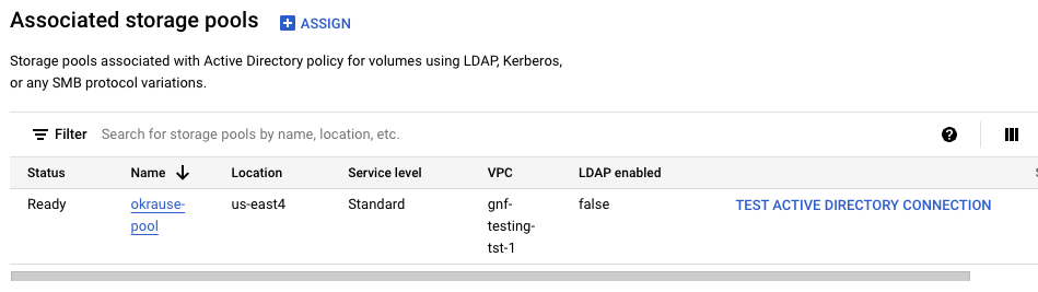

When we click the +Assign button to the right of Associated Storage Pools, a dialog box opens, allowing us to select a pool. Note that the dialog box shows only pools that have no policy attached and are in the same region as the policy:

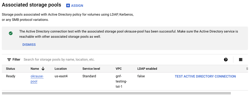

After we click Assign, the policy is now attached to the pool, and we get the option to run a test, using the Test Active Directory Connection button.
Connectivity tests are always triggered on a pool level. Different pools can connect to different networks (Virtual Private Clouds, or VPCs), and Active Directory might be reachable from one VPC but not from another. The storage pool is the construct that ties volumes, VPCs, and Active Directory policies together.

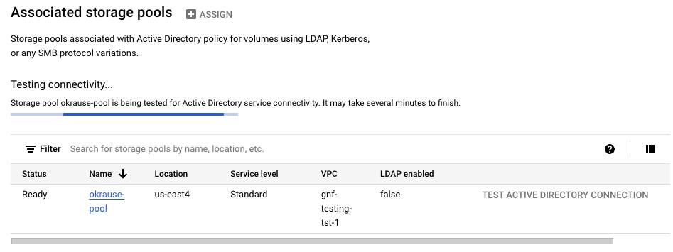

Let’s trigger a test by clicking Test Active Directory Connection:
The test runs for several minutes. Meanwhile, the Active Directory policy cannot be modified.

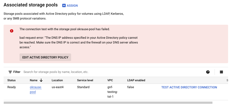

The main purpose of a connectivity test is to identify problems with Active Directory connections. Let’s intentionally put some bad data into the policy to showcase the iterative problem-solving process. The first problem we encounter is:
The test returns an error message specifying the problem. Here, NetApp Volumes fails to connect to the DNS server we specified. DNS plays a crucial role in Active Directory, because it makes heavy use of DNS-based service discovery to identify domain controllers that provide services like LDAP or Kerberos. A simple DNS query returns a list of domain controllers. For the service to join the domain, at least one of those domain controllers needs to be reachable.
In our example, we can’t reach the DNS server. There are three issues that could cause this problem:
- The specified server isn’t a DNS server.
- The server cannot be reached by NetApp Volumes due to routing issues. A common problem is nontransitive routing of VPC peering. NetApp Volumes is connected using VPC peering to our network. If all our domain controllers are in another network that’s connected to our network through VPC peering, the domain controllers are two VPC peering hops away from NetApp Volumes and traffic won’t get through. We need to move at least one domain controller into the network that the service is peered to.
- The DNS server has a firewall that doesn’t allow connections from NetApp Volumes. We need to open its firewall to traffic originating from NetApp Volumes.
For issues #2 and #3, we have to make changes to our infrastructure. After every change, we can retest to see if the change solves the problem. In this example, we simply specified the wrong DNS server IP address (issue #1). After editing the Active Directory policy and fixing the DNS IP, we’re ready for the next test run.

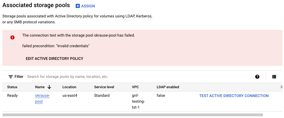

It fails again, but this time with a different error. So, we resolved the first problem, but now we encounter the next one. The new error says:
The error message says that the credentials to join the service to the domain are wrong. Although we still haven’t reached our goal, we made good progress. The service managed to use DNS-based discovery to find domain controllers. It also talked to the NetLogon service on one of the domain controllers, which means that routing and firewalls are good; we simply specified a wrong username or password. In this example, it’s just a typo in the password. After we edit the Active Directory policy and fix the password, the next connectivity test run is successful.
