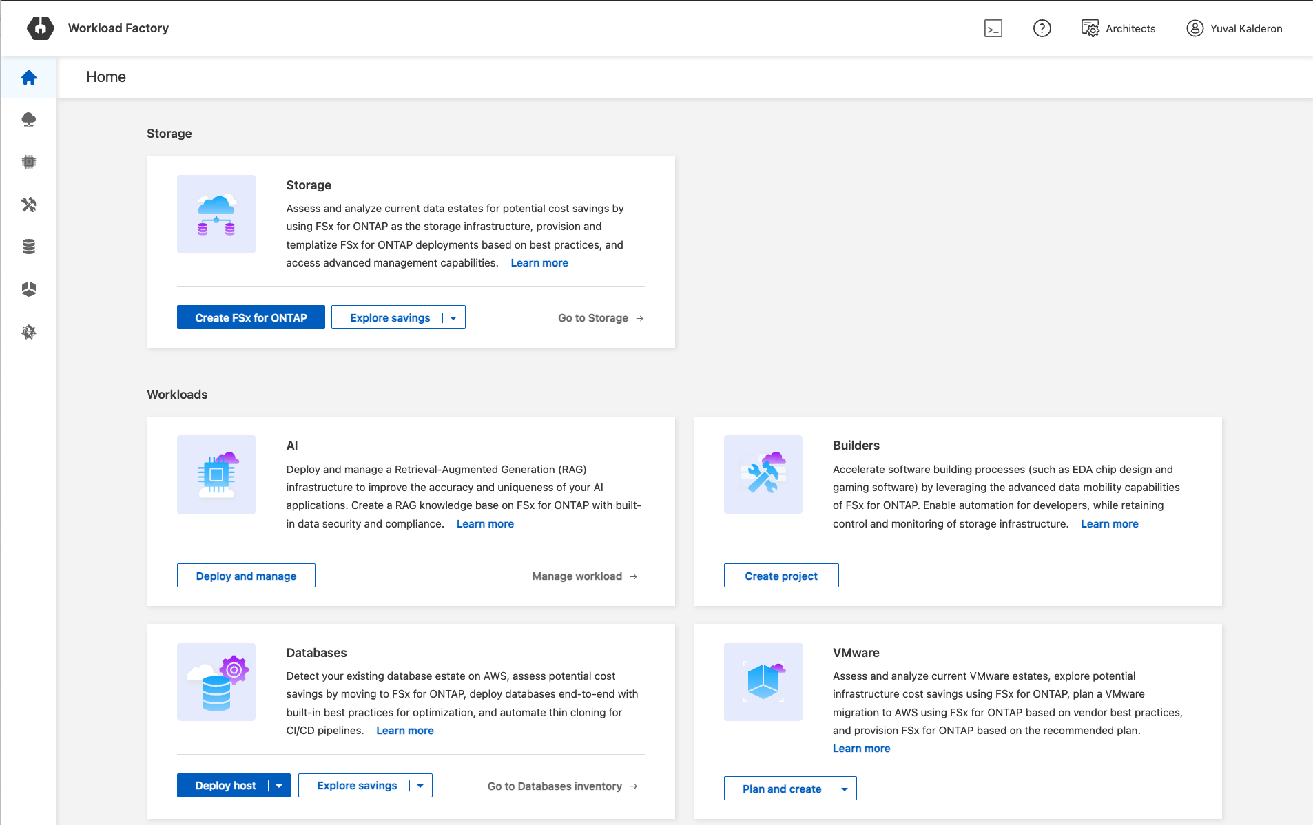

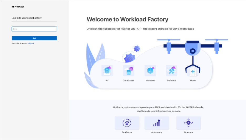

First, go to the workload factory home page. Log in with an existing workload factory account or sign up to create a new one.
Workload factory is used to deploy and manage a variety of different workloads. Workload factory GenAI is located in the AI section of the workload factory home page.
Go to the navigation menu on the left and select the GenAI icon (the chip shape).
Another way to do this is to select “Deploy & manage” from the options in the AI section of the workload factory homepage.
Read the Introduction on the next screen, then click "Get started" to deploy GenAI infrastructure.

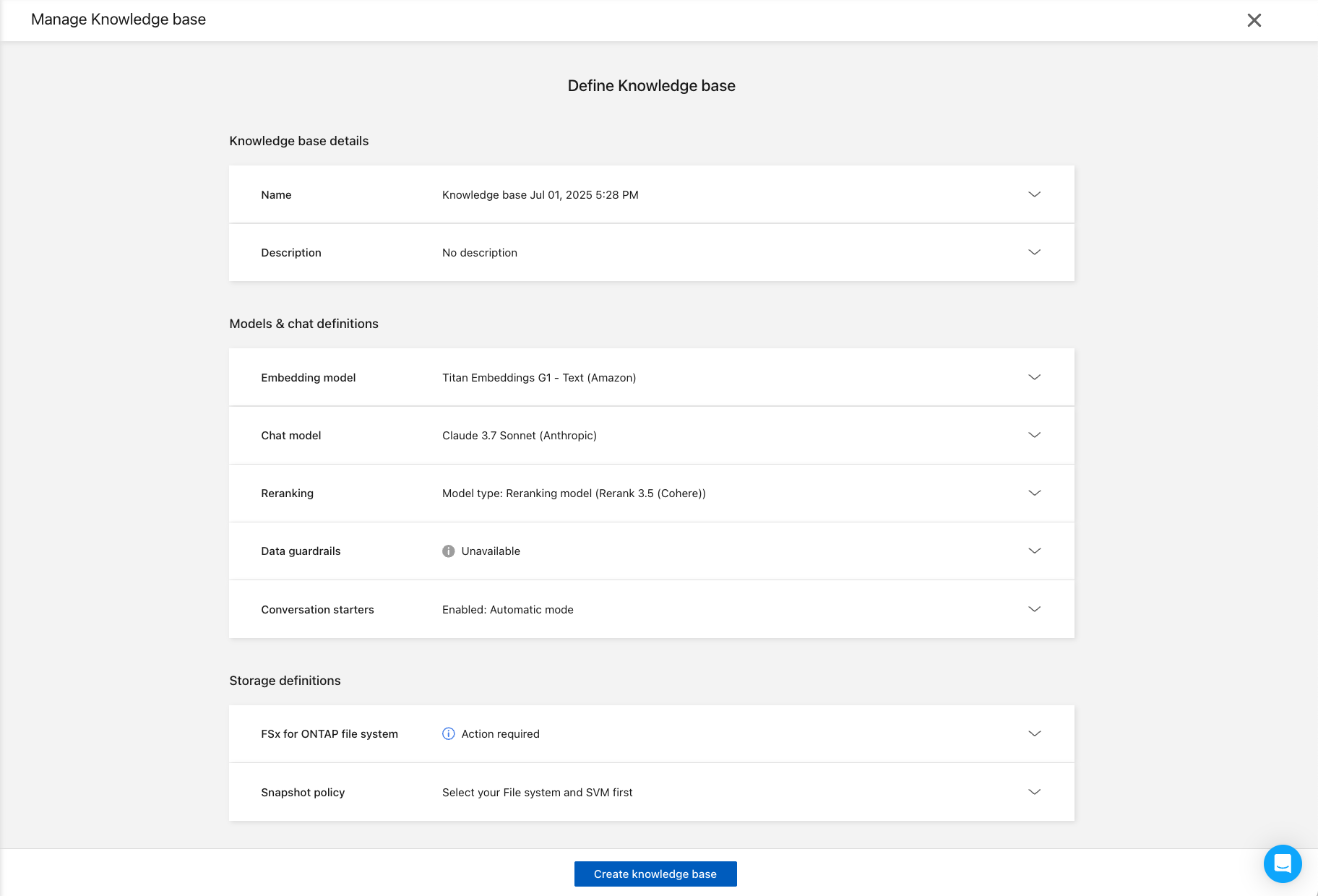

In the next screen you’ll be asked to define the details of your knowledge base.
You can leverage advance models from Amazon Bedrock as well as enable data guardrail to omit private information.
Click on each of the sections to configure the knowledge base. Here’s a look at each of them.
- First, you’re prompted to give your knowledge base a name.
- Next, provide a description of the knowledge base. This will help understand the data within the MCP server context.
- Now, define the embedding model the knowledge base will rely on.
- Next, add a Chat model.
- Next, Select your Reranking method and model
- Next, select if you would like to activate Data guardrails, conversation starters and define your storage destination and snapshot policy for your knowledge base.
Once you have all the correct information about the knowledge base entered, click the “Create Knowledge base” button.

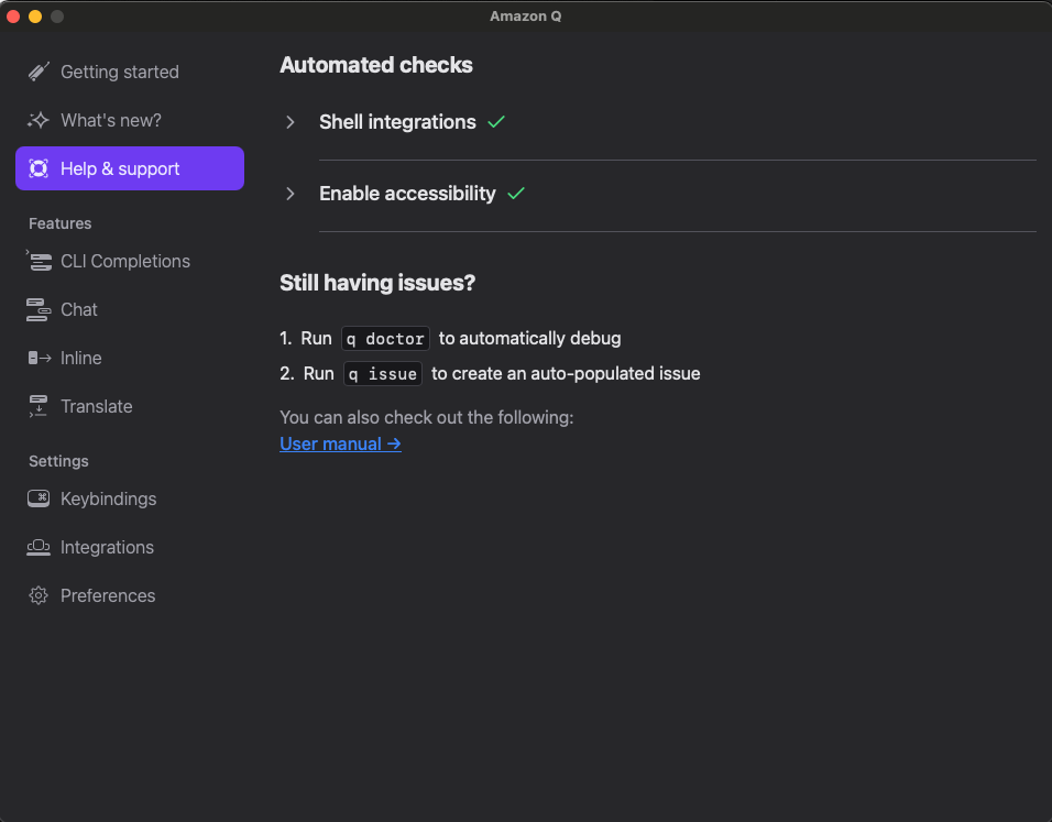

Step 5: Make sure the client is running on your workstation
After installing the client on the prerequisites make sure it’s running on your workstation. Get into settings and make sure everything is up and running.

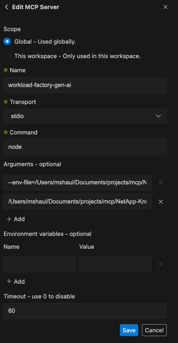

Step 6: Configure MCP server in Amazon Q Developer
Download and build the Workload Factory MCP server from here.
To configure the WF MCP server for Amazon Q you’ll need to edit this file on your workstation: ~/.aws/amazonq/mcp.json
The file should contain the MCP configuration JSON including the path to the server executable and the login parameters file (make sure you download and build it following the instructions in the prerequisites):
"mcpServers": {
"workload-factory-gen-ai": {
"command": "node",
"args": [
"--env-file=/projects/wlm-ai/mcp-server/config/config.env",
"/projects/wlm-ai/mcp-server/build/index.js"

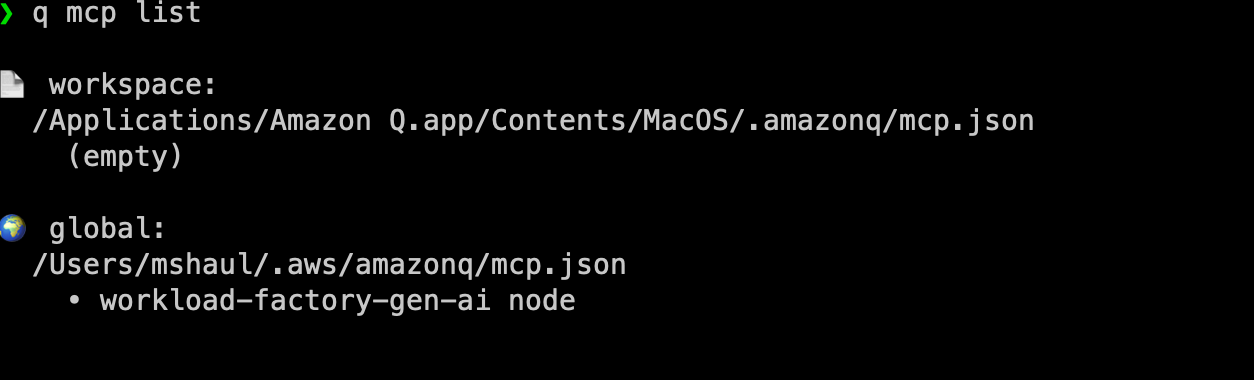

After you configure the server, you can verify the configuration using the following cli command;

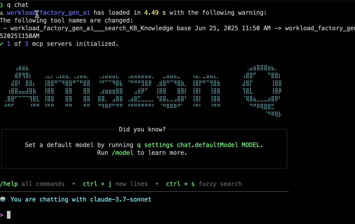

Step 7: Chat with Amazon Q CLI
You can start chatting with Q CLI by using the q chat cli command. Notice that when the chat loads it identifies the new MCP tool.
If you ask a question that will require usage of the Knowledge base data the Amazon Q agent will use the Workload Factory MCP tool to resolve it.

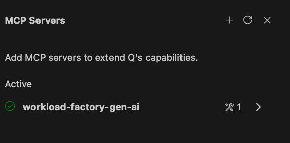

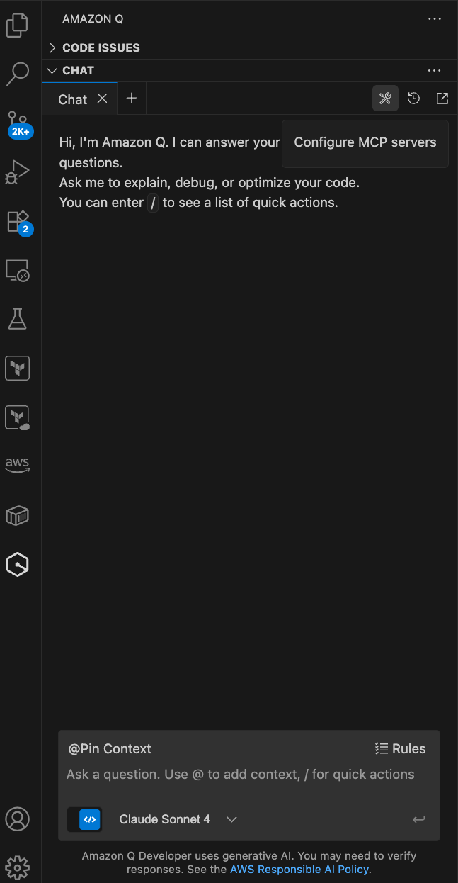

Load your VS Code IDE and make sure you installed the Amazon Q extension as required. Load the Amazon Q chat from the left side panel and select the Configure MCP Servers on the top left part of the chat.
Once you get into the MCP Server configurations you should see the Workload Factory MCP server we created on previous steps for the CLI. The Amazon Q extension already finds the configuration on the mcp.json file and loads it.
You should now be able to start working and chatting using the Workload Factory MCP tool. If you need to change the configuration you can do that from the Amazon Q extension by selecting on the configuration.

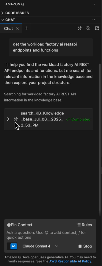

Step 9: Chat with Amazon Q Extension using Workload Factory MCP Server
Now you should be able to chat freely using the Amazon Q chat and retrieve data or create code parts based on the documentation you store on your FSxN file system. When the MCP tool is used the Amazon Q chat will prompt you about the usage.
