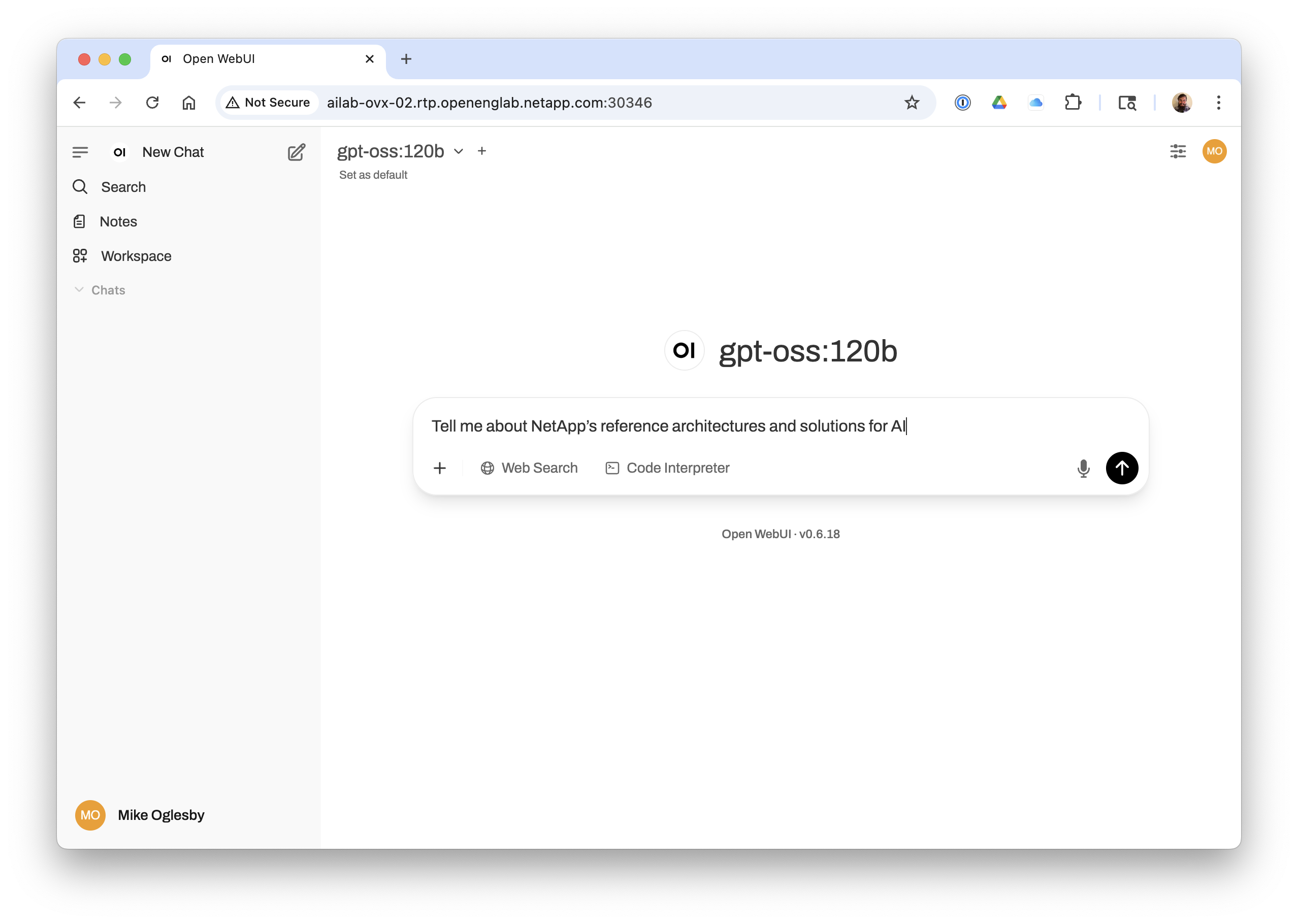

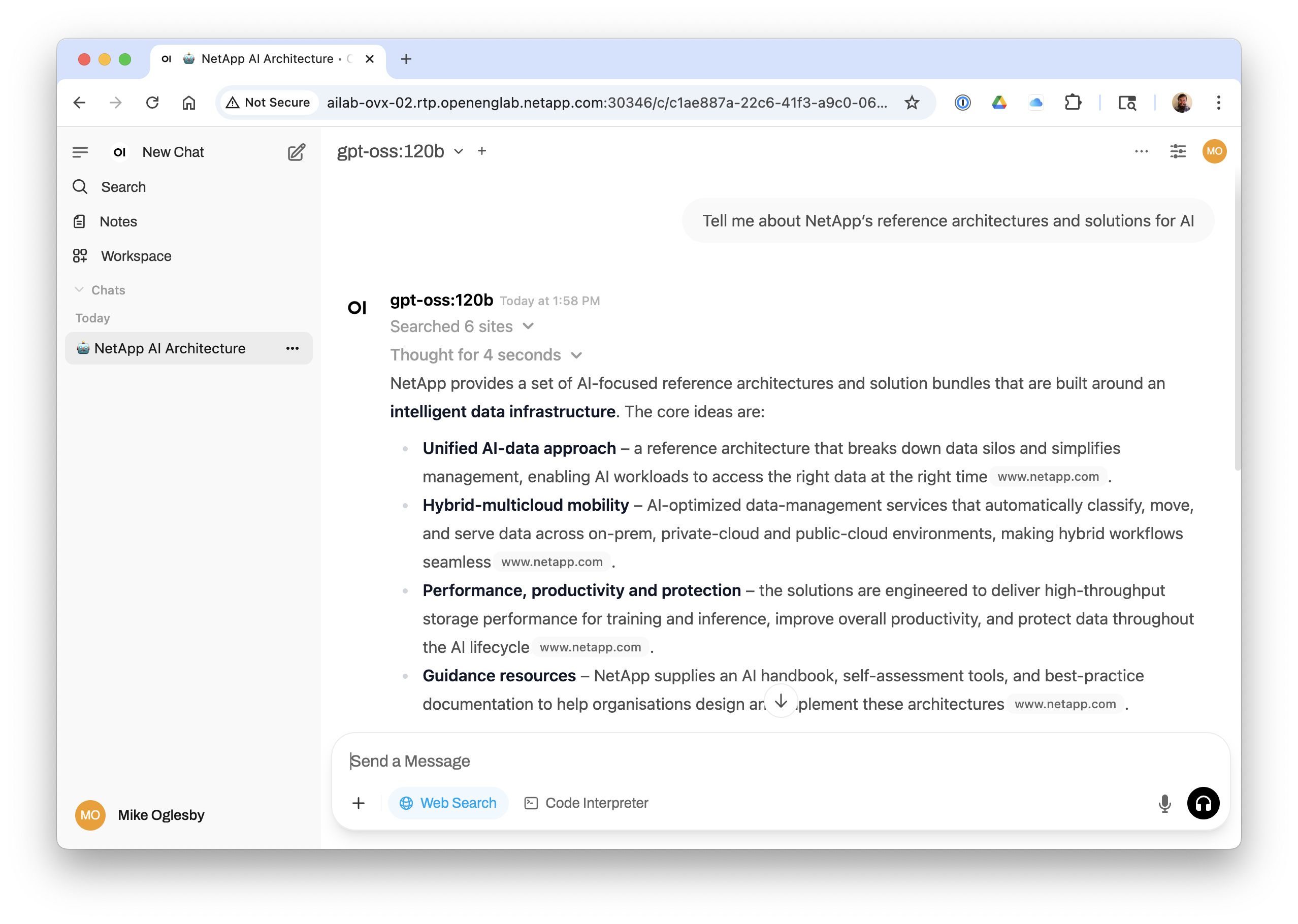

Access the Open WebUI application in your web browser using the URL that you noted down, and then step through the initial setup wizard. You now have your own private Chat UI with gpt-oss-120b!

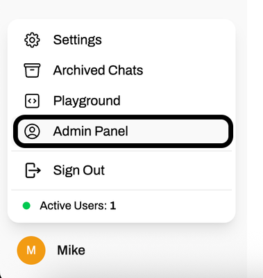

If you did not configure SSO integration in your open-webui-values.yaml file, as I did not in the preceding example, then you will need to create accounts for your users via the admin panel. To access the admin panel, click on your name in the bottom-left corner of the screen, and then click on 'Admin Panel.'

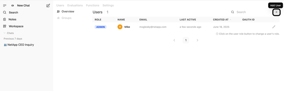

To add a user, click on the '+' icon in the top-right corner of the screen.

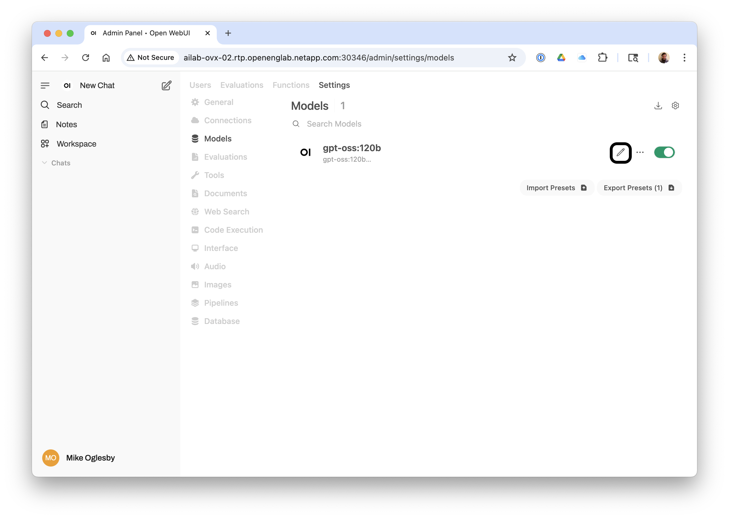

If you add additional users, you will want to make your model visible to all users. By default, the model is only visible to you, meaning that other users will have no model to chat with. To make the model visible to all users, access the admin panel, then click on 'Settings' in the navigation bar at the top of the screen, then click on 'Models' in the navigation panel on the left, and then click on the pencil icon next to your model.

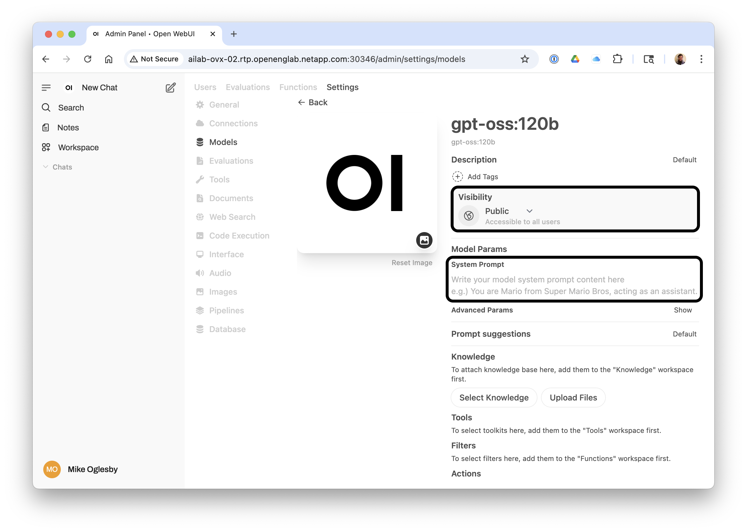

Once on the model settings page, click on 'Visibility,' and then choose 'Public' in the drop-down menu. You can also edit your system prompt if you desire to do so - this is a simple way to introduce basic guardrails.

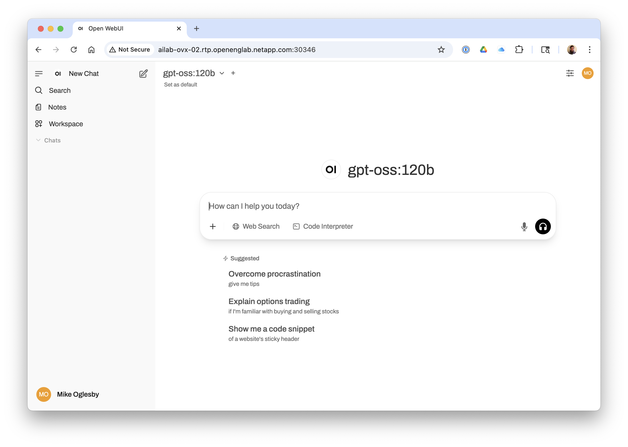

You and your users can now chat with gpt-oss-120b!
