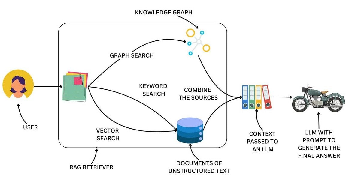

More Than the Sum Of The Parts
You can deploy graph and vector RAG independently or run them together when you need both explainability and broad semantic recall.
- Graph-first (no vector): Use a knowledge graph to extract entities/relations, carve a subgraph, and answer from that evidence. This excels in regulated Q&A, policies, and "show-your-work" workflows where provenance, time-scoping, and identity resolution matter.
- Vector-first (no graph): Use embeddings to recover paraphrases and fuzzy matches at speed. This is great for exploratory search, synonyms, and "find me similar" use cases where recall breadth beats precision.
- Hybrid: Let the graph gate the corpus (subgraph of interest), then invoke vector recall when the subgraph is sparse or confidence dips. Orchestrate a graph → vector → fuse pipeline: entity-link → subgraph → semantic recall → dedupe/score → constrained generation with PROV exports.
The strongest public signal that this hybrid approach works at scale comes from BlackRock and NVIDIA’s HybridRAG research paper. They pair graph traversals for grounded evidence with vector recall as a fallback, and report 96% factual faithfulness on financial-filings Q&A. The key idea is simple: let the graph carve a clean subgraph, then let vector search recover semantically similar snippets when the graph alone is too sparse. The result is high faithfulness and strong relevance in a domain where getting the answer wrong actually costs money. Below is a talk by Mitesh Pate, PhD at NVIDIA that was just published in July 2025 that explains this in further detail.
