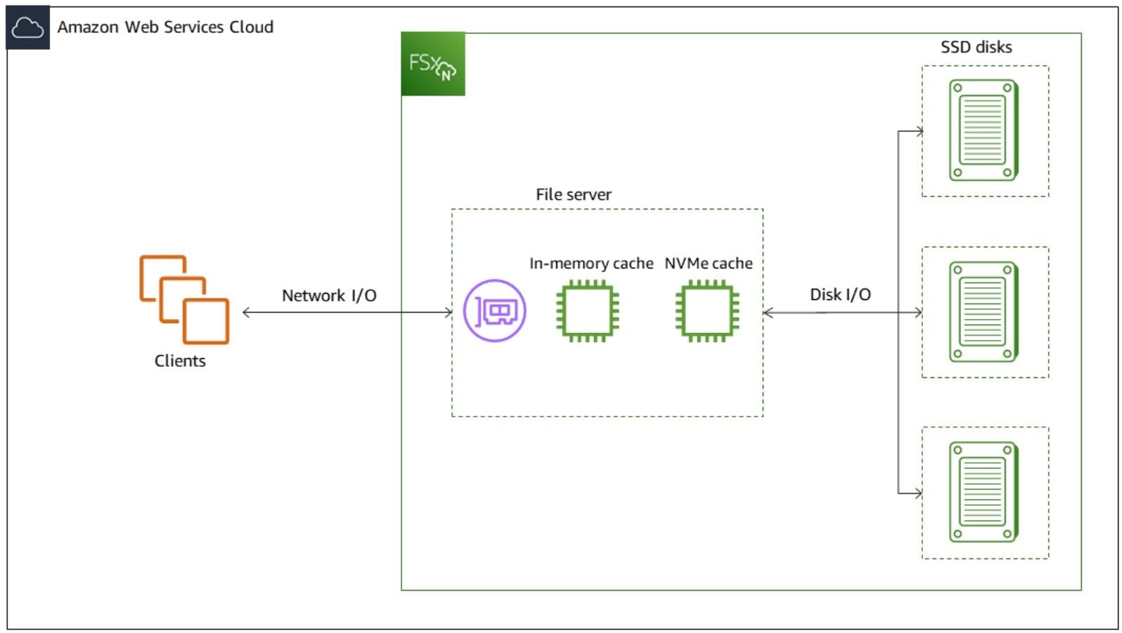

Performance influencers in FSx for ONTAP
The following picture is a basic representation of a client/server FSx for ONTAP infrastructure. It also shows the three key performance influencers: Network I/O, cache (in-memory and NVMe), and disk I/O. All three are determined by the throughput capacity of the file system chosen during the initial deployment.
Network I/O is the maximum throughput between the client and FSx for ONTAP, expressed in MBps. The network I/O value will be greater than whatever your disk I/O throughput maximum. For instance, a 512 MBps FSx for ONTAP can deliver up to 625 MBps network I/O.
Cache can come in two possible forms. All FSx for ONTAP throughput capacities have an in-memory cache for read workloads. Some of them also have an extension of the in-memory cache, based on NVMe. The greater the throughput selected, the greater the total cache size will be.
Disk I/O is the maximum throughput of the SSD tier, and it’s expressed with both disk MBps and disk Op/s. The chosen throughput capacity will determine the max MBps, while for Op/s there are other factors to consider. Let’s take a look at them.
