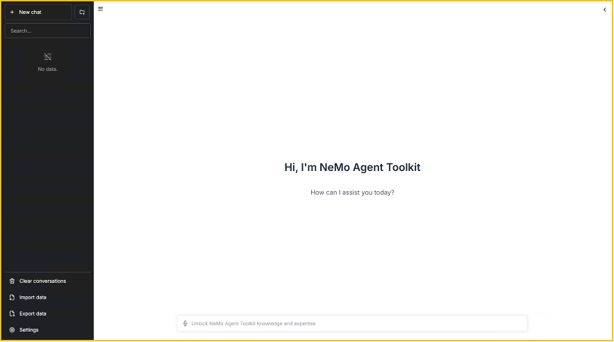

NeMo Agent Toolkit UI (Chatbot)
- Interact with the Agent:
In the chatbot interface, you can now use natural language to manage your ONTAP volumes.
