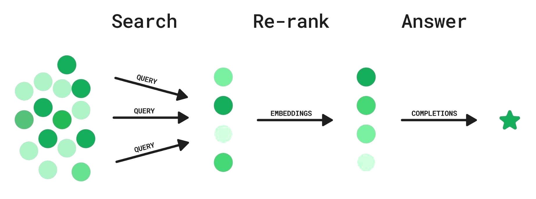

But how do these architectures win out in these categories over Vector-based RAG? These implementations address two fundamental concepts in the Retrieval portion of Retrieval Augmented Generation pipelines by providing flexibility at the cost of a user-provided implementation.
First, by taking control of the implementation details for the Retrieval step, you decide which documents to retrieve from the data store or database that houses the information. In a GraphRAG implementation, we call this retrieving a knowledge graph or a relevant subset of your dataset. You can retrieve as little or as much of the subset of data as needed. It could be a few documents or an entire book. You decide the "map" to find that data.
Second, you can rank the relevance of the paragraphs, chunks, documents, etc, retrieved to see which you want to deem most important in answering that question or ppl. If you had a crystal ball, a single document with the exact answer would be ideal, but in reality, it doesn't work that way. Luckily, in this architecture, you have control to help guide not only what is relevant, but also the importance of each item in your subset.
