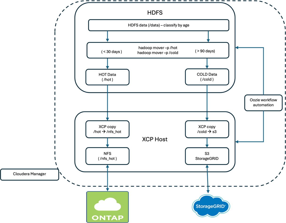

Architecture
Flow:
- Use Hadoop mover and tier storage policies to sort HDFS files by their modified time (age), placing them into either /hot or /cold directories.
- Employ XCP to transfer data: move files from /hot to NetApp NFS, and files from /cold to NetApp S3.
- Perform XCP verification to ensure data integrity at both destinations.
