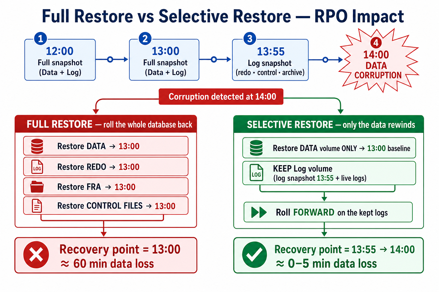

Corruption strikes at 14:00. Your snapshots are: 12:00 and 13:00 whole snapshots, plus a more frequent log snapshot at 13:55.
- Traditional / whole restore: the newest complete image is 13:00. You restore DATA + REDO + control + FRA together → the database is back, but rewound to 13:00 = ~60 minutes of committed business lost.
- Selective datafile restore: restore only the datafiles to the 13:00 baseline, keep the redo/control/archive (snapshotted at 13:55 and live), and roll forward → recovery point = 13:55 (and onward), ~5 minutes lost instead of 60.
Same storage, same snapshots — a 12× better RPO purely from what you choose to restore.

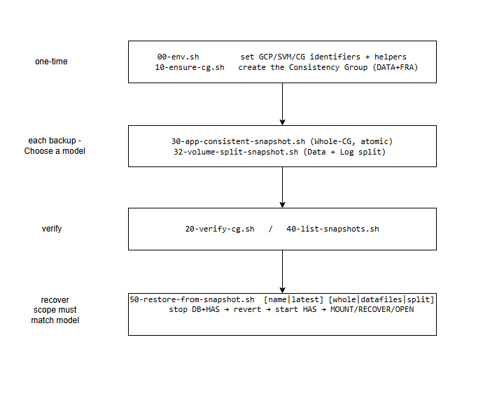

Whole-CG | One atomic CG snapshot of DATA + LOG together | 50-restore-from-snapshot.sh [name|latest] [scope] Scope=whole — CG revert to that exact point | 30-app-consistent-snapshot.sh |
Volume-split | Separate per-volume snapshots of DATA and LOG | Scope=datafiles (roll-forward) Scope=split (point-in-time) | 32-volume-split-snapshot.sh |

The workflow at a glance
Use the sample scripts: https://github.com/NetApp/oracle-gcnv-consistent-snapshots/tree/main/scripts
Execution guide: https://github.com/NetApp/oracle-gcnv-consistent-snapshots/blob/main/README.md
