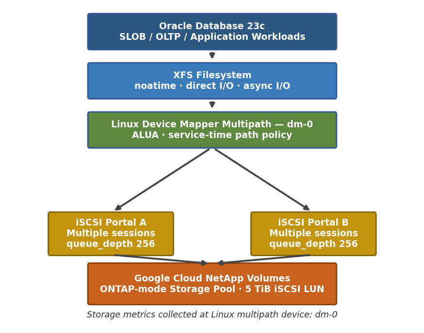

Figure 1 shows the Oracle over GCNV iSCSI I/O path.
End-to-end performance depends on every layer in this stack. Oracle issues physical I/O to datafiles on XFS; the filesystem passes I/O to a single multipath device that aggregates parallel iSCSI sessions across two portals; GCNV serves the LUN from an ONTAP-mode pool. Bottlenecks in any layer—cache, path count, queue depth, or ALUA policy—will show up in the results if not addressed.
Figure 1 — Oracle over GCNV iSCSI I/O Path
All storage performance metrics in this article were collected at the Linux multipath device layer: dm-0. (dm-0 is the Linux multipath disk device that Oracle uses for datafile I/O. It is used to measure and to report the IOPS and latency GCNV actually delivered to the host)
Reporting at dm-0 ensures the numbers represent what the array actually delivered to the host, independent of Oracle buffer cache or Oracle Automatic Workload repository (AWR) block accounting.
