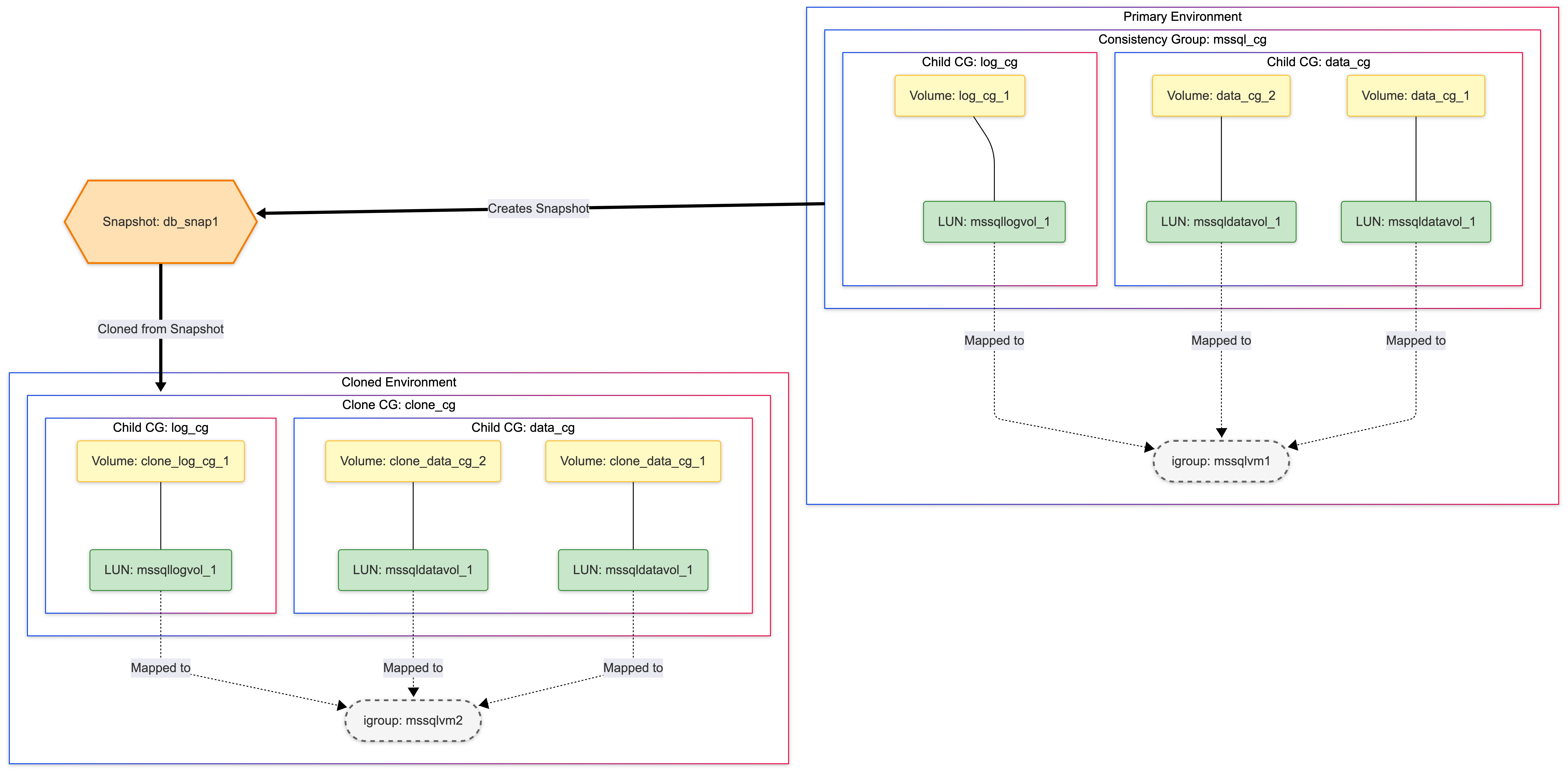

Architecture at a glance
The parent CG (mssql_cg) groups child CGs for data and logs. Production LUNs are presented to mssqlvm1. A CG snapshot captures the database consistently, and a CG clone (clonecg) can be mapped to mssqlvm2 for isolated testing or refresh.
The commands below follow this flow step by step.

4. Create a parent CG (Nested CG)
This is what makes CGs powerful for real applications — protect data and log as a single atomic unit, but keep the ability to manage them independently when you need to.
[demo@demovm]:~$ gcloud netapp storage-pools execute ontapmodepool --location=us-central1-a "consistency-group create -vserver gcnv-bc2553acb2200f4-svm-01 -consistency-group mssql_cg -consistency-groups data_cg,log_cg"
output: ''
[demo@demovm]:~$ gcloud netapp storage-pools execute ontapmodepool --location=us-central1-a "consistency-group show -consistency-group mssql_cg"
output: |+
(vserver consistency-group show)
Parent
Consistency Consistency
Vserver Group Group State Size Available Used
gcnv-bc2553acb2200f4-svm-01 mssql_cg - online 123.6GB 123.6GB 992KB
[demo@demovm]:~$ gcloud netapp storage-pools execute ontapmodepool --location=us-central1-a "consistency-group show -fields parent-consistency-group"
output: |+
vserver consistency-group parent-consistency-group
gcnv-bc2553acb2200f4-svm-01 data_cg mssql_cg
gcnv-bc2553acb2200f4-svm-01 log_cg mssql_cg
3 entries were displayed.
[demo@demovm]:~$ At this point the SQL Server VM can discover the iSCSI LUNs, initialize them in Windows, and the DBA can place data files and log files on the respective volumes.

6. Clone the database
This is the moment that typically changes how customers think about Dev/Test refresh. This creates a space efficient writable copy of the database that can be used for Dev/Test workflows.
[demo@demovm]:~$ gcloud netapp storage-pools execute ontapmodepool --location=us-central1-a "consistency-group clone create -vserver gcnv-bc2553acb2200f4-svm-01 -clone-consistency-group clonecg -source-snapshot-name mssql_snap1 -source-parent-consistency-group mssql_cg"
output: ''
output: |+
gcnv-bc2553acb2200f4-svm-01 clonecg -
gcnv-bc2553acb2200f4-svm-01 data_cg clonecg
gcnv-bc2553acb2200f4-svm-01 log_cg clonecg
6 entries were displayed.
[demo@demovm]:~$ gcloud netapp storage-pools execute ontapmodepool --location=us-central1-a "lun show"
output: |+
Vserver Path State Mapped Type Size
gcnv-bc2553acb2200f4-svm-01 /vol/clonecg_data_cg_1/mssqldatavol_1 online unmapped windows 50GB
gcnv-bc2553acb2200f4-svm-01 /vol/clonecg_data_cg_2/mssqldatavol_1 online unmapped windows 50GB
gcnv-bc2553acb2200f4-svm-01 /vol/clonecg_log_cg_1/mssqllogvol_1 online unmapped windows 20GB
gcnv-bc2553acb2200f4-svm-01 /vol/data_cg_1/mssqldatavol_1 online mapped windows 50GB
gcnv-bc2553acb2200f4-svm-01 /vol/data_cg_2/mssqldatavol_1 online mapped windows 50GB
gcnv-bc2553acb2200f4-svm-01 /vol/log_cg_1/mssqllogvol_1 online mapped windows 20GB
[demo@demovm]:~$
The clone is created in seconds, regardless of database size, and consumes no additional capacity until it diverges from the source.

You now have a point-in-time, fully writable, isolated copy of production running on a separate VM — with zero impact on the source database.
