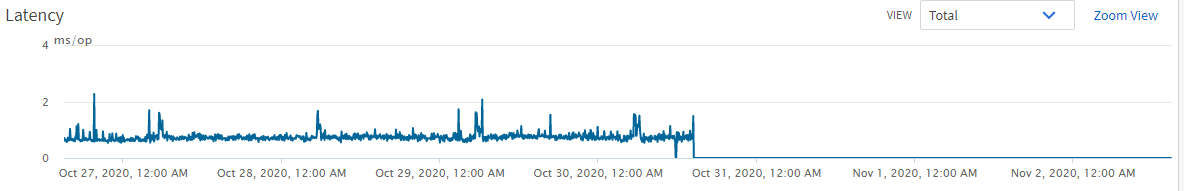

Hello,
A few days ago we suddenly stopped getting performance data for the volumes on a cluster mode NetApp:
We can see the performance data on the ONTAP system manager, but not on Active IQ.
It it worth mentioning that we also have an issue with NAbox for this NetApp, the harvest just fails with an exit code that might indicate a division by zero.
Do you have any suggestions on what might cause this behavior?
Active IQ version 9.7P1
ONTAP version 9.7
Thanks.
