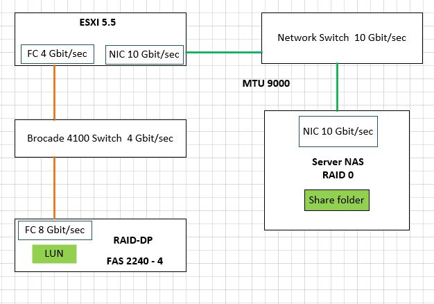

FAS 2240-4 NetApp Release 8.2.4P6 7-Mode 24*1TB-SATA-Disks, FС 8G
Tell me where is the bottleneck for reading.
Netapp disk system reads a maximum of 200 mb / s
I copy a large zip file of 90 gigabytes, a compressed backup copy of the database.
Copying from LUN on fiber channel 4gbit and further on the local network 10 gigabits to a RAID 0 server
I would like to have a speed of ~ 300 mb / s
The disk system cannot handle writing, it shows sysstat well, but I don’t see any bottlenecks with reading
NVRAM bottleneck ???

What are the specs of the server that's connected at 10Gb?  is it a comparable generation to the 2240?
Be sure that you're comparing apples to apples as best you can and not apples to oranges.
bgp
37,933 Views
ibm system x3650 m2 7947 and  ibm system x3650 m3

bgp
37,896 Views
The NAS Synology RS820+  server for tests was built on it RAID0, the local network 10G was checked all well.
I don't compare RAID-DP with RAID0, my task is to copy the backup copy from RAID DP to another server as quickly as possible.
I understand that SATA disks are slow to write and I understand this well and see the sysstat utility, but I do not see the sysstat read delay counters, the CP ty column does not show this.
fixed the schema

The entire chain was tested without Netapp speed   ~ 350 - 400 mb / s
I made a large ram disk (100gigabyte) in a virtual machine and copy speed ~ 400 mb / s along this chain
We still have a shelf 4243 SAS disks 15000 rpm 300 GB x 24, they work on reading 300 MB / s, which is also not very fast
