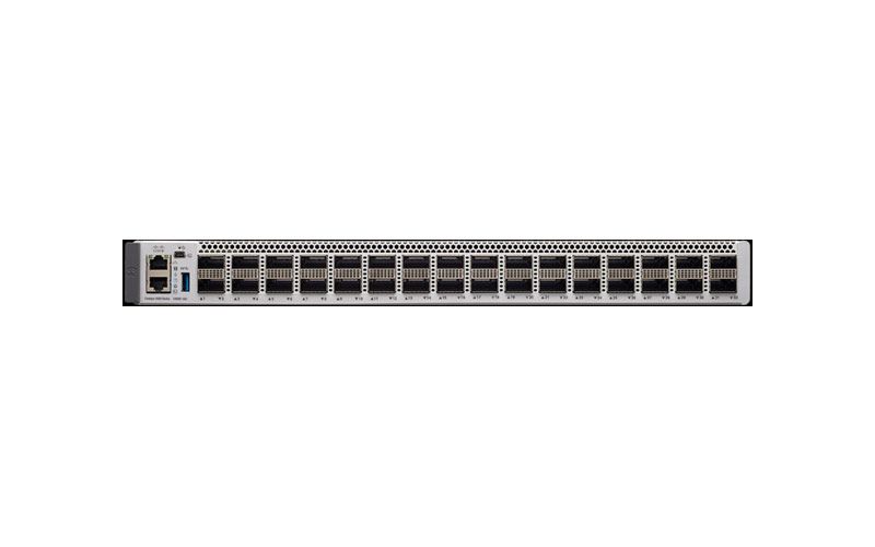

Issue Overview:
We recently deployed a NetApp AFF C800 system with two network cards installed in slots 3 and 5. For connectivity, we are using the NetApp X66211B-5-C 5m QSFP28 Direct Attach Copper (DAC) Cable. However, when connecting this cable to a Cisco Catalyst 9500-32C (Q32) switch, we receive the error:
🚨 "Cable unsupported" 🚨
Questions & Challenges:
  1. How can we resolve this compatibility issue?
  2. Is there a site or tool to compare compatibility between NetApp and Cisco switches?
  3. How can we verify if the NetApp X66211B-5-C cable is compatible with the Cisco 9500 Q32 or other Cisco switches?
note:
Cisco 9500 switch is running the latest firmware

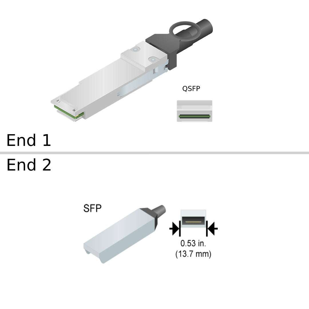

The X66211B-5-C cable is a standards-based 5m 100GBASE-CR4 cable that we have formally tested with our hardware products. It is known to interoperate well with many switch vendor products.
