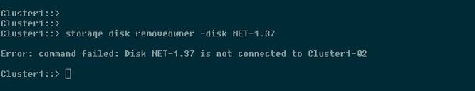

Can you check storage disk show -ownership output?
Also, can you attempt to remove ownership "storage disk removeowner -disk <disk ID>"

WDaniel
7,123 Views
I attached the output showing node 2 owns the disks that are unknown. you can see that in the first image I originally attached too. But the image above shows that the disk is just not responding as connected.
