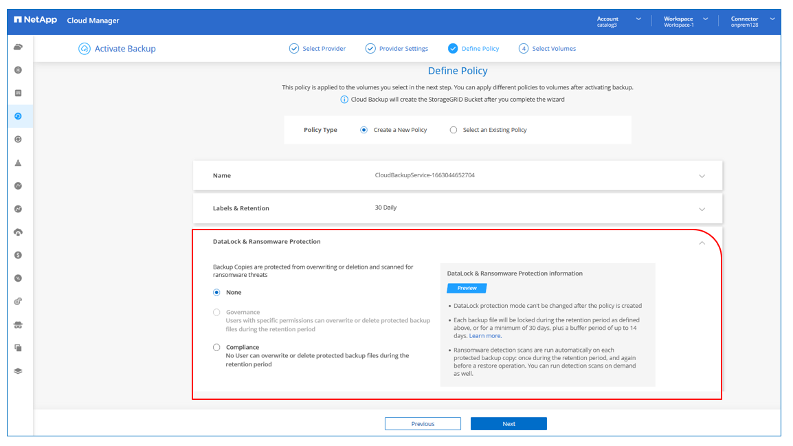

How do I enable DataLock and Ransomware Protection?
To enable DataLock and Ransomware Protection, we have to choose the mode as “Compliance” under the “DataLock and Ransomware Protection” section of the “Define Policy” UI of the “Activate Backup for Working Environment” wizard as shown below. With “Compliance” mode, no users can overwrite or delete protected backup files during the retention period.
Please Note:- The StorageGRID S3 Object Lock feature provides a single DataLock mode that is equivalent to Compliance mode. An equivalent Governance mode is not supported, so no users have the capability to bypass retention settings, overwrite protected backups, or delete backups. Hence the "Governance" mode is not available with the DataLock and Ransomware Protection support for StorageGRID. The "Governance" option on the Policy UI will be disabled for StorageGRID.
Important:-
- Make sure that the “DataLock and Ransomware Protection” is set while enabling the Cloud Backup service on the Working Environments.
- Please note that if you miss setting the “DataLock and Ransomware Protection” while enabling the Cloud Backup service on the Working Environments, you will not be able to enable the feature thereafter.
- DataLock protection mode cannot be changed to normal after the policy is created.
- Disabling or modifying DataLock and Ransomware Protection feature is not possible.
When “DataLock and Ransomware Protection” is enabled, the StorageGRID bucket that will be provisioned as a part of the backup activation process will have object locking and object versioning enabled. It will also have Auto-purging of non-current versions on the bucket will be enabled and set to 1 day.

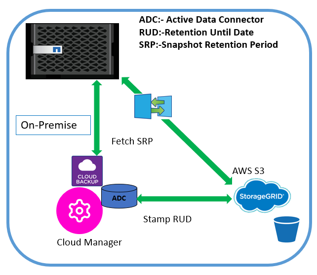

To lock an object, cloud providers provide a way to set the ‘Retention Until Date’ (RUD which is calculated based on the Snapshot Retention Period) in the object metadata during which the object version cannot be deleted or overwritten.
What is Snapshot Retention Period (SRP) and how is it calculated?
When “DataLock and Ransomware Protection” is enabled through the Cloud Backup policy, the Snapshot Retention Period’(SRP) is calculated as per the label and retention count defined by the user in the Cloud Backup policy.
The minimum SRP that will be assigned would be 30 days.
Let's try to understand how the Snapshot Retention Period (SRP) is calculated:
- If the user chooses the Daily label with Retention Count 20 ( The SRP is 20 days which defaults to 30 days.)
- If the user chooses the Weekly label with Retention Count 4 (The SRP is 28 days which defaults to 30 days.)
- If the user chooses the Monthly label with Retention Count 3 (The SRP is 90 days)
- If the user chooses the Yearly label with Retention Count 1 (The SRP is 365 days)
DataLock on an object is set by applying a retention period to an object version explicitly by specifying a “Retain Until Date or RUD” for the object version. Amazon S3 stores the Retain Until Date setting in the object version's metadata and protects the object version until the retention period expires.
What is Retention Until Date (RUD) and how is it calculated?
- The 'Retention Until Date' (RUD) is computed based on the SRP which is recorded in the metadata of the object while transferring using SM-C.
- The 'Retention Until Date’ (RUD) is calculated by summing the SRP and the Buffer.
- Buffer = Buffer for Transfer Time (6 days) + Buffer for Cost Optimization (8 days). Buffer is set as 14 days.
- Minimum RUD will be 30 days + 14 days
Example:-
- If you create a Monthly backup schedule with 12 retentions, your backups are locked for 12 months (plus 14 days) before they are deleted (replaced by the next backup file).
- If you create a backup policy that creates 30 daily, 7 weekly, 12 monthly backups there will be three locked retention periods. The "30 daily" backups would be retained for 44 days (30 days plus 14 days buffer), the "7 weekly" backups would be retained for 9 weeks (7 weeks plus 14 days), and the "12 monthly" backups would be retained for 12 months (plus 14 days).
- If you create an Hourly backup schedule with 24 retentions, you’d think that Backups are locked for 24 hours. However, since that is less than the minimum of 30 days, each backup will be locked and retained for 44 days (30 days plus 14 days buffer).
Please Note:-
- Be aware that old backups are deleted after the DataLock Retention Period expires, not after the backup policy retention period.
- The DataLock retention setting overrides the policy retention setting from your backup policy. This could affect your storage costs as your backup files will be saved in the object store for a longer period of time.
How do we set Retention Until Date (RUD) on the cloud backups?
- Cloud Backup uses the snapshot list REST API in Active Data Connector (ADC) to determine all the snapshots that are yet to be locked based on the SnapMirror Policy.
- For each of these snapshots, it uses ADC to stamp the RUD in all the objects belonging to the snapshot. This guarantees that the snapshot is locked until the RUD expires.

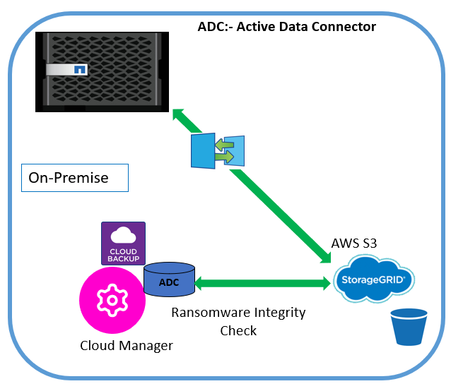

How does Ransomware Protection Work?
Ransomware Scan
In this section, we will examine how Ransomware detection scans are run by Cloud Backup. As soon as you enable Cloud Backup in the Working environment and configure "DataLock and Ransomware Protection," the ransomware scans are initiated. The Ransomeware scans are run in the below-mentioned scenarios.
- The scans on the cloud backup objects are initiated soon after they are transferred to the cloud object store. The scan is not performed on the backup file when it is first written to cloud storage, but when the next backup file is written
- The Ransomware Scans can be initiated when the backup is selected for the restore process.
- The scan can also be done on-demand as required by the user.
How does the scan work?
Now let's try to understand how the Ransomware scans work.
- Before the Ransomware scans are initiated, Cloud Backup checks to make sure that the snapshot is stamped.
- Cloud backup employs the Active Data Connector Integrity Checker REST API to start Ransomware scanning as necessary.
- The detection of ransomware attacks is performed using checksum comparison.
- The Active Data Connector Integrity Checker REST API triggers a Ransomware scan of the cloud backup objects on the cloud object store by verifying the checksum of the different backup object versions.
- Based on the result of the scan Cloud Backup initiates the recovery process.
Snapshots can be scanned on an on-demand basis for any ransomware attacks if necessary.
