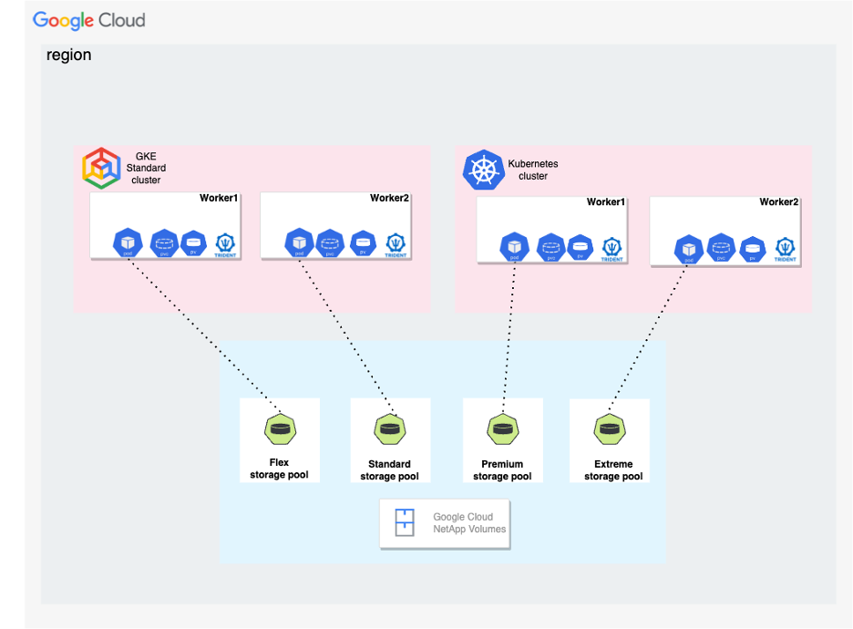

Great news! NetApp® Trident™ software is now generally available (GA) with Google Cloud NetApp Volumes. This means you can use the same Trident Container Storage Interface (CSI) provisioner you know and love to provision and manage Google Cloud NetApp Volumes persistent volumes on all your Kubernetes clusters in Google Cloud. They can be Google Kubernetes Engine (GKE) standard clusters, Openshift Dedicated, and/or self-managed Kubernetes clusters. So, you can have the performance and reliability of Google Cloud NetApp Volumes with many Kubernetes distributions—it’s entirely up to you.
This blog post describes NetApp Trident for Google Cloud NetApp Volumes for NFSv3 and NFSv4.1 and outlines how to configure it to support all the needs of your persistent Kubernetes applications. As an example, it uses a standard Google Kubernetes Engine (GKE) cluster along with NetApp Volumes Standard and Premium service levels backend, although the Extreme and Flex service levels are also supported. For more information on using Flex storage pools, see Seamless Kubernetes Storage with Google Cloud NetApp Volumes Flex and NetApp Trident.

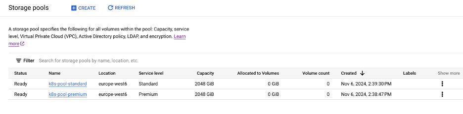

As an example, let's set up Trident to create volumes for our Kubernetes applications within the Google Cloud NetApp Volumes Standard and Premium storage pools, although Extreme and Flex Regional could be used as well.[Note: Flex zonal pools require Trident version 25.02 or later] The pools we will use need to be already configured in Google Cloud NetApp Volumes before the backend is created as shown below. Create a Storage Pool gives more information on creating storage pools in Google Cloud NetApp Volumes.

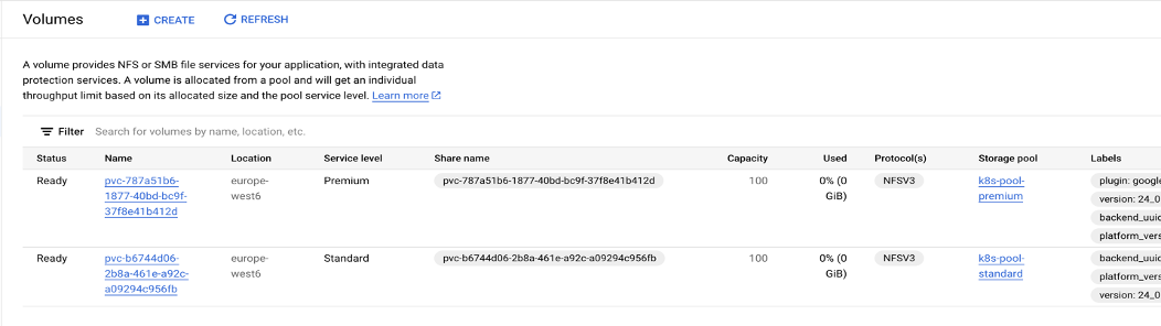

$kubectl get pvc NAME STATUS VOLUME CAPACITY ACCESS MODES STORAGECLASS AGE premium-pvc Bound pvc-787a51b6-1877-40bd-bc9f-37f8e41b412d 100Gi RWO gcnv-premium-k8s 9m3s standard-pvc Bound pvc-b6744d06-2b8a-461e-a92c-a09294c956fb 100Gi RWO gcnv-standard-k8s 11m |
The volumes in Google Cloud NetApp Volumes are shown.
