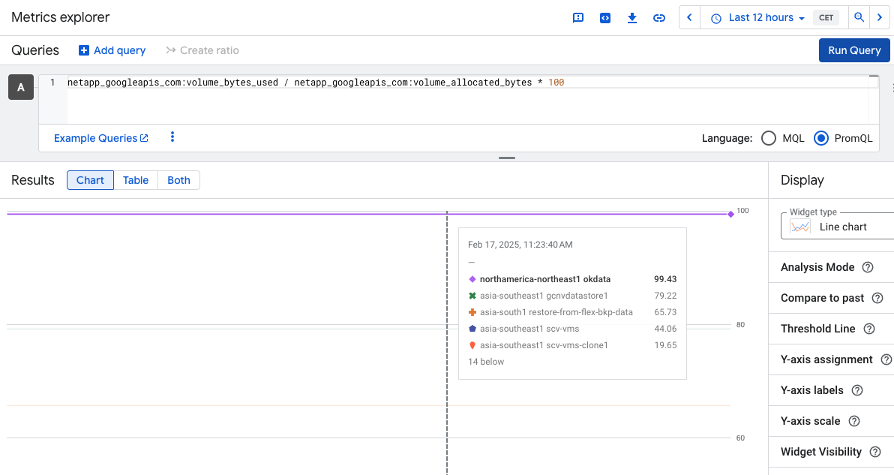

You can use Metrics Explorer to run this PromQL query. Here’s an example of a very static demo environment:
You can see that the volume “okdata” in region northamerica-northeast1 is close to full at 99.43% utilization. It’s time to increase the size of this volume.

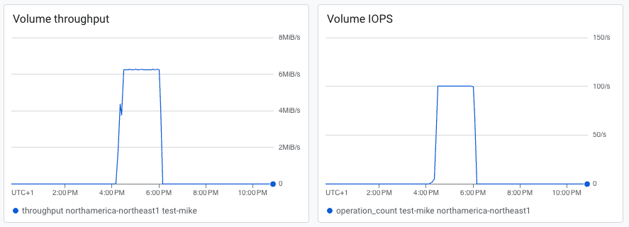

Typical performance charts show throughput, IOPS, and latency over time for monitored volumes. Charts with metrics are easy to create with Cloud Monitoring. Metrics get updated every 5 minutes. Throughput, IOPS, and latency numbers in Cloud Monitoring are the average of a 5-minute window. Here’s an example:

In the example Volume Throughput chart, the throughput hit a ceiling at 6.25MiB/s and IOPS are stuck at 100. We can easily tell that the applied workload is doing 6.25MiB/s * 1024 KiB/MiB / 100 1 IO/s = 64KiB sized I/O operations, which is considered large block I/O.
But why is it stuck at 6.25MiB/s and 100 IOPS? This is a 100GiB Premium volume. Its throughput is limited to 64KiB/s per GiB volume size, which translates to 100GiB * 64KiB/s/Gib = 6400KiB/s = 6.25MiB/s. It goes as fast as I defined it as the volume administrator. If I want to make it go faster, I have to increase its size or change its service level to Extreme. Or maybe this was only a short burst and it’s fine for it to go that slow in return for saving costs for more capacity or faster service levels. NetApp Volumes gives you the flexibility to size according to your needs and constraints.
