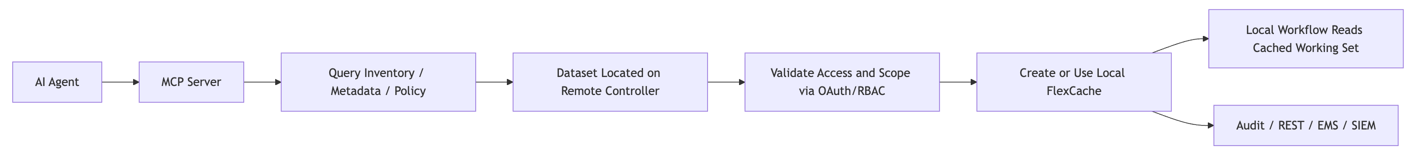

Example 2 — Remote data discovery and FlexCache
This is one of the most compelling AI-agent workflows in distributed environments: the agent discovers that the required dataset is on a different controller or cluster and uses FlexCache to make that dataset locally accessible without blindly copying the full dataset everywhere.
FlexCache stores hot data near the reader and fetches cold data from the origin on first access, making it highly effective for read-intensive AI and analytics workflows.
A clean workflow:
- The agent receives a request: "Use the latest governed dataset for this inference or training workflow."
- Through MCP, the agent checks inventory, metadata, or approved policy sources to determine where the origin dataset lives
- If the dataset is remote, the workflow validates access scope and policy first using OAuth and RBAC
- The MCP path creates or uses a local FlexCache relationship rather than an unmanaged bulk copy
- Local compute reads from the cached working set with improved performance
- The entire action remains visible through ONTAP audit logs, REST API logs, and EMS events
Why this matters: The agent did not just find the data; it brought the data closer to the workload through a governed, auditable, and policy-aware infrastructure path. No shadow copies. No unmanaged data sprawl. No blind replication.
Remote Data Discovery and FlexCache
