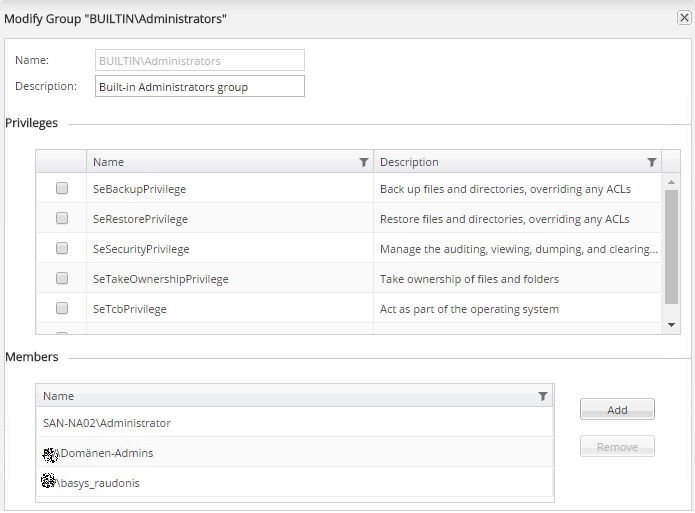

This is the local Administrators group:
My user, the Administrator of the CIFS SVM and the Domain Administrators are member.

So i got all AD Groups, but no local Groups. But there must be "BUILTIN\Users" and "BUILTIN\Administrators".
The main problem with this is, i can't access directory's that only grant access to the local Administrators group.
What goes wrong here? Have i missed something?
