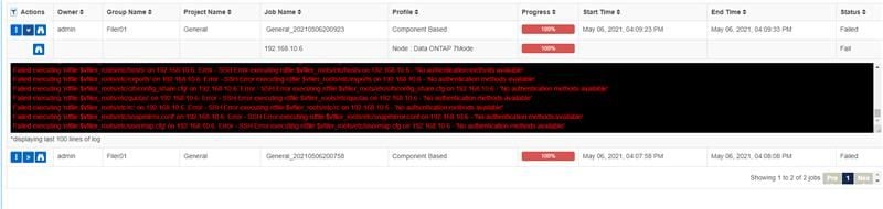

Here is a new image of the Onecollect tool error ( also image is attached) :
Its shows the following error:
Failed Executing rdfile..... SSH Error executing rdfile..... - No authentication methods available.

pedro_rocha
3,034 Views
"Failed Executing rdfile..... SSH Error executing rdfile..... - No authentication methods available."
This is just the tool trying to read config files from the 7-mode system. Since it was not able to authenticate, all the attempts will fail.
- try different user credentials;
- check tls
- check if there's any firewall between Onecollect and 7-mode system
ERSILVE
2,955 Views
Thanks Pedro, we use Admin user and it works... We were using root.
Regards!!
