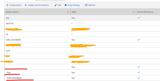

Hi everyone!
I recently migrated my first 7mode -> to Ontap 9.6, everything seems to be working fine except there are a couple of shares that appeared on the Ontap system that were not on the 7Mode filer. Do you guys have any idea as to why they are there? I think it may have to do with the user homedirectories but I am unsure and don't want to unshare because I don't want to mess the users home directories.
The shares in question are highlighted in red and have a "~".

These correlate to relative home directories for CIFS.
I'm not sure how they would have been seen in a 7-mode environment, but this is normal for a Clustered ONTAP system.
You can find additional information in defining these directories below:
https://library.netapp.com/ecmdocs/ECMP1196891/html/GUID-5991E6B3-FE3A-4606-AA09-1611DC3E3711.html
https://docs.netapp.com/ontap-9/index.jsp?topic=%2Fcom.netapp.doc.cdot-famg-cifs%2FGUID-D16B85B1-FE36-4F01-9C04-9E1E58E6834E.html

OK thanks, I will read the material hopefully it gives me an answer.
