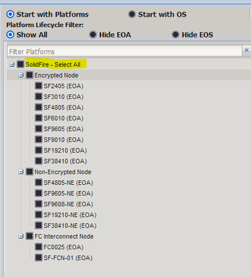

It seems the issue is that the switch is not Netapp Ontap OS compatible... it was designed
for Element OS

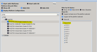

darr613
11,250 Views
 The 2750 was designed for Ontap and it's not compatible with the Mellanox MSN2010 switch

The Mellanox MSN2010 switch is compatible with the above hardware Element OS and the below hardware
darr613
11,250 Views
You can check for yourself in the ITM for compatibility for your switch
https://imt.netapp.com/matrix/#search
