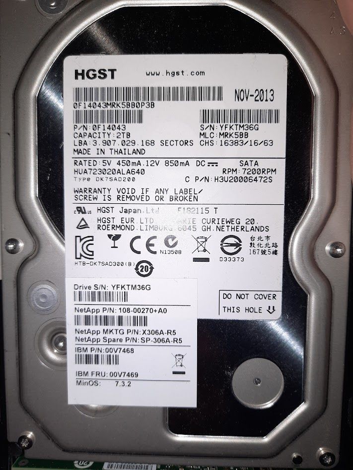

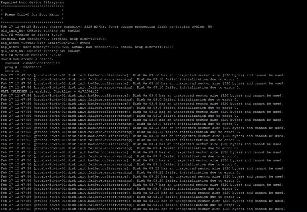

Please see this screenshot where controller says that have unexpected sector size drives. I am testing it with 512 blocks size and initializes properly. I have also attached some photos of the drives X306A-R5 you says taht should come with 520 block size but not at this case.
I have a tool to reformat drives to 520 blocksize but don't work with these drives.

No idea why is it not taking 520BCS, if you look up FAS8060 in HWU, you can see the disk model X306A-R5 which clearly says BCS. Is this system under NetApp support ?  Have you configured this system originally, has there been any changes done, in terms of hardware(disks format) etc .
I found this kb, take a look. Also, ensure the DQP is up-2-date on your Flier before adding any disks to the existing system.
