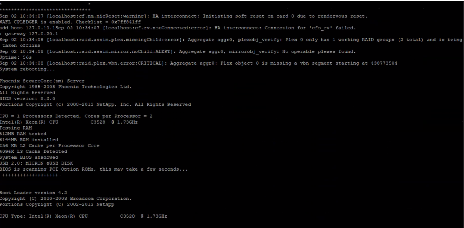

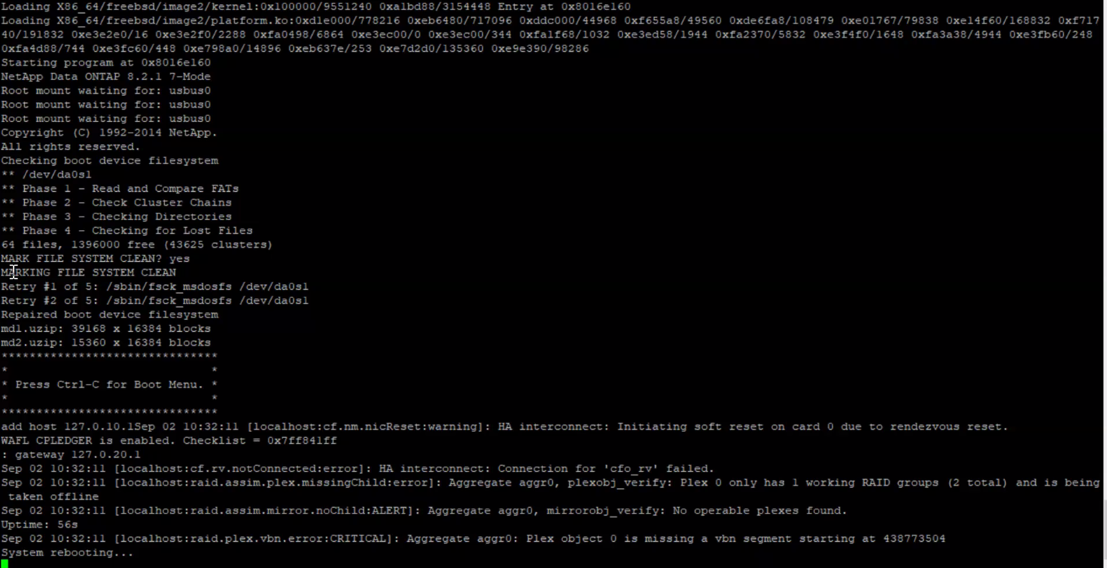

Hi NetApp Community,
I have a NetApp FAS2240 running Data Ontap 8.2 in 7-mode. We seem to have hit the following bug where the SSD disks have been up for 70,000 hours / 8 years. The SSD disks which were configured as the FlashPool have failed as the firmware was not updated.
https://mysupport.netapp.com/site/bugs-online/product/ONTAP/BURT/1335350
The failed SSD's have been replaced with reconditioned SSD disks from a 3rd party supplier, but we are getting plex errors.
Does anyone know how to resolve this issue ?

The aggregate is currently offline as one of the plex's has an error.
