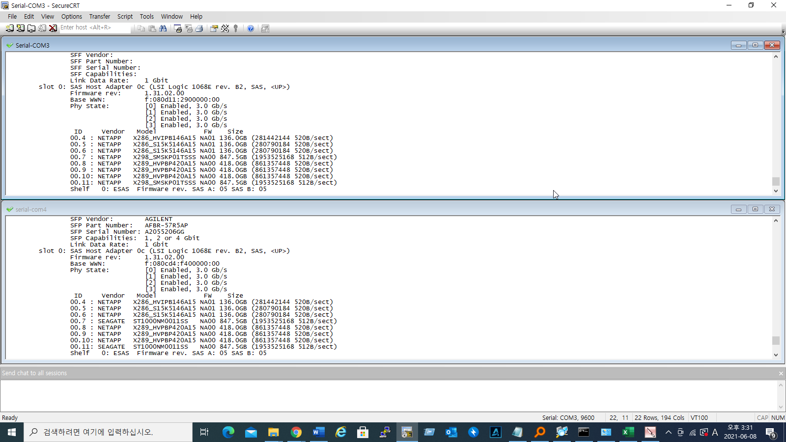

Hello
There is a problem with the FAS2020.
Controller A of the FAS2020 is 7.2.7P1 Version and controller B is 7.3.7P1 Version.
I inserted the disk for zeroing operation of the disk, but when entering 'sysconfig -v' in 7.2.7 Version, the disk vendor and model are displayed by manufacturer, not Netapp.
It is normally displayed in 7.3.7 Version.
The FAS2020 Disk Qualification Package is installed.
The script has also been executed with the command 'rdfile /etc/qual_device_v3'.
Please tell me how to make the disk display normally in 7.2.7 Version.
Thank you.

It is very likely that the current DQP on the NetApp Support Site has already purged the very old (EOS) drives.  You would almost need to find an "old" DQP drive from 3-4 years ago help with that specific drive string (you can see if the file includes an entry for it, now).  Your best bet would be get the node to 7.3.7Px.  You're not even in a supported configuration with the HA nodes being on completely different ONTAP versions.

However, the Disk Qualification Package (QDP) you mentioned has already been installed. All other disks display normally, but certain X298 disks display like that.
Some X298 disks do not look like that.
Is there any other way?

If any of you have a DQP file with 'X298_SMSKP01TSSS' item in it, I would appreciate it if you could send it by mail or direct message.
What I checked on Google is DQP with the Datecode 20110330'. The DQP contains 'X298_SMSKP01TSSS'.
