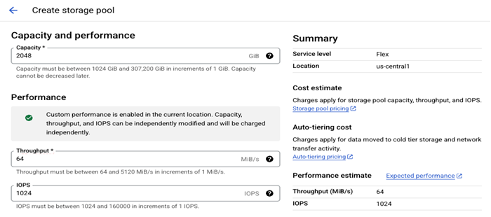

In Flex, performance is defined on the storage pool level, and all volumes share the pool's performance. With Flex custom performance, you can adjust the capacity and performance of a pool independently:

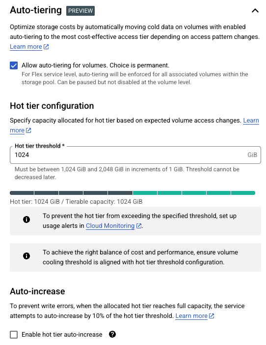

When using auto-tiering, you define pool size and hot tier size independently. The hot tier is charged at hot tier pricing, and the cold tier is charged for the amount of data stored in it.
If too much data is hot, you might have to increase the hot tier size or risk running into out-of-space errors. You can do that manually or enable auto-increase of the hot tier. Auto-increase can be enabled or disabled for the pool. If enabled, it grows the auto-tier by 10% as soon as the tier becomes full.
Maintaining an appropriately sized hot tier
In normal operation, the amount of hot data is determined by your active working set, which is the frequently changed data that should remain in the hot tier. A properly sized hot tier is large enough to hold the active working set with some margin.
There might be instances in which an unusually high amount of data is being written to a volume within the pool. For example, when you migrate data, all the data you write to a volume is considered hot. Because all of this data is new to the volume, NetApp Volumes cannot distinguish between actual hot data and data that hasn’t been touched for years, like old files or archived data. This could cause your hot tier to become full quickly or trigger an auto-increase, making the hot tier larger than necessary for normal operations.
For cases such as migration, Flex offers hot tier bypass. You can enable hot tier bypass on a per-volume level that tells the service to send all written data directly to the cold tier. Hot tier bypass helps avoid flooding or unintended auto-increase of the hot tier. After the migration is complete, you can switch hot tier bypass off, and normal operation resumes. Your workloads might experience reduced performance on the first data access until all active data is called back to the hot tier.
