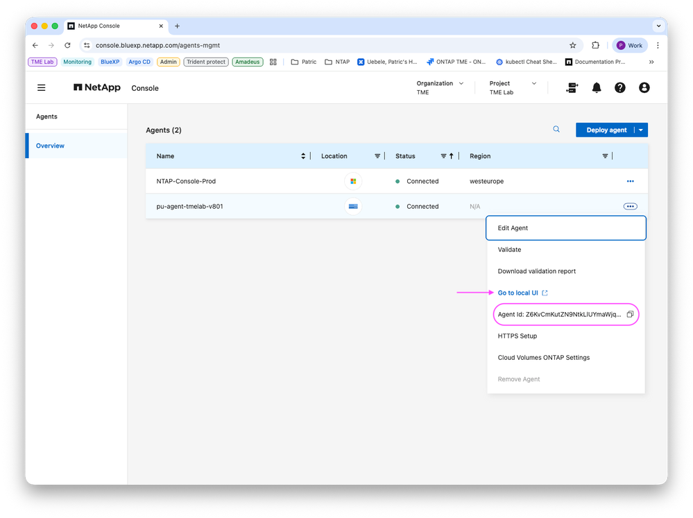

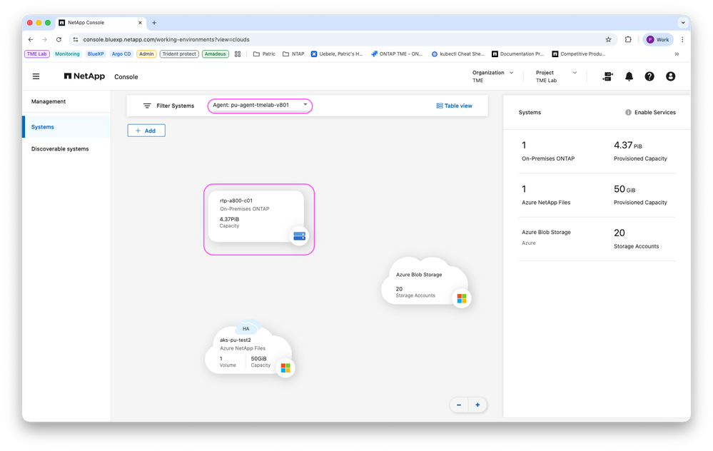

For the next steps, we need the Id and address of the Console agent connecting our environment to the NetApp Console. We can find them, e.g., from the Console’s Agent overview. Going to the local UI will show us the address of our Agent.

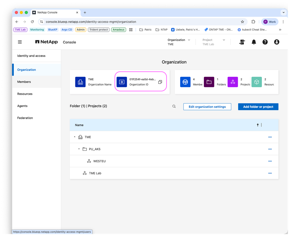

We also need the Account/Organization Id of our NetApp Console account, which we find in Administration -> Identity and Access -> Organization:

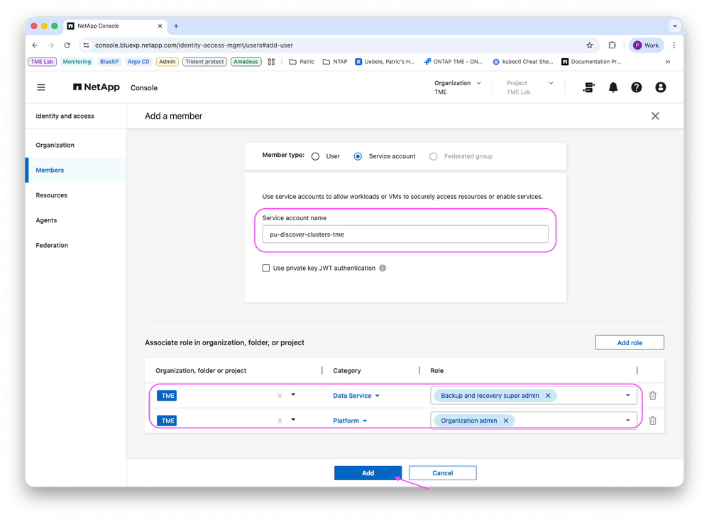

To communicate with Backup and Recovery’s API, we need to first create a Service Account with the necessary permissions. In the Console UI, go to Administration -> Identity and Access -> Members, select the Service accounts tab and select Add service account. We set the Service account name (pu-discover-clusters-tme in our example) and add the roles
“Data Service:Backup and recovery super admin” and “Platform:Organization admin” to the Service account.

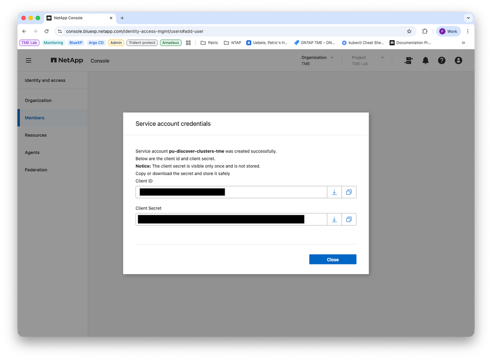

The Service account creation returns the credentials for the Service account, which we also save in environment variables.

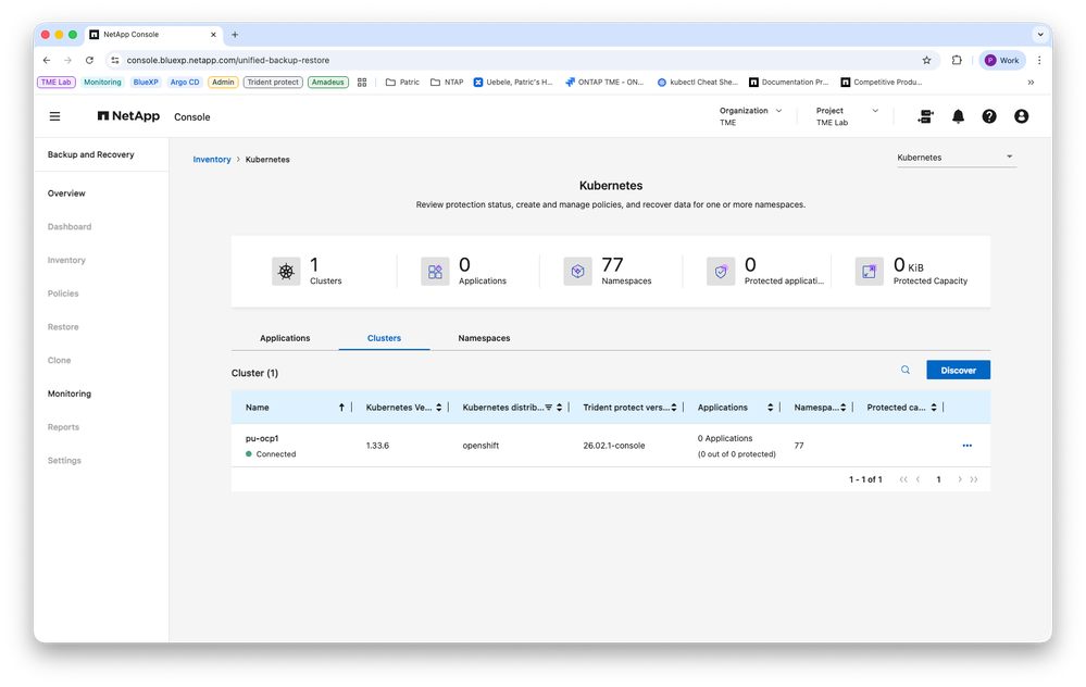

In the Backup and Recovery Inventory, the cluster pu-ocp1 is now listed in the Connected state:

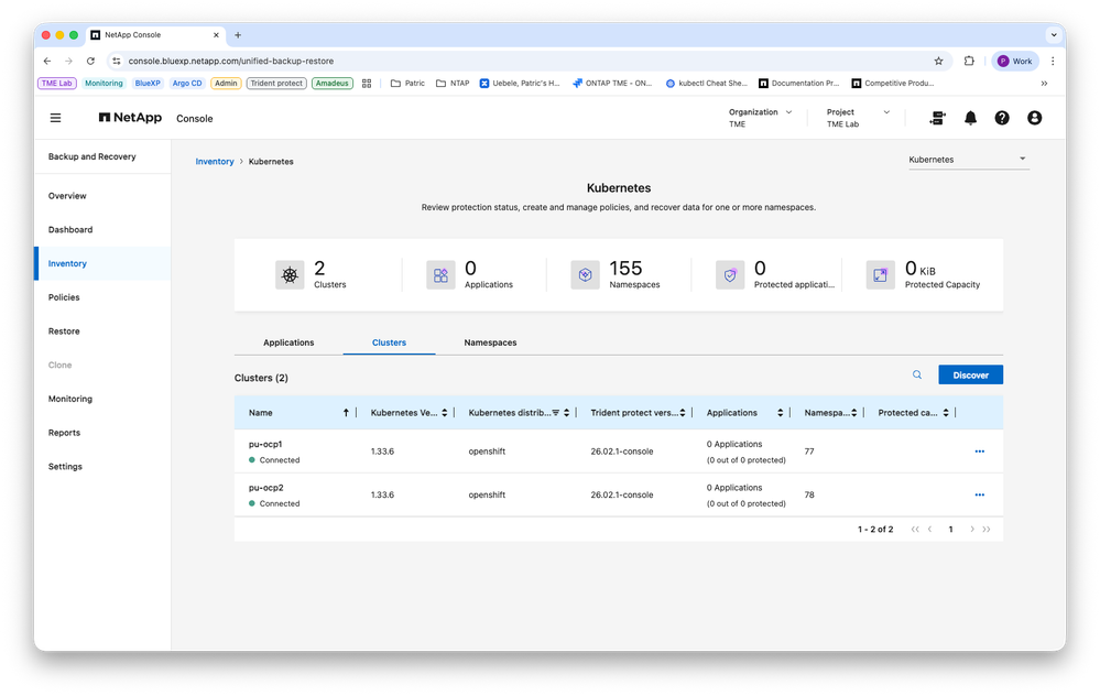

Once the installation finishes and the Trident protect pods are running, we see both clusters listed as connected in the Inventory:
$ curl -sS --location "https://api.bluexp.netapp.com/backup-recovery/organizations/$ACCOUNT_ID/v1/workloads/k8s/clusters" -H "x-agent-id: $AGENT_ID" -H "x-account-id: $ACCOUNT_ID" -H "Content-Type: application/json" -H "Authorization: Bearer $BEARER_TOKEN" | jq '.items[] | {id, name, state}'
  "id": "9c8c42a8-87f9-4a24-beb5-c0025c92b782",
  "name": "pu-ocp1",
  "state": "connected"
  "id": "70da163a-083a-4070-96d1-13ce5bf6098c",
  "name": "pu-ocp2",
