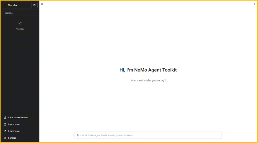

  • Launch the NeMo Agent Toolkit UI:
    Access the UI by navigating to the specified address in your web browser. The UI will connect to the running agent server.
 NeMo Agent Toolkit UI (Chatbot)

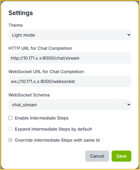

  • Updating NeMo Agent Toolkit UI Connection:
    After launching the UI, you'll need to update the connection URLs in the NeMo Agent Toolkit UI to enable proper communication with your agent. Navigate to the Setting option and update the HTTP and WebSocket URL to point to the host or system hosting your NeMo agent service from the default values.
     Updating NeMo Agent Toolkit Settings
