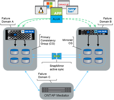

SnapMirror active sync, formerly known as SnapMirror Business Continuity, provides a business continuity solution for business-critical applications hosted on the ONTAP platform and data are synchronously replicated across the failure domain. SnapMirror active sync is easy to implement and provides flexibility for application-level granularity for automatic failover.
SnapMirror active sync uses SnapMirror synchronous replication technology along with consistency groups for dependent write-order consistency when there are multiple volumes involved. In the event of a site failure, SnapMirror active sync enables your application services to continue from a secondary replica with transparent failover. No manual intervention nor additional scripting is required in this process.
SnapMirror active sync feature can be integrated seamlessly with critical infrastructure services such as VMware vSphere, and enterprise databases such as Microsoft SQL Server and Oracle in both virtual and physical environments. SnapMirror active sync (formerly SnapMirror Business Continuity) is supported from ONTAP 9.8  and until ONTAP 9.13.1, it would work for the standalone setup of SQL Server but not for the SQL Server Always on Failover Cluster instance because of its limitation on SCSI-3 Persistent Reservation.

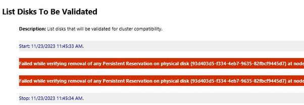

During the Microsoft Windows server failover cluster setup, you would run the cluster validation test to verify the storage support and SCSI commands that are required by clustering services. If SCSI-3 Persistent Reservation(PR) is not supported then you would run into the error as shown below --

ONTAP 9.14.1 adds support to SnapMirror active sync for SCSI-3 persistent reservation. With this capability, you can design disaster recovery for critical SQL Server database running on Windows server failover cluster setup. Here is the screenshot of the successful validation for SCSI-3 persistent reservation during the Windows server failover setup.
