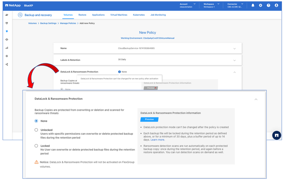

How do I enable DataLock and Ransomware Protection?
To enable DataLock and Ransomware Protection, we have to choose the mode as  “Unlocked” or "Locked" under the “DataLock and Ransomware Protection” section of the “Define Policy” UI of the “Activate Backup for Working Environment” wizard as shown below. If you choose the “Unlocked” mode, users with specific permission can overwrite or delete protected backup files during the retention period. However, for ”Locked” mode no users can overwrite or delete protected backup files during the retention period.
Important:-
  1. Make sure that the “DataLock and Ransomware Protection” is set while enabling the Cloud Backup service on the Working Environments.
  2. Please note that if you miss setting the “DataLock and Ransomware Protection” while enabling the Cloud Backup service on the Working Environments, you will not be able to enable the feature thereafter.
  3. DataLock protection mode  cannot be changed to normal after the policy is created.
  4. Disabling or modifying DataLock and Ransomware Protection feature is not possible.
When “DataLock and Ransomware Protection” is enabled, the Azure Blob that will be provisioned as a part of the backup activation process will have object locking  and object versioning enabled. It will also have Auto-purging of non-current versions on the bucket will be enabled and set to 1 day.
Creating Policies
In this section, we will discuss Cloud backup policy behavior when Cloud Backup is enabled with a Unlocked or Locked policy in the Working Environment.
  • If the policy used while enabling Cloud backup on the Working Environment is a Unlocked or Locked policy, you cannot create normal policies thereafter.
  • If the volume is assigned a Unlocked policy, it cannot be changed to a normal policy.
  • If the volume is assigned a Locked policy, it cannot be changed to a normal policy.
  • If the volume is assigned a normal policy, it cannot be changed to Unlocked or Locked policy as the DataLock and Ransomware Protection feature cannot be enabled on an already CBS-enabled Working Environment.
  • If the initial policy is a Unlocked policy, you can create different Unlocked policies and change the volume to a different Unlocked policy. Please note that you will not be able to create a Locked enabled Policy.
  • If the initial policy is a Locked policy, you can create a different Locked policy and change the volume to a different Locked policy. Please note that you will not be able to create a Unlocked enabled Policy

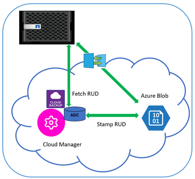

How do we set Retention Until Date (RUD) on the cloud backups?
  • Cloud Backup uses the snapshot list REST API in Active Data Connector (ADC) to determine all the snapshots that are yet to be locked based on the SnapMirror Policy.
  • For each of these snapshots, it uses ADC to stamp the RUD in all the objects belonging to the snapshot. This guarantees that the snapshot is locked until the RUD expires.

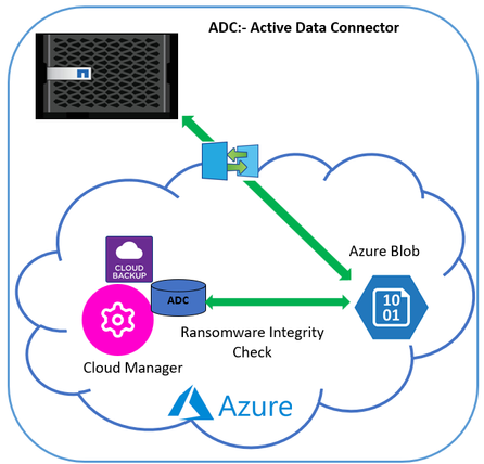

How does Ransomware Protection Work?
Ransomware Scan
In this section, we will examine how Ransomware detection scans are run by Cloud Backup. As soon as you enable Cloud Backup in the Working environment and configure "DataLock and Ransomware Protection," the ransomware scans are initiated. The Ransomware scans are run in the below-mentioned scenarios.
  • The scans on the cloud backup objects are initiated soon after they are transferred to the cloud object store. The scan is not performed on the backup file when it is first written to cloud storage, but when the next backup file is written
  • The Ransomware Scans can be initiated when the backup is selected for the restore process.
  • The scan can also be done on-demand as required by the user.
How does the scan work?
Now let's try to understand how the Ransomware scans work.
  • Before the Ransomware scans are initiated, Cloud Backup checks to make sure that the snapshot is stamped.
  • Cloud backup employs the Active Data Connector Integrity Checker REST API to start Ransomware scanning as necessary.
  • The detection of ransomware attacks is performed using checksum comparison.
  • The Active Data Connector Integrity Checker REST API triggers a Ransomware scan of the cloud backup objects on the cloud object store by verifying the checksum of the different backup object versions.
  • Based on the result of the scan Cloud Backup initiates the recovery process.
    Snapshots can be scanned on an on-demand basis for any ransomware attacks if necessary.
How does the Recovery process work?
When a Ransomware attack is detected, Cloud Backup uses the Active Data Connector Integrity Checker REST API to start the recovery process. The oldest version of the data objects is the source of truth and is made into the current version as part of the recovery process.
Let's see how this works:-
  • In the event of a ransomware attack, the Ransomware tries to overwrite/ delete the object in the bucket.
  • Since the Azure Blob storage are versioning-enabled it automatically creates a new version of the backup object. If an object is deleted with versioning turned on, it is only marked as deleted but is still retrievable. If an object is overwritten, previous versions are stored and marked.
  • When a Ransomware scan is initiated, the checksums are computed for both object versions and compared, If the checksums are inconsistent, potential ransomware has been detected.
  • The recovery process involves reverting to the last known good copy. V3 is created (duplication of V1)
