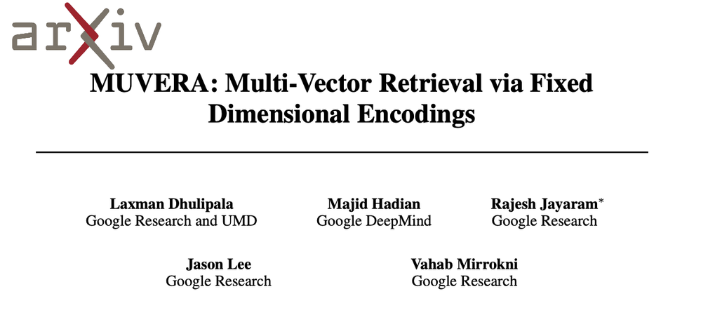

This is a well-known problem with vector embeddings, which also underlies how LLMs structure their internal data after training. Data scientists have been hard at work for over a year now, looking into other possible solutions to this data representation conundrum. One example of addressing this limitation is a research paper that is starting to explore the idea of multidimensional vector search. A high-level, beyond-simplistic explanation of this type of search is to consider multiple dimensions or a vector space to find the correct "match" or "fit" for a given vector or embedding. The theory is that this will yield better or more accurate answers to user prompts.

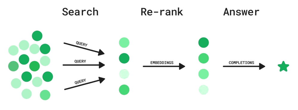

But how do these architectures win out in these categories over Vector-based RAG? These implementations address two fundamental concepts in the Retrieval portion of Retrieval Augmented Generation pipelines by providing flexibility at the cost of a user-provided implementation.
First, by taking control of the implementation details for the Retrieval step, you decide which documents to retrieve from the data store or database that houses the information. In a GraphRAG implementation, we call this retrieving a knowledge graph or a relevant subset of your dataset. You can retrieve as little or as much of the subset of data as needed. It could be a few documents or an entire book. You decide the "map" to find that data.
Second, you can rank the relevance of the paragraphs, chunks, documents, etc, retrieved to see which you want to deem most important in answering that question or ppl. If you had a crystal ball, a single document with the exact answer would be ideal, but in reality, it doesn't work that way. Luckily, in this architecture, you have control to help guide not only what is relevant, but also the importance of each item in your subset.
Not only is externalizing the Retrieval process better for correctness, but it also has the added benefit of being faaaaaar more explainable and observable in GraphRAG and DocumentRAG, which turns out to be way better for AI governance and trust.
