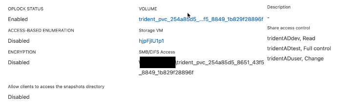

Sample output of SMB share
  • Once the PVC is created, Trident creates an SMB volume in ONTAP with a new SMB share, where the user with the specified permissions is added to the access control lists, as shown in the following image.
  • The default share ACL Everyone/Full Control is removed when secure SMB is enabled, because it poses a security risk.
